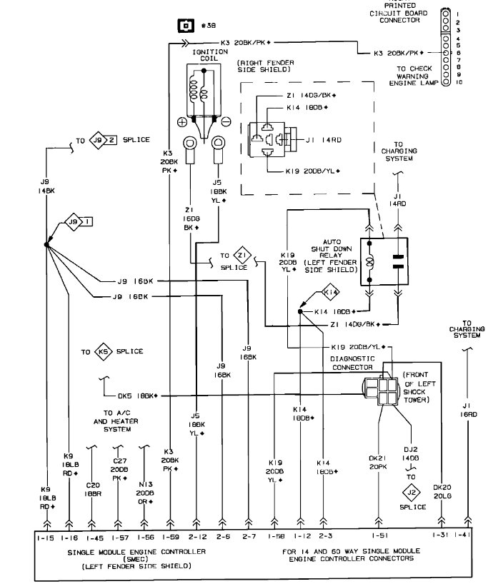

Car just shut off, and didn't hear the fuel pump coming on, so I replaced the fuel pump relay. still no fuel pump. So, I ran a wire from 12-volt from battery to positive terminal on coil pump comes on and car starts but as soon as I take the 12 volts away car shuts off. now it won't start at all. So, on the relay there's power on the big red wire turn the key on power to smaller blue wire, but not the other small blue wire but touch the test light to the wire with no power. the fuel pump comes on, the test light is dim. The cooling fan comes on when I touch the same wire. I need help.

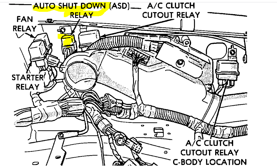

Which relay are you referring to? If the fuel pump is turning on when you touch one of the wires with a tester, it sounds like there is a bad ground and you are providing it with the tester.
Is it the automatic shutdown relay (ASD) you are referring to? Let me know. I'm trying to look through wiring schematics, but they are extremely limited because of the model year. However, based on your description, it sounds like the ASD relay is faulty or the ECM isn't providing a ground path to actuate the relay.
Nov 27, 2023 at 1:10 PM
JERRY ULLOA
  • 36 POSTS
It said it is fuel pump relay in one of the diagrams on this site it's the only black plastic relay the other 3 are metal relay.
Nov 27, 2023 at 1:23 PM
  • 110,244 POSTS
I attached a pic below showing the location. Let me know if that is what you are referring to.
Also, I have the same vehicle. LOL I ordered it in 1987. I wanted a convertible. It now has 9,000 miles on it. LOL
See pic below.
Nov 27, 2023 at 1:35 PM
JERRY ULLOA
  • 36 POSTS
Yes.
Nov 27, 2023 at 1:57 PM
JERRY ULLOA
  • 36 POSTS
Yes, that's the relay I changed.

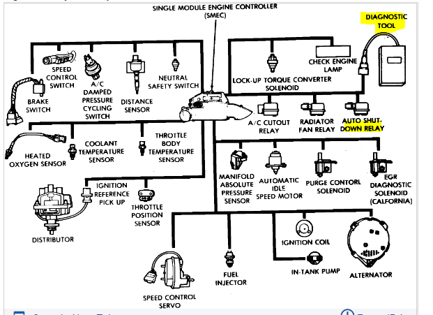

Is it possible for you to take a pic of the connector you are referring to and upload it for me to see it?
Also, try to see if there are diagnostic codes. Here is a link that explains how to retrieve them. You don't need any tools.
https://www.2carpros.com/articles/retrieve-trouble-codes-for-chrysler-dodge-plymouth-odb1-1995-and-earlier-car-mini-van-and-light-trucks
As far as a test connector, there should be one near the ASD. See pic below.
See pic below.

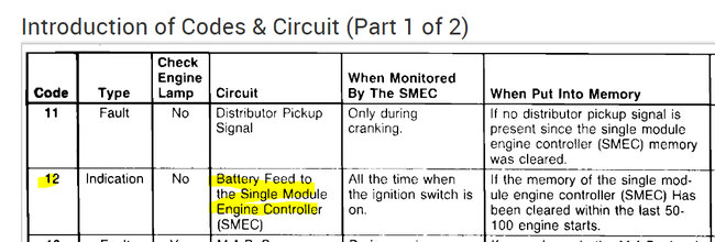

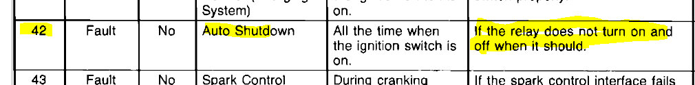

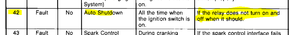

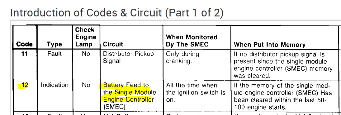

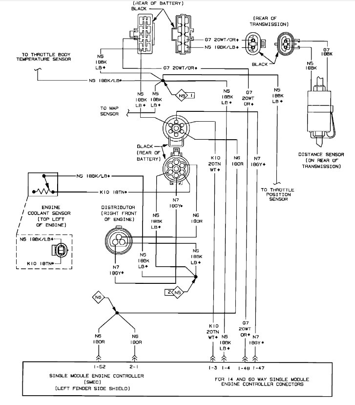

So, I did the diagnostic on my car and came up two codes 12 and 42.
Nov 30, 2023 at 8:06 AM
  • 110,244 POSTS

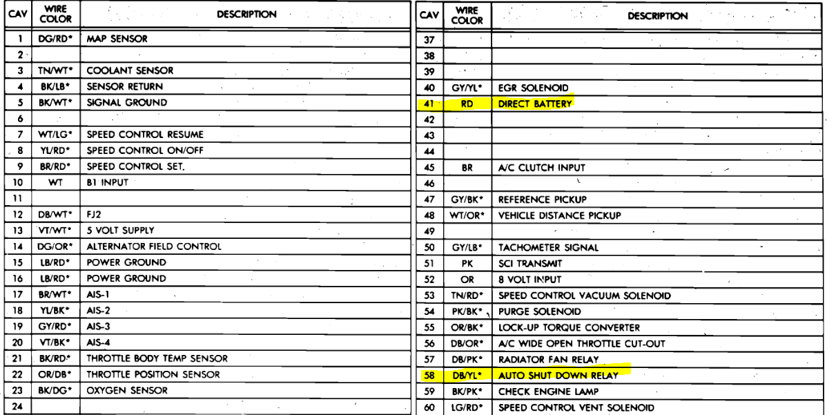

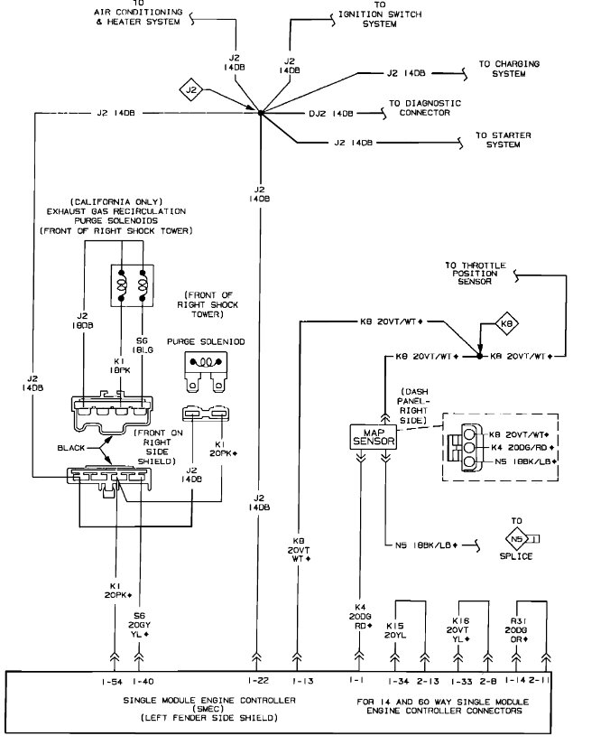

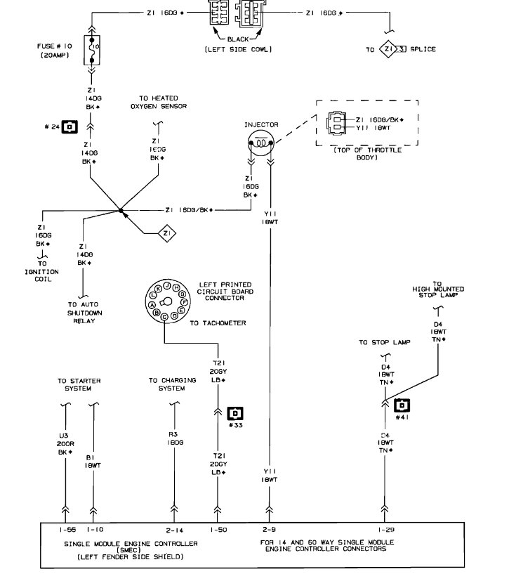

Okay, the two are tied together. Code 12 is related to the single module engine controller (SMEC) and the 42 is related to the automatic shutdown (ASD). (see pics 1 and 2 below).

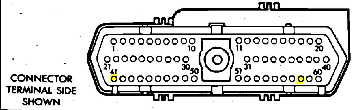

What I need you to do is remove the 60-way engine controller connector, check pin 41 for power, and check if pin 58 provides a ground path when the key is turned on.
Pics 3 and 4 show the pin legend and the connector pinout. I highlighted the pins that need to be checked. Also, make sure they are not damaged, corroded, or bent.
See pics below. Note: The SMEC is behind the battery and has an air cleaner duct connected to it.
Nov 30, 2023 at 11:11 AM
JERRY ULLOA
  • 36 POSTS
So, I tested the pins and there's power in 41but pin 58 comes on when I ground it with test light.

I need you to check pin 58 with the relay removed to determine if a ground path is being provided by the module or if you are just getting a ground path because the relay is then sending power to the pump.
If I recall, the relay is new, correct? If that is the case and the pump turns on only when you send power to pin 58 with the relay removed, the module sounds like it has failed internally.
Dec 4, 2023 at 10:51 AM
JERRY ULLOA
  • 36 POSTS
Okay, so, I unplugged the relay put the alligator clip on the pos side of the battery and key on probed pin 58 nothing happens, then put the relay back on then probed pin 58 fuel pump comes on but no start.
Dec 14, 2023 at 5:33 AM
  • 110,244 POSTS
It sounds like the ECM isn't providing the ground path you need to complete the circuit. When you reinstall the relay and apply power, it is actuating the relay and sending power.
I suspect the ECM is faulty. You should get a ground when the key is first turned on to prime the pump. If that isn't present, then either the ECM is faulty, or the wiring is open.

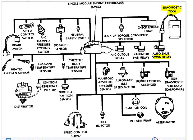

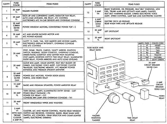

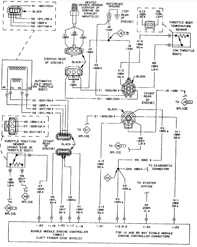

Let's go back to basics, please turn the ignition switch on and check all of the fuses, also while the switch is on check the positive side of the coil for power.
This guide can help:
Here are the engine and computer wiring diagrams so we can be on the same page and be able to see how the system works. Check out the images (below). Please upload pictures or videos in your response to the problem so we can see what's going on.
Jan 24, 2024 at 2:00 AM
JERRY ULLOA
  • 36 POSTS
Okay, so, now I got code 42 & 45 when I first got codes it was 12 , and 42.
Jan 27, 2024 at 6:17 AM
  • 55,433 POSTS
Code 42 - Auto Shutdown Relay Control Circuit: This code indicates a problem in the auto shutdown (ASD) relay circuit.
Code 45 - Turbo Boost Limit Exceeded (Chrysler vehicles with turbocharged engines)
Did you check the fuses and swap out the ASD relay?
Jan 28, 2024 at 3:03 AM

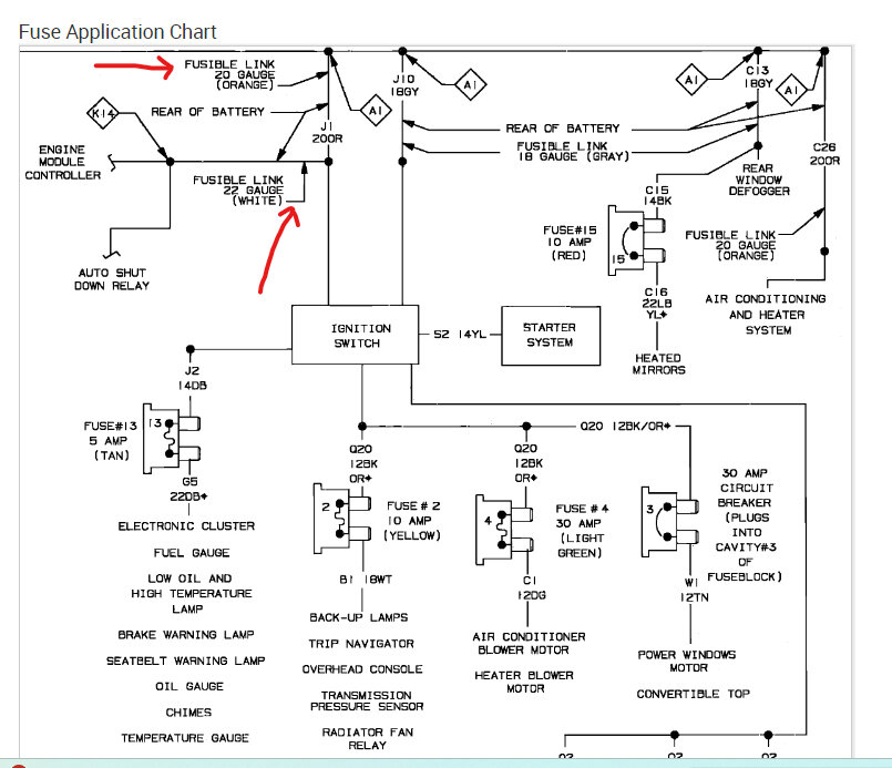

Jan 28, 2024 at 5:48 AM
  • 55,433 POSTS
There are fusible links near the battery, pull on them to see if they are connected. These are wires that burn up inside, you will need to replace them. Check out the images (below). Let us know how it goes.

So, I turned on the ignition no power at the coil.
Feb 2, 2024 at 6:23 AM
  • 55,433 POSTS
The power to the coil comes from the auto shutdown relay, did you replace it? If so, I would swap out the ignition switch. Also, check the fusible links by the battery.
