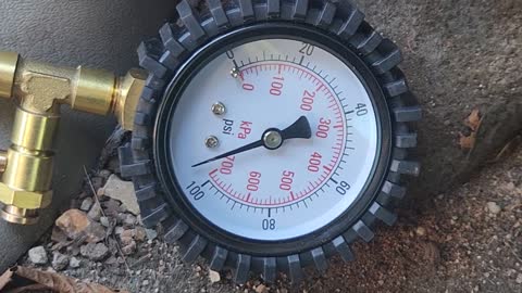

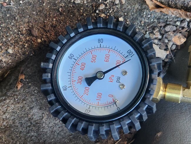

JEFF HERMAN
  • 486 POSTS

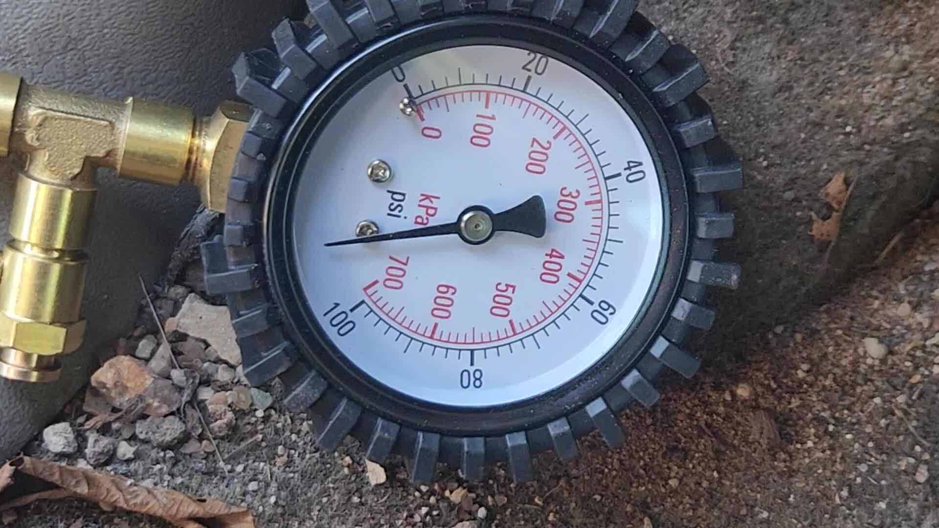

The pressure directly off the pump is over 100 pounds. Here are some pictures and a video. I believe it falls off was my fitting was leaking.
Nov 25, 2022 at 2:12 AM
SQM
  • 6,383 POSTS
Right the pressure from the pump would be higher than what it supposed to be, that is why the regulator brings it to the correct pressure.
So if the pressure is stable at the pump the regulator could be the culprit.

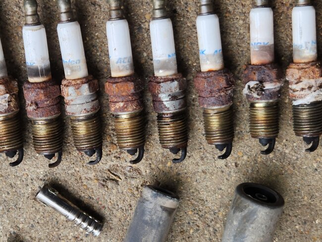

JEFF HERMAN
  • 486 POSTS
Engine did not fire. Proceeded to remove plugs. All 8 black, several were wet. Not sure gas or oil. Hoping gas. Majority of wires broke off connectors even when leveraging on boot or heat shield. Haven't tested spray or no spray from injectors. 20 degrees today. Is it necessary to use the heat shields?
Dec 3, 2022 at 8:57 AM

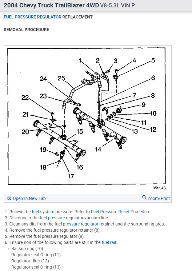

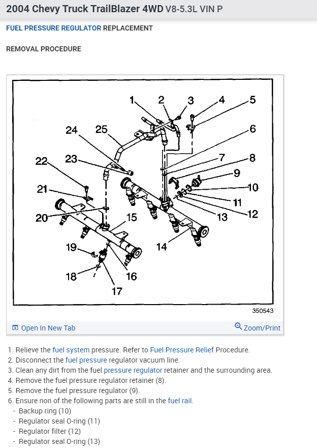

  • 110,248 POSTS
Wow, the plugs aren't in good shape. As far as the ones that were wet, chances are it was fuel. Which wires were broken? Was it the wiring to the injectors?
I just went back through your conversations. The idea that the fuel pressure reached specification and then dropped before it stabilized leads me to think you have injectors leaking or a faulty fuel pressure regulator. If you remove the vacuum hose from the regulator, is there any evidence of fuel in the vacuum hose?
Also, yes, reinstall the heat shield or you could end up with a hydrostatic lock in the fuel system.
Let me know what I can do to help.
Dec 3, 2022 at 1:01 PM

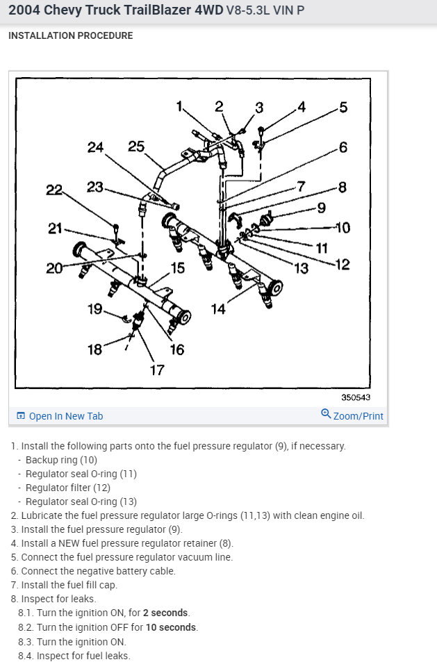

JEFF HERMAN
  • 486 POSTS
Spark plug leads to torn off connectors when removing. No other wires are broken. Regulator was bad, put a used one in from a running engine. Falloff may have been due to gauge connection, was seeping fuel. No fuel in vacuum line. Old regulator only gave 30 psi at the rail. Will be replacing plugs, wires. Also, will check injectors and clean them. Weather depending.
Dec 3, 2022 at 1:18 PM

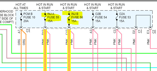

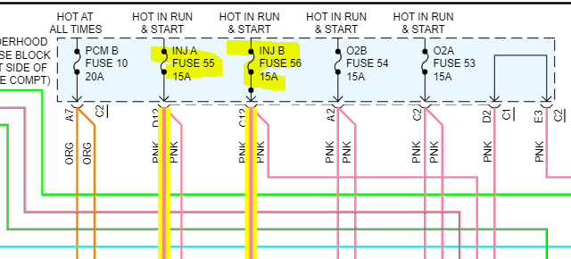

That makes sense. If you have fuel pressure and you have spark, then it is likely the injectors are not getting power or there is no ground path for them.

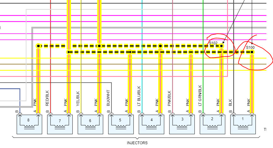

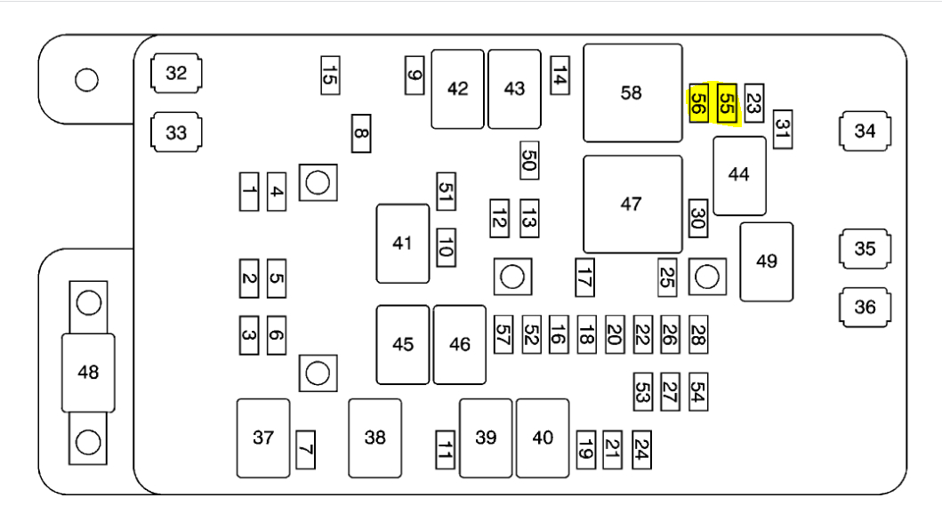

Each injector will have a pink wire to it. See pic 2. With the key on, each injector should have 12v at the pink wires. Confirm that. If there is no power, check fuses 55 and 56 in the under-hood fuse box. See pic 1 below.
Also, note there are two splices that may need to be checked. I circled them in pic 2.
If they do have power, here is what I need you to do. Disconnect one at a time. In addition to the pink B+ wire will be one that is a different color at each injector.
Take a test light and clamp the alligator clip of the light to the battery positive. Probe the different color wire at the injector connector and have someone crank the engine. The test light should flash on and off. If that happens, that indicates the PCM is providing a ground path to the injector. At that point, I would remove the injectors and inspect them for operation.
If the light doesn't flash, the PCM or connector/wiring to the PCM is suspect.
