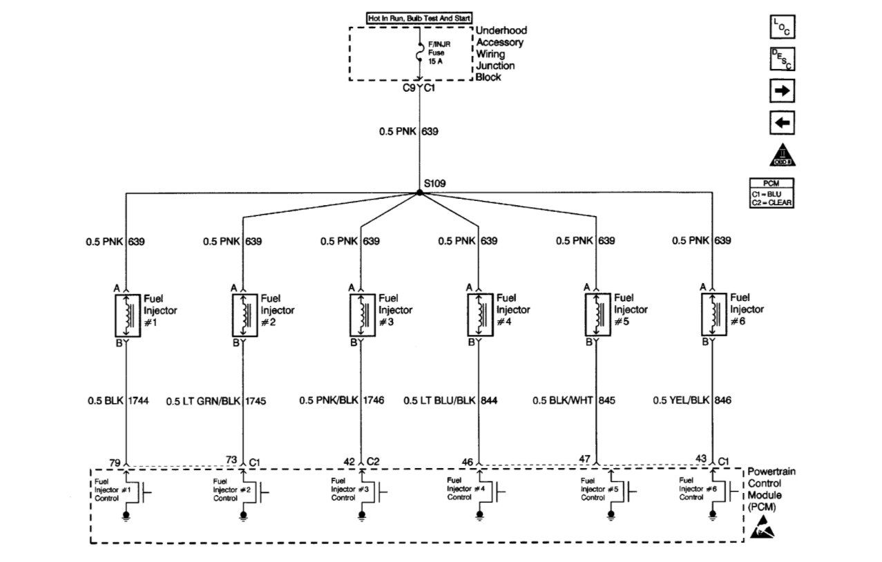

I would try some starting fluid in the air filter and see if it starts and stalls. That will tell me if it is a fuel delivery issue.
https://www.2carpros.com/articles/how-to-test-a-fuel-injector
You can remove the connector for a fuel injector and out a test light in series and crank the engine. See if the light flashes. If it does, the ECM is commanding the injectors on. If it is not, then the ECM quad drivers may be no good.

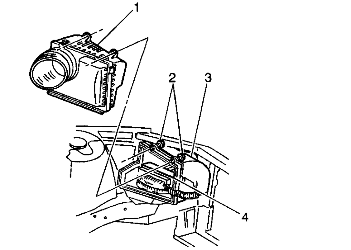

Service of the PCM should normally consist of either replacement of the PCM or EEPROM programming. If the diagnostic procedures call for PCM Replacement, check the PCM first to see if it is the correct part. If the PCM is faulty, remove it and install the new service PCM.
The new service PCM will not be programmed. You must program the new PCM. DTC P0602 indicates the EEPROM is not programmed or has malfunctioned.
Notice: In order to prevent possible electrostatic discharge damage to the PCM, do not touch the connector pins or soldered components on the circuit board.
Notice: Turn the ignition OFF when installing or removing the PCM connectors and disconnecting or reconnecting the power to the PCM (battery cable, PCM pigtail, PCM fuse, jumper cables, etc.) in order to prevent internal PCM damage.
Important: When replacing the production PCM with a service PCM (controller), it is important to transfer the broadcast code and production PCM number to the service PCM label. Do not record on PCM cover. This will allow positive identification of PCM parts throughout the service life of the vehicle.
Removal Procedure
1. Disconnect the negative battery.
2. Disconnect the IAT sensor electrical connector.
3. Remove the 3 bolts from the inner fender brace and remove the brace.
4. Loosen the clamp securing the air intake duct to the air cleaner housing.
5. Carefully remove the air intake duct from the throttle body and air cleaner housing (1).
6. Remove the 2 screws (2) from the 2 air cleaner housing sections.
7. Remove the air cleaner housing cover assembly (1).
8. Without disconnecting the PCM connectors, remove the PCM and harness from the PCM housing.
9. Disconnect the PCM connectors.
Installation Procedure
1. Reconnect the PCM connectors.
2. Carefully reinstall the PCM and harness into the PCM housing (3).
3. Reinstall the air cleaner housing cover assembly (1).
4. Reinstall the 2 screws (2) from the 2 air cleaner housing sections.
5. Carefully reinstall the air intake duct to the throttle body and air cleaner housing (1).
6. Tighten the clamp securing the air intake duct to the air cleaner housing.
7. Position the inner fender brace and reinstall the 3 bolts.

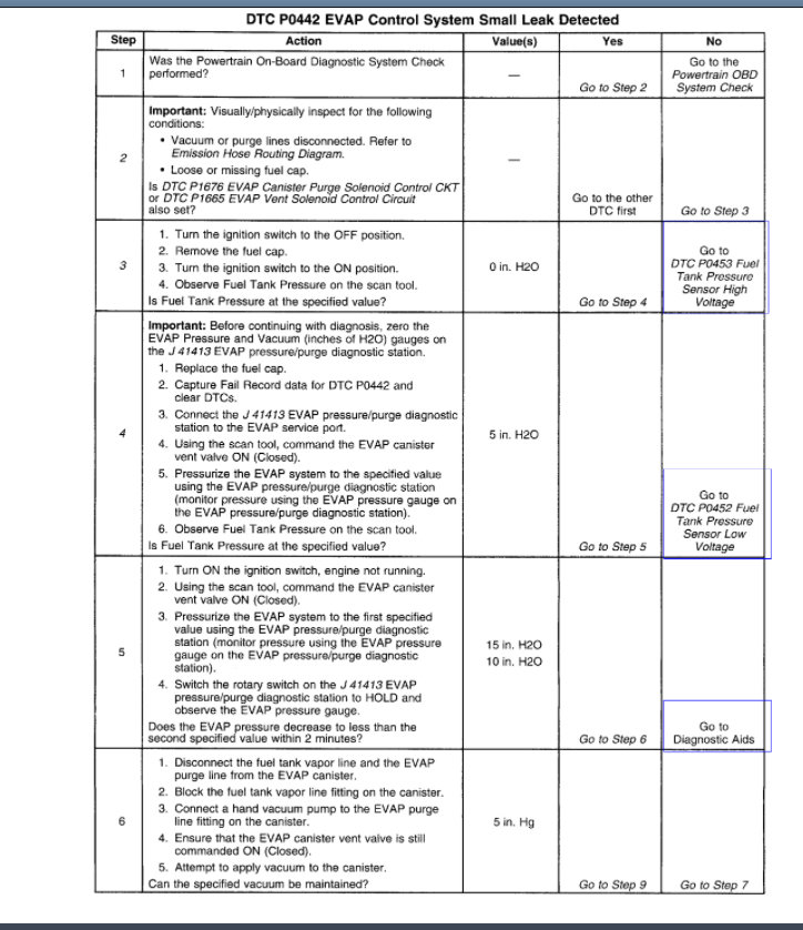

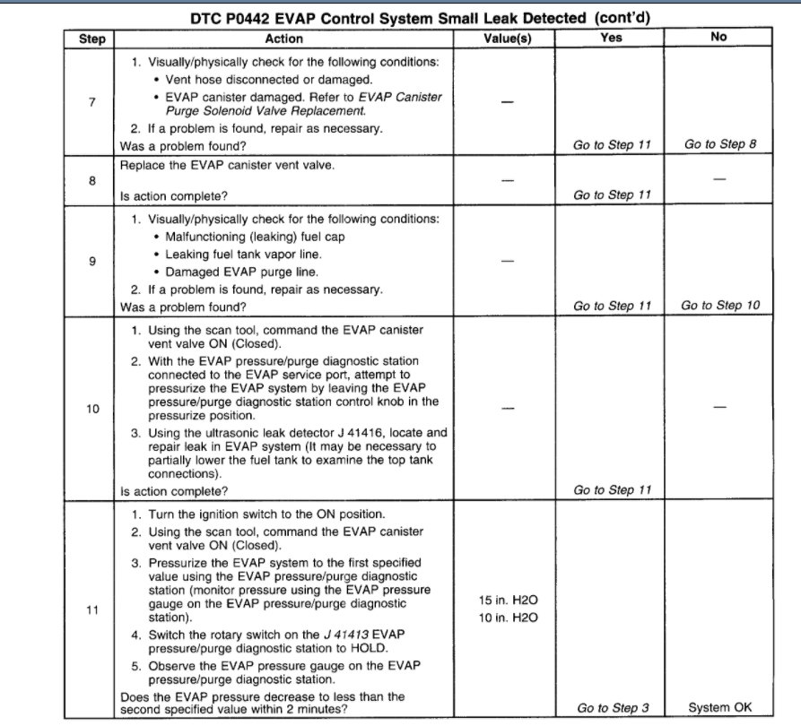

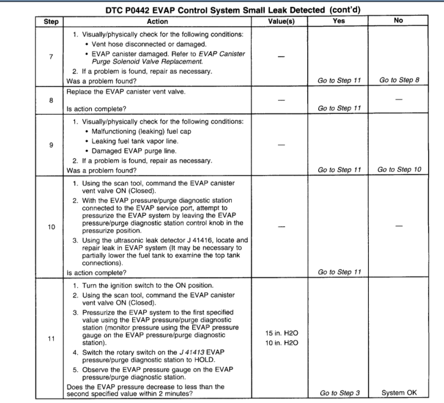

Okay, there is no relearn. What is happening is the car will test the evap system and if it passes, the light will stay out.
https://www.2carpros.com/articles/how-emission-control-systems-work
If the repair was not successful, the light will return.
https://www.2carpros.com/articles/smog-test-inspection-information
I attached the flow chart for the code for you to review.
Let me know if you have any questions.

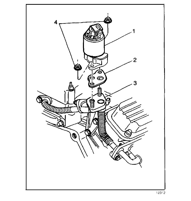

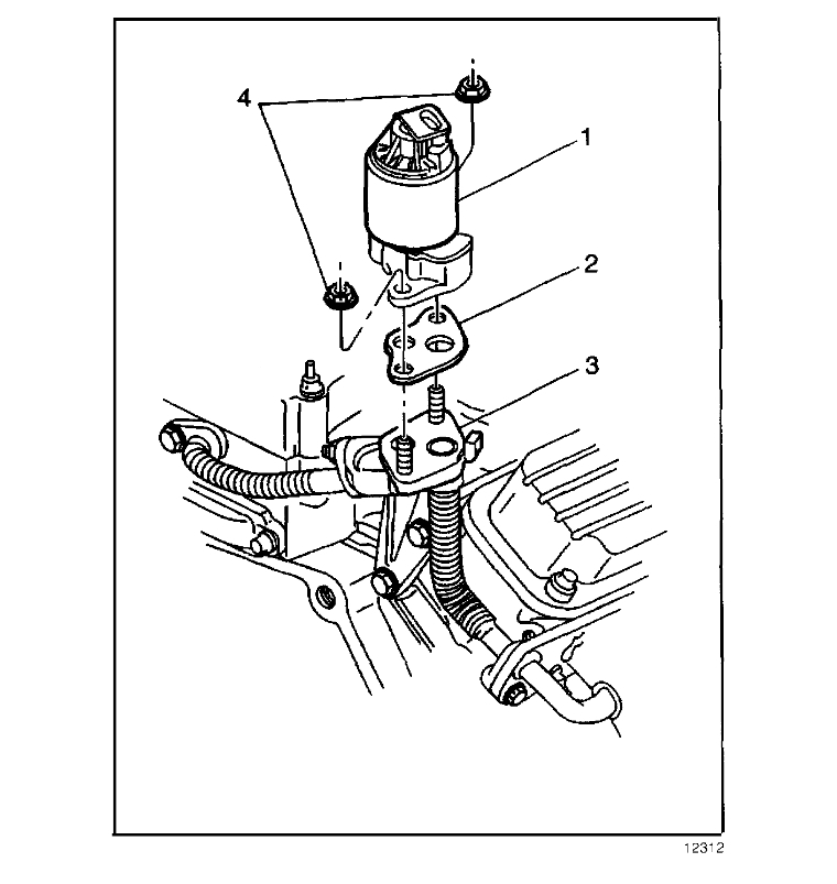

Disconnect the EGR valve and see if it stumbles when starting. If it is partially open, it will give you a vacuum leak and it will run rough.
Nov 5, 2020 at 8:46 AM
DOUG_IRE
  • 38 POSTS
update: i did an intake fog with seafoam then checked vacuum hoses. yes Roy, I disconnected the EGR. It cranked and didn't start. removed and cleaned EGR, then it started and ran beautiful. no stumbling. 2 days later (today) went to start it (reached in with the key), it barely started after winding over 5 or 6 times. coughed, stumbled. I revved it up a few times and it cleared out ran fine.
Nov 30, 2020 at 4:29 AM
Okay, when you removed the EGR, was there carbon on the bottom holding the valve open?
Nov 30, 2020 at 4:40 AM
DOUG_IRE
  • 38 POSTS
there was a carbon buildup and would stick when depressed.
Nov 30, 2020 at 5:20 AM
If that sticks open, it creates a massive vacuum leak which will cause the delayed start and the engine running rough.
Nov 30, 2020 at 5:23 AM
DOUG_IRE
  • 38 POSTS
I cleaned and freed up the EGR. it does not stick now.
Nov 30, 2020 at 5:27 AM
Okay, do you still have the issue?

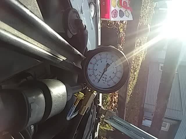

Today I went to start it (reached in with the key), it barely started after winding over 5 or 6 times. Coughed, stumbled. I revved it up a few times and it cleared out ran fine. it did have a random misfire and is still having issues.
Nov 30, 2020 at 6:58 AM
Can you tell me the fuel pressure as I suggested?
Nov 30, 2020 at 7:01 AM
DOUG_IRE
  • 38 POSTS
I rented the tool the last time it was doing this. I do not have the fuel pressure test gauge.
Nov 30, 2020 at 8:06 AM
Okay, let me know the results.
Nov 30, 2020 at 8:26 AM
DOUG_IRE
  • 38 POSTS
might be a while for that the other vehicle is down too.
Nov 30, 2020 at 10:18 AM
No problem. We will be here.
Nov 30, 2020 at 6:03 PM
DOUG_IRE
  • 38 POSTS

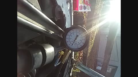

I bought a fuel pressure tester. while key on it is 50 then when the pump stops it drops to 42 in video, holds 42 for 5 minutes but no start today. Or the whole problem could be the catalytic convertor, lol .
Dec 7, 2020 at 5:21 AM
Okay, fuel pressure is good.
Pressure
48 - 55 psi
Unbolt the head pipe from the exhaust manifold and see if it starts easily. If it is a clogged catalytic converter, it will start right up.

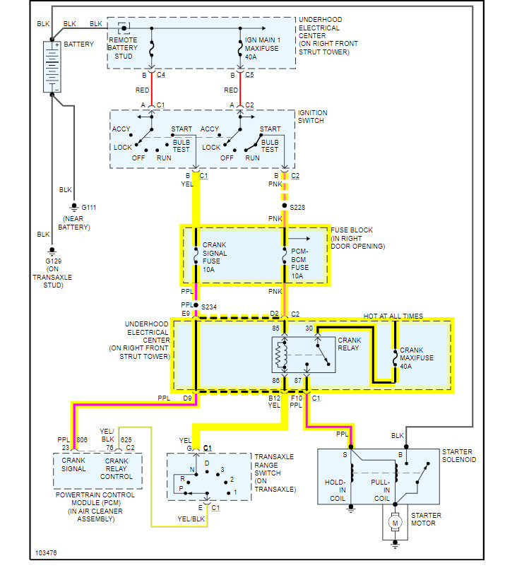

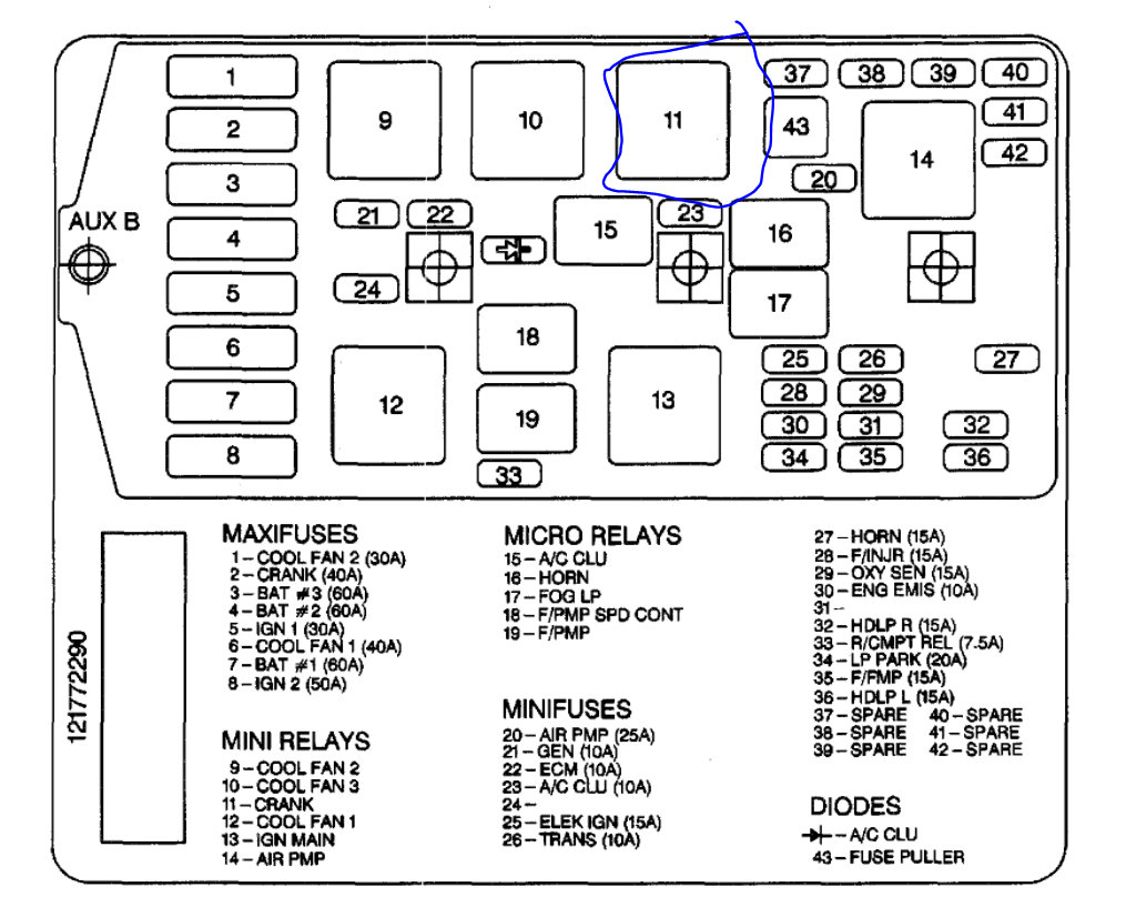

So again I have a crank no start situation. The video shows it "trying" to start with audio. I have to get this fixed ASAP. the bitter cold is about to drop on me. Normally this time of year there's 2-3 feet of snow and 20 degree temperatures.
Dec 7, 2020 at 7:02 AM

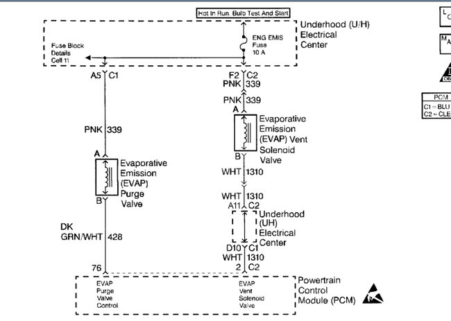

Okay, I attached the wiring diagram for the starting system.
We need to do some testing at the crank relay with a voltmeter.
Let me know when you are ready.
Dec 7, 2020 at 7:17 AM

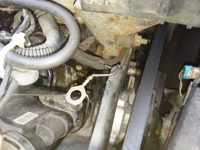

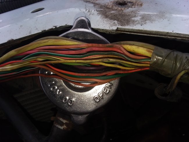

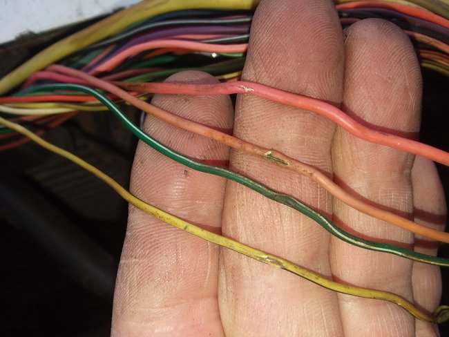

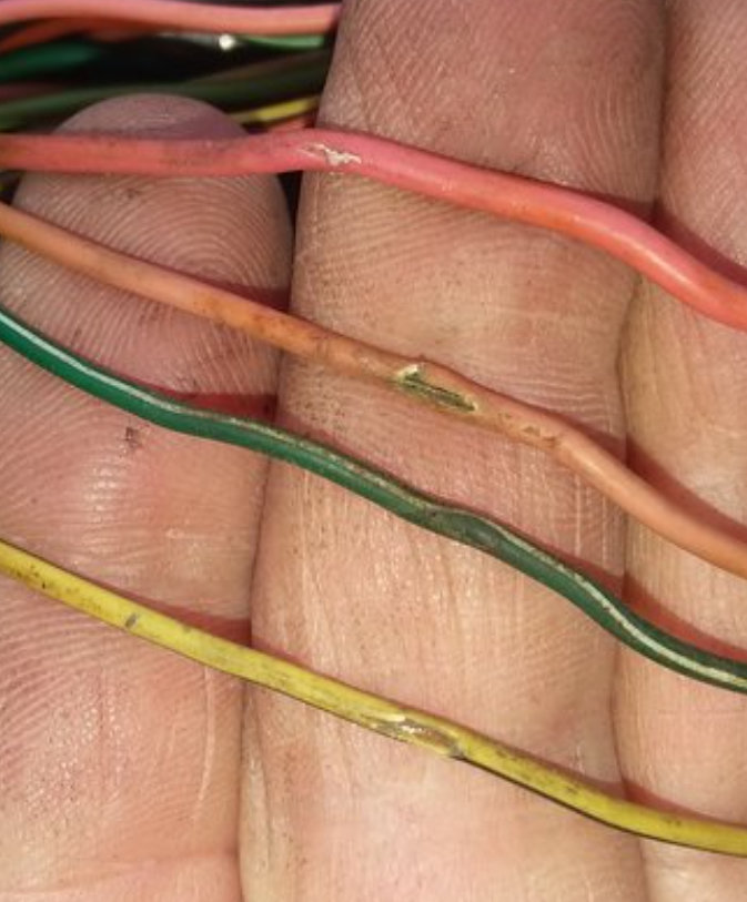

continued tracing the wire harness and found 7 total grounds and one that i think is a ground and was unattached tucked under the water pump bracket. Pic 1. Negative battery terminal bolt had rust on the threads. After reading another post here about the harness that goes under the battery, I took that apart and it looked good until I got to where it sneaks around the back side of the radiator fill neck. 4 cut wires from the rad cap. I plan on cutting out and soldering new wire. I will also dig up a wiring diagram to make sure that disconnected wire was a ground before reconnecting the battery. As an extra added bonus, since the inspection expired they would not let me renew the registration.
Jan 26, 2021 at 1:29 AM
Where did the cut wires end up?
Can you post the picture of the cut wires?
Jan 26, 2021 at 1:41 AM
DOUG_IRE
  • 38 POSTS
The insulation was cut by the radiator cap. (click the pics to enlarge) Possibly making an electrical connection with the cap. The harness tucks between the radiator and radiator support. Wrapped with dry rotted electrical tape (no wire loom).
Jan 26, 2021 at 3:09 AM
I would cut out the corroded wires and replace them with new wires. Solder and shrink wrap the connections.

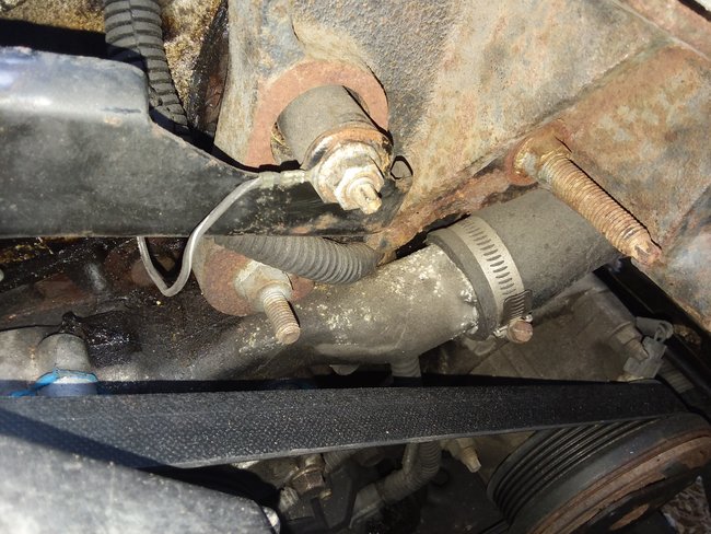

The wire shown here is a ground? I found it tucked under the bracket not attached to anything. Black with white stripe. It comes out of the harness with fuel injectors. When i dig through my nuts i'll relocate it to a stud.
Jan 27, 2021 at 12:11 AM
Correct. It is a ground.
