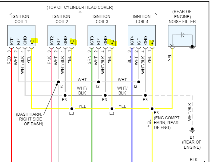

I have tested the coils they are not sparking all four of them, and I have changed the crankshaft sensor.
Aug 24, 2022 at 7:24 AM
  • 110,248 POSTS
Next, at each ignition coil connector, there will be a yellow wire. Check each one for power with the key in the run position. If each one shows power, check the white wire with a black tracer for continuity to ground.

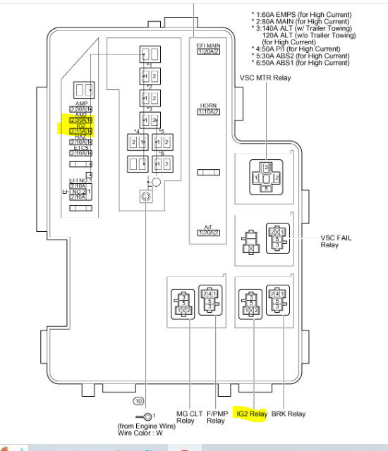

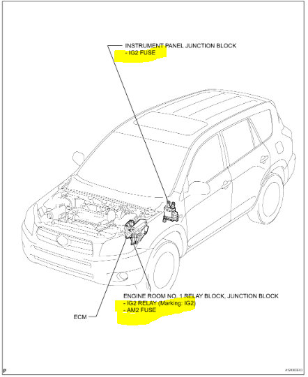

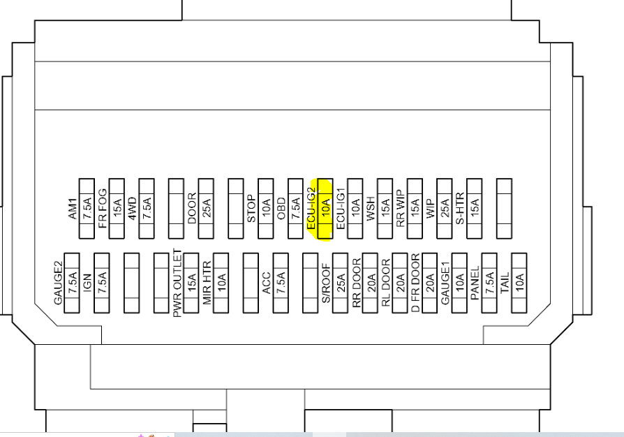

If there is no power, I need you to check three fuses and a relay. If you look at pics 3 and 4, I highlighted the ones to check. Pic 3 is under the hood and pic 4 is in the vehicle.
When you check these fuses, it's important to make sure there is power to them as well as confirm the fuse is good. Here is a link that you may find helpful:
As far as the relay is concerned, switch it with a different one in the box that has the same part number. If there isn't one, here is a link that explains how to test the relay:
Let me know what you find.
