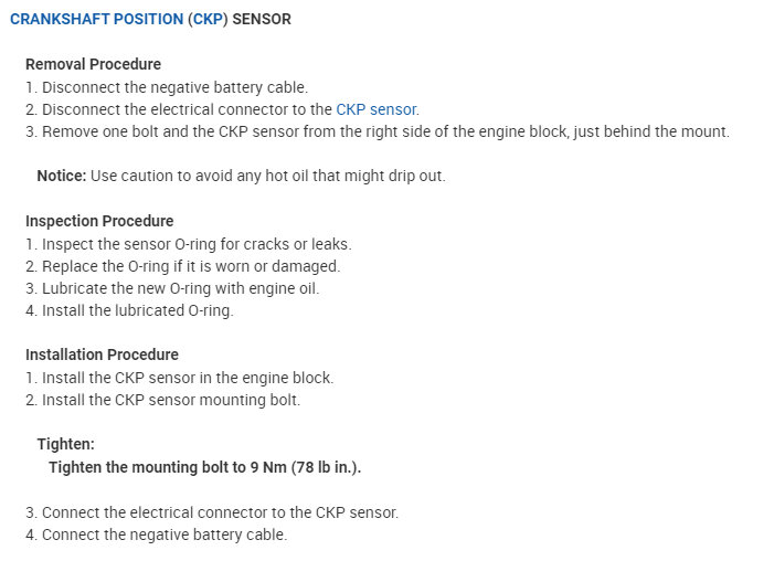

I have the vehicle listed above that will crank but I am not getting any spark. Where should I start trouble shooting?
Feb 5, 2023 at 11:41 AM
  • 110,194 POSTS
Often times a loss of spark is due to a failed crankshaft position sensor. This sensor can fail and still not set a diagnostic trouble code.
If you have a live data scan tool, check to see if there is an RPM signal when cranking the engine. If there isn't, that is where I would start. See pic 1 below.
If you have no scanner but the vehicle has a tachometer, see if it moves a little while cranking the engine.

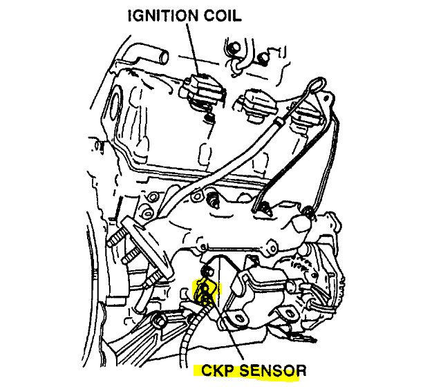

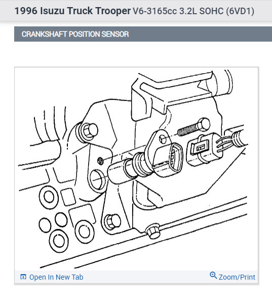

Do me a favor. take a look through this link and let me know if it mirrors what you are experiencing or have experienced:

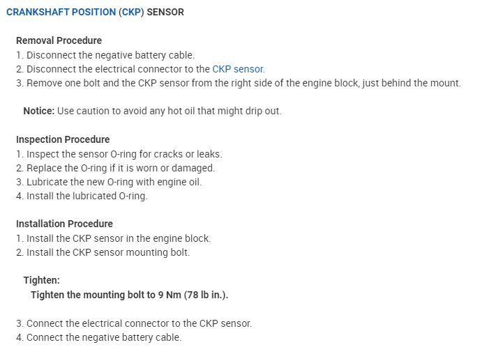

Let me know. Also, the last two pics are the directions for replacing the sensor.
