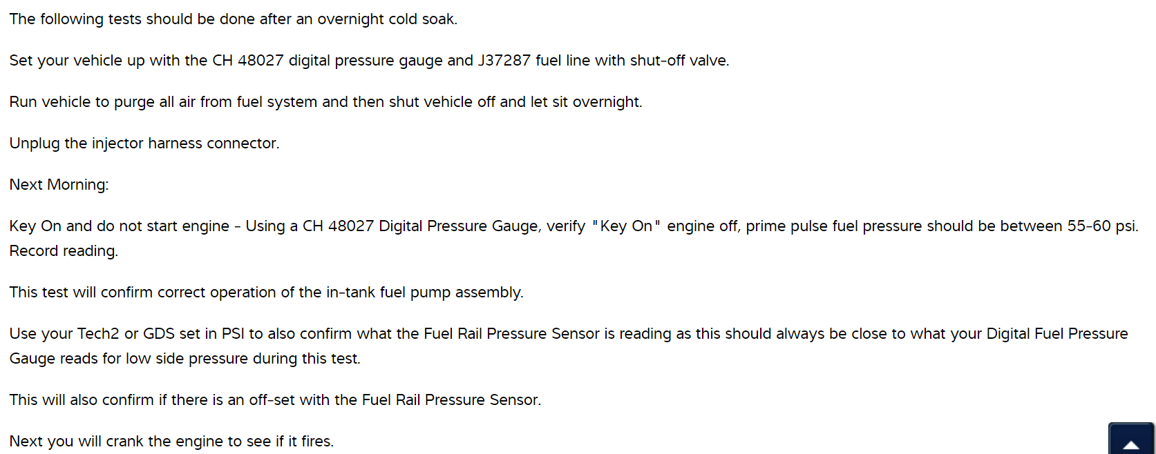

Bought this few days ago. Man said it started running rough, and wouldn’t start back once it shut off. And wouldn’t start back. Sat a year. Was told it could be cam sensors Got it at a steal of a price.
Towed it home charged battery up try didn't have good power so bought a new one.
Still turns everything on but won’t start. Can’t tell if the fuel pump is kicking in or not. What are some things I need to try and check before going deeper in?
How do I check relays or things before replacing pump. Like what should I start at first? Transmission fluid looked good, oil looked decent, just looked as though it needs a change, no shavings in it.

There are a couple of ways to go about this. Basically an engine needs three thing to run. 1) Fuel. 2) Ignition source (spark). 3) Compression. Since you can't tell if the fuel pump is coming on or not, and I like to start with this one anyway, let's see if you are getting spark. I have included down below a couple of links for you to go to.
Please go through these guides and get back to us with what find out. We can go from there.

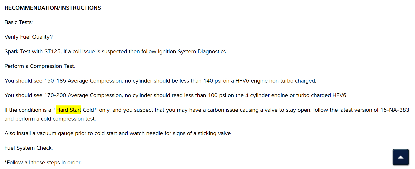

Hey, fuel pump is working, verified by literally crawling underneath and hearing it and unhooking from under hood, has fuel there to!
Still when you turn the key, it acts like it’s going to then nope notta.. plugs have spark ):
Fuses and relays look good.
Can the cam sensors cause this much issue? Crank sensor? Those was next on the list ): has decent compression. I honestly don’t think it’s a timing chain, issue. Called gm they verified my vin was in the good ones with no recalls. I’m starting to get annoyed!

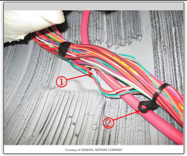

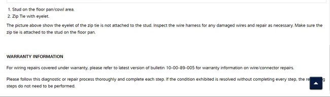

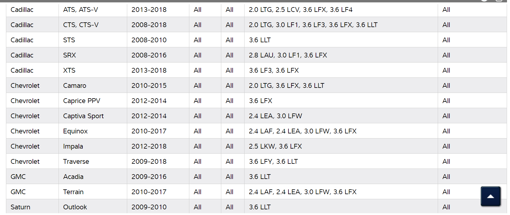

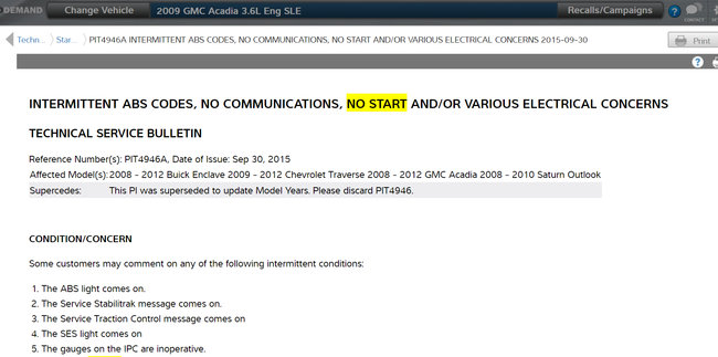

Hello again,

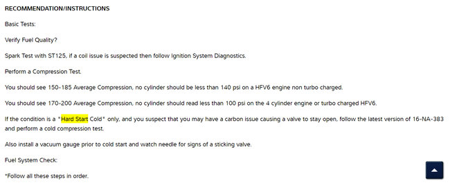

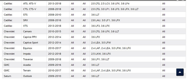

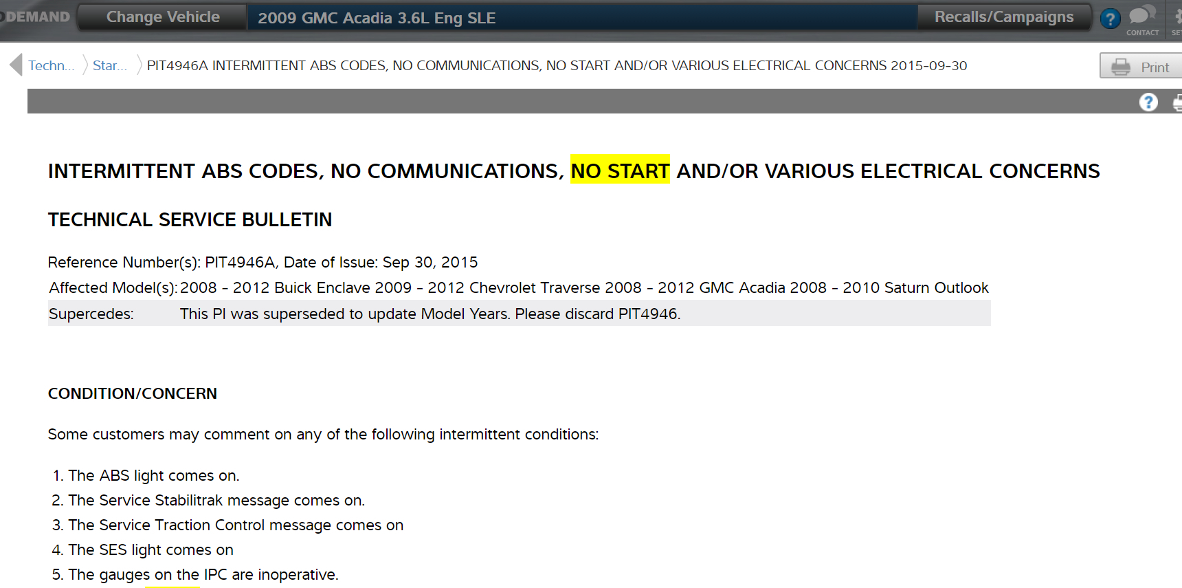

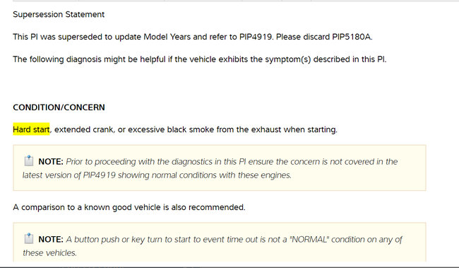

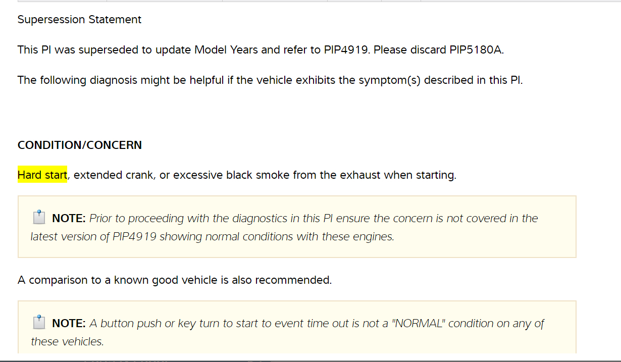

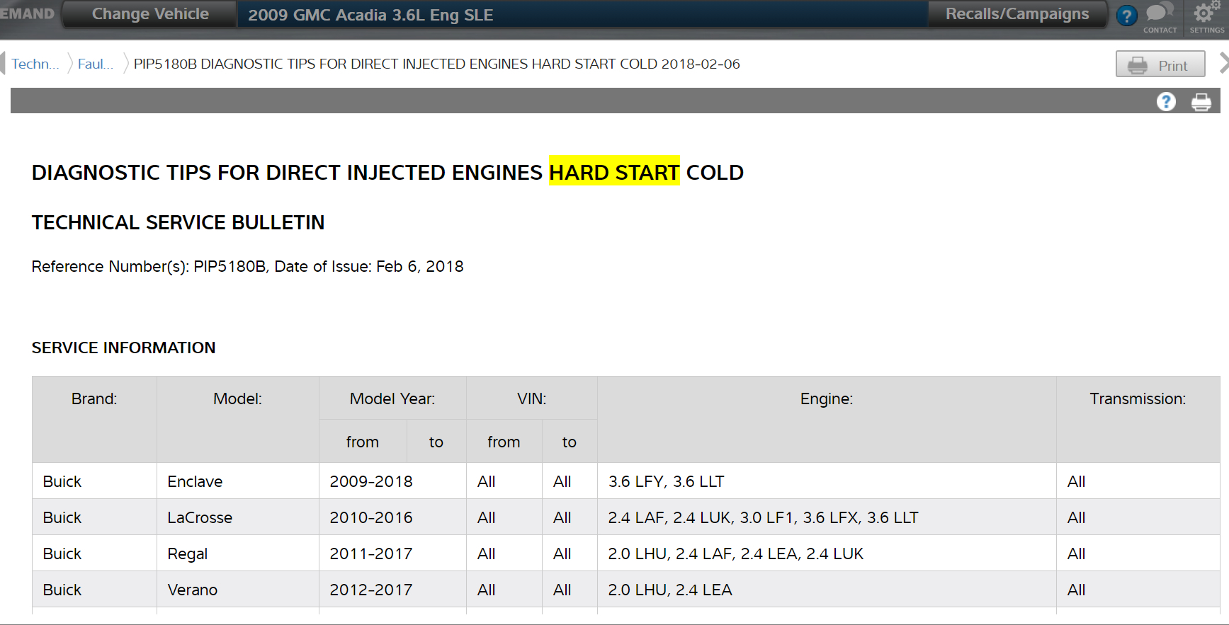

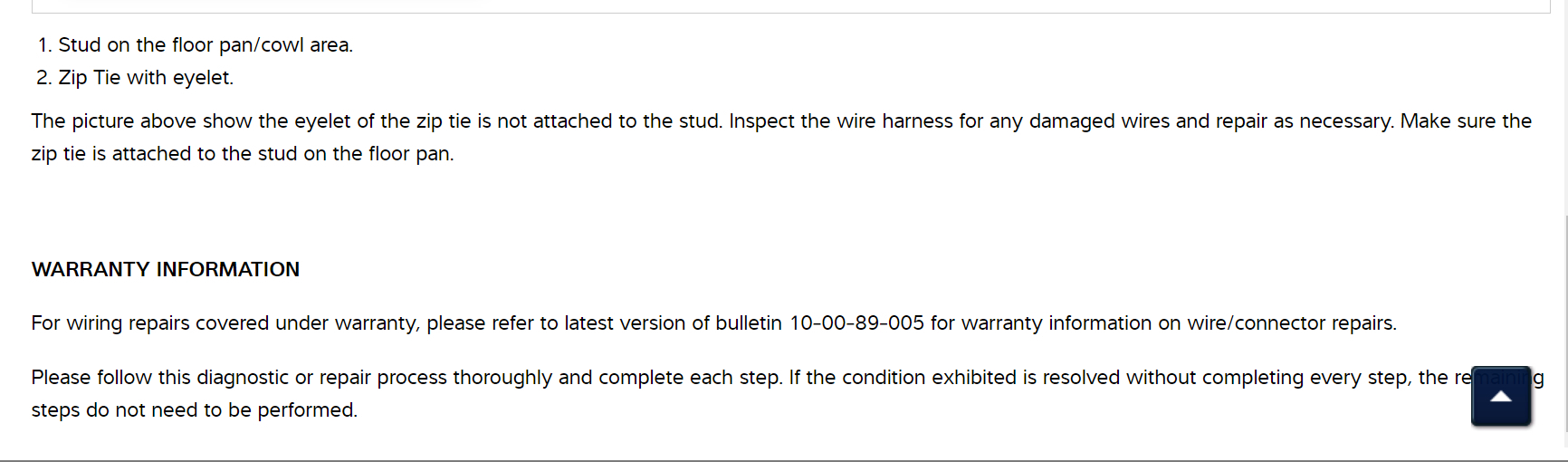

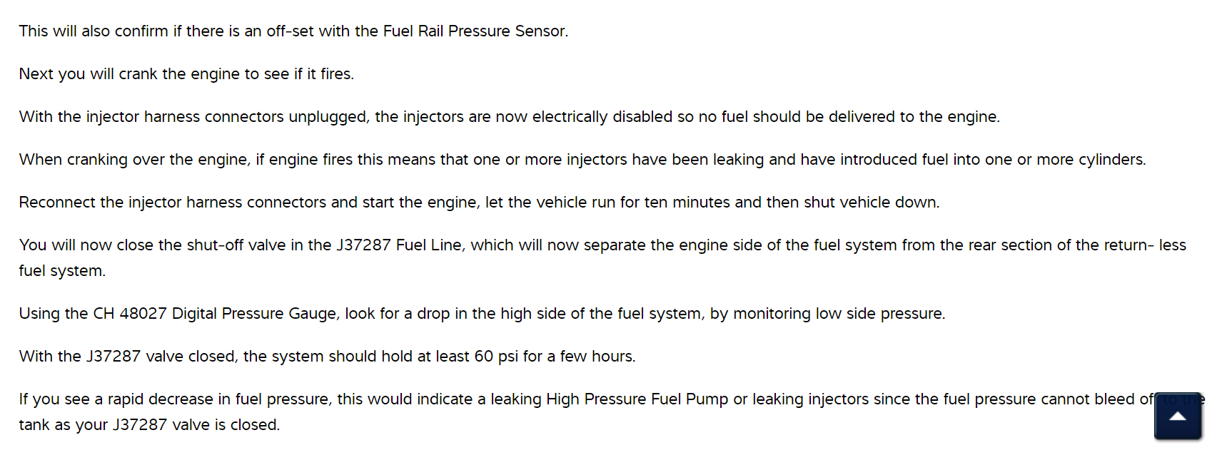

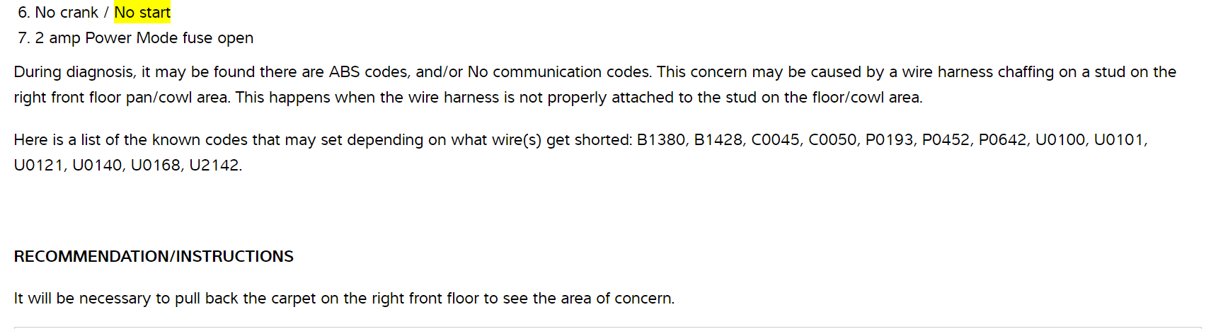

Okay, Let's try these Technical Service Bulletin's (TSB) first. Then I have a factory troubleshooting guide with a couple of tests that probably wouldn't have been thought about. I have them all listed in the diagrams down below. Please go through them and get back to us with what you find out.

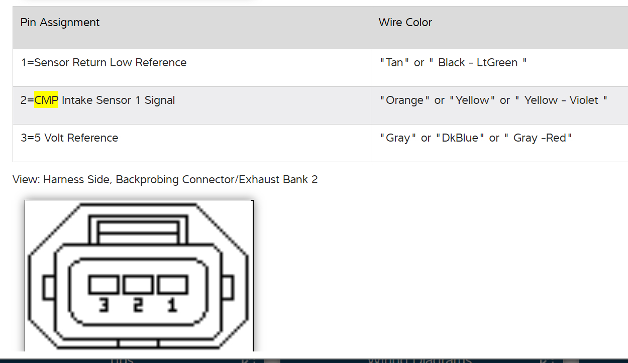

Hey that seems to be good. Took out cam sensors 1 seems to be completely dead. Others have around 200 on meter.

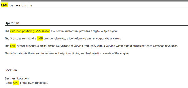

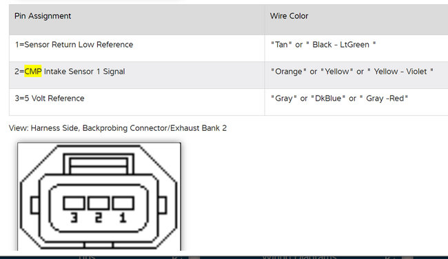

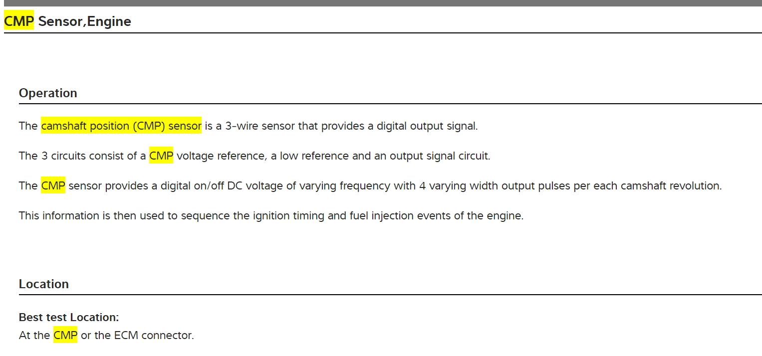

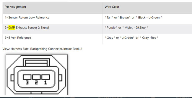

  • 4,897 POSTS
Hello again,

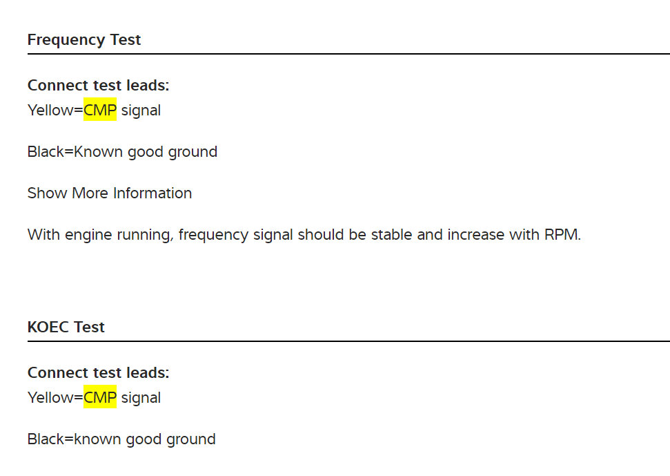

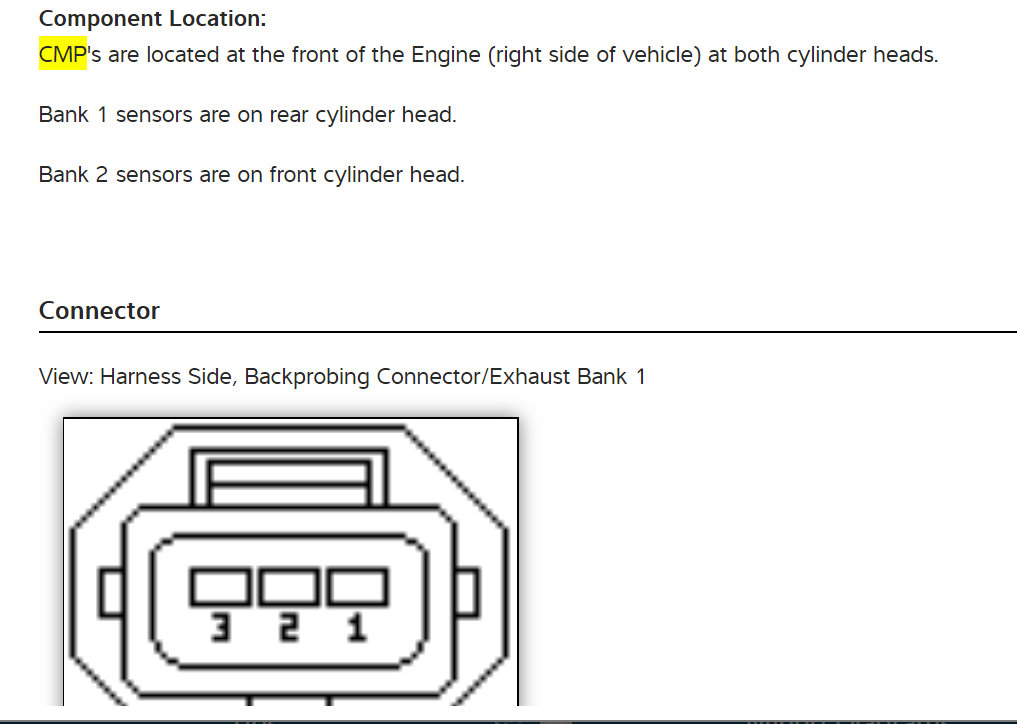

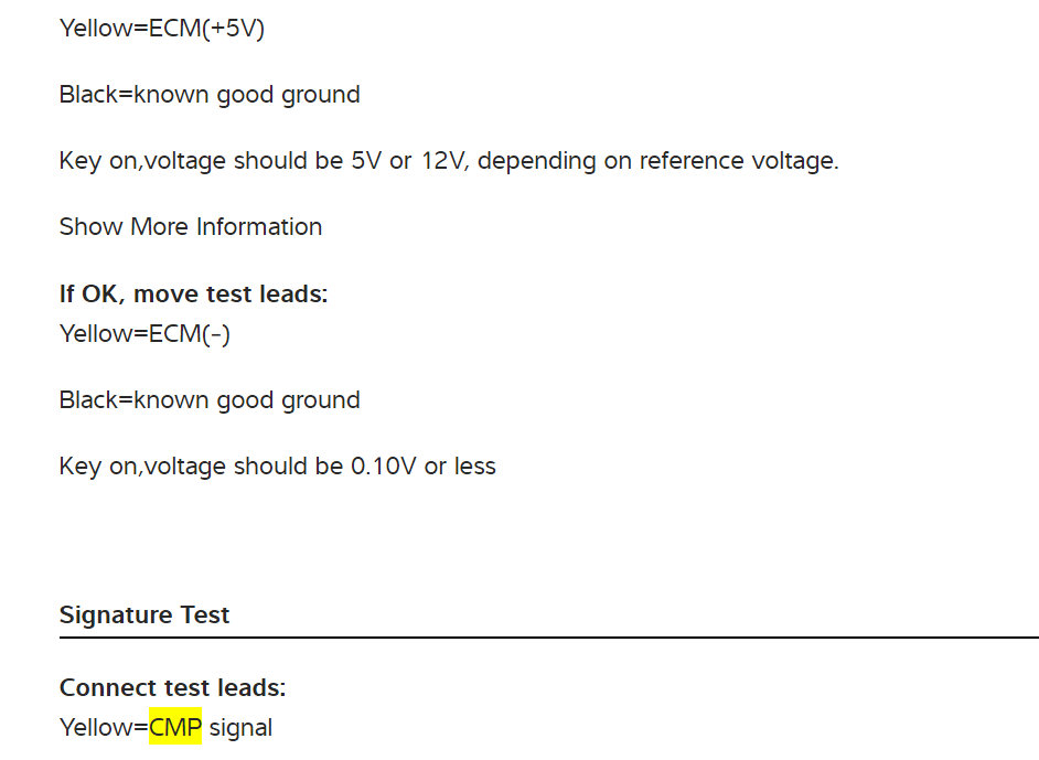

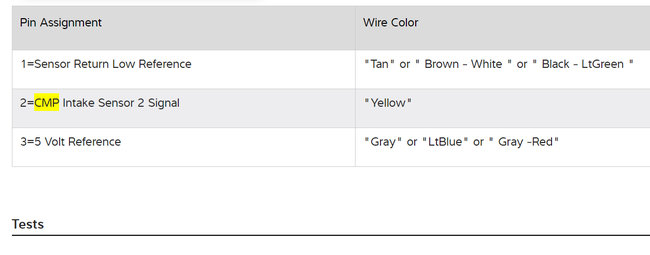

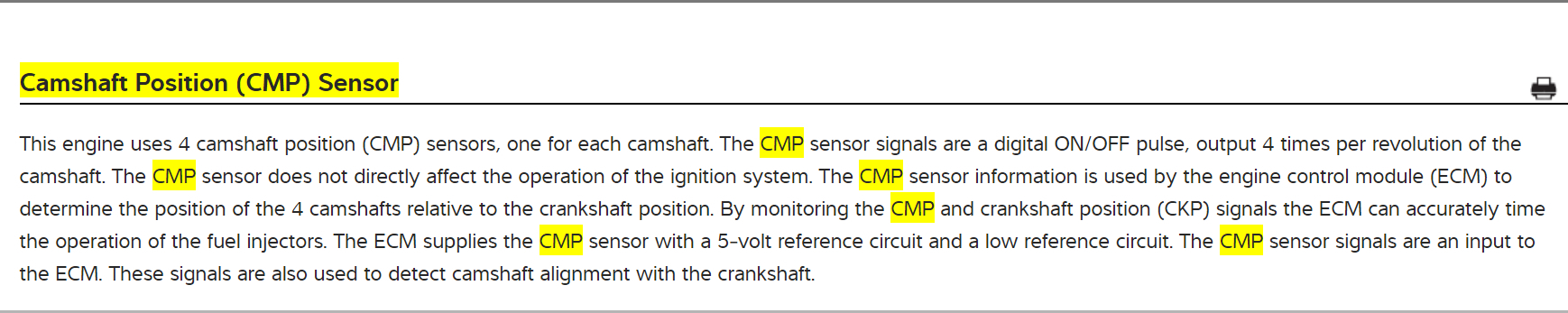

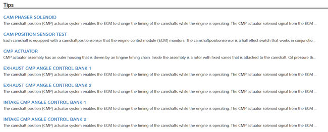

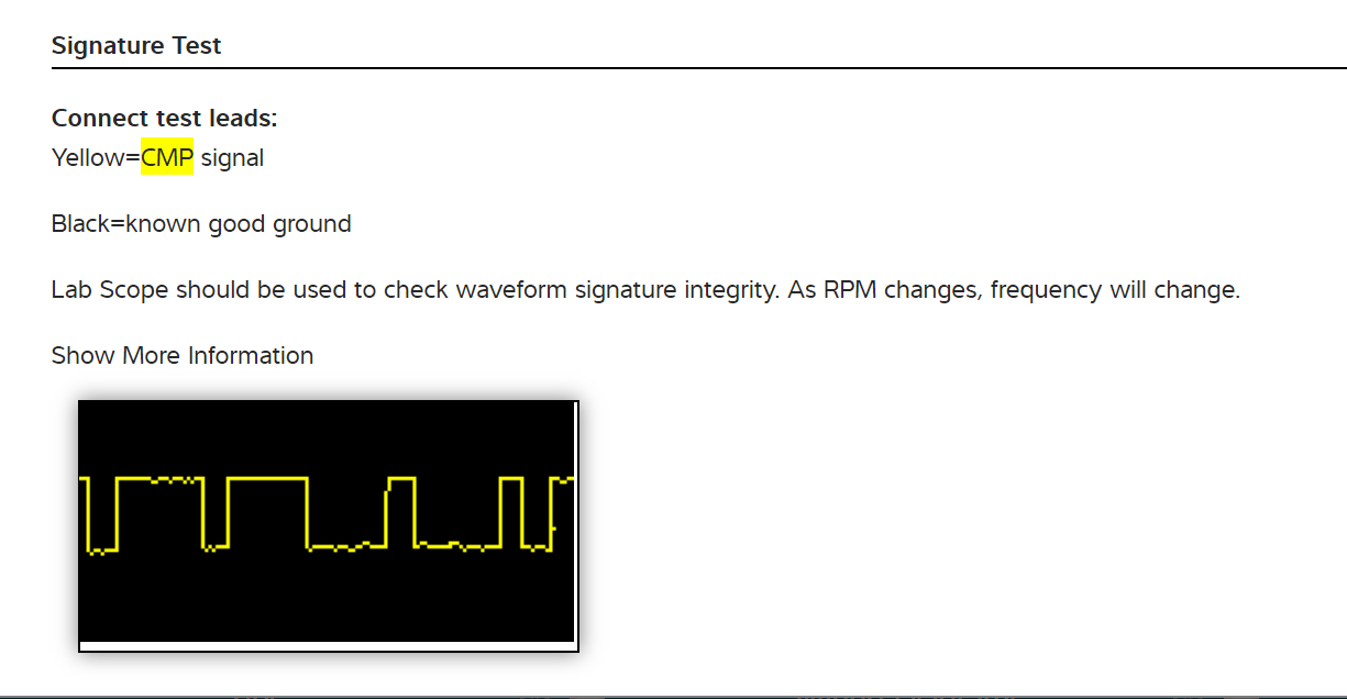

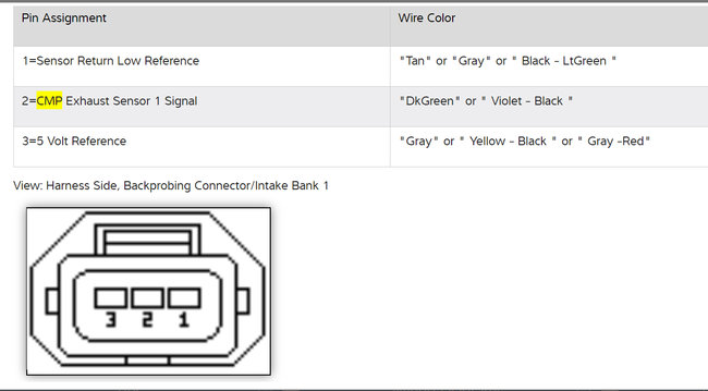

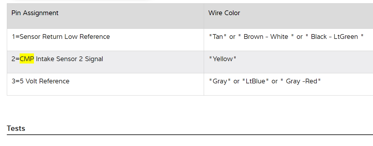

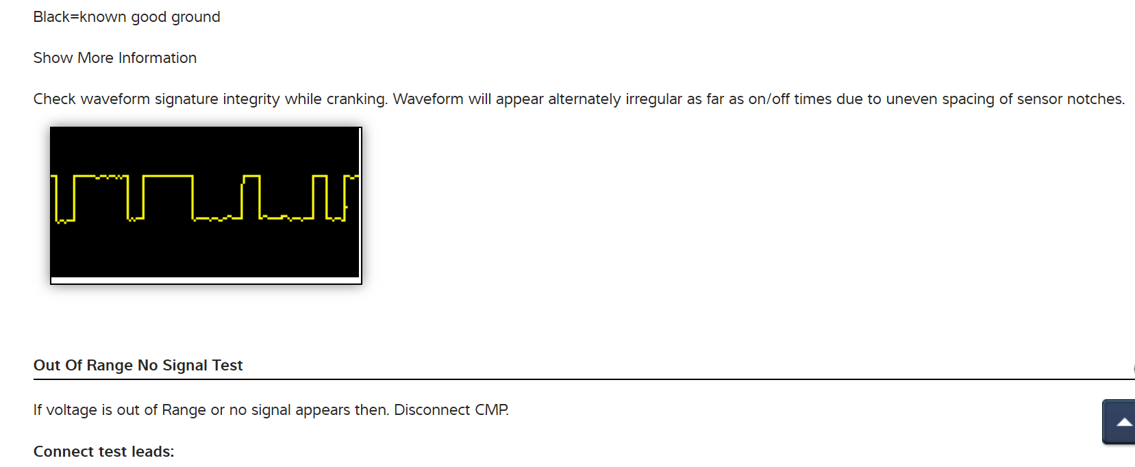

Normally hear I would say that it is time to test the Crankshaft Position Sensor(CKP) because it sounds to me like you are not getting spark, but you mentioned something about your Camshaft Position Sensor being dead earlier so let's test those again first. I have included a factory test for these in the diagrams below. Please go through the tests and get back to us with what you find out. If one or more have failed then they will need to be replaced.

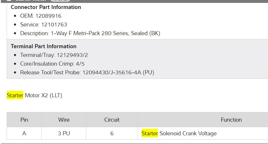

That sounds like the Bendix gear comes out and tries to turn the flywheel but the battery isn't strong enough to turn the starter motor so the Bendix retracts. Can you guys take a multi-meter and tell me the voltage of the battery, please.

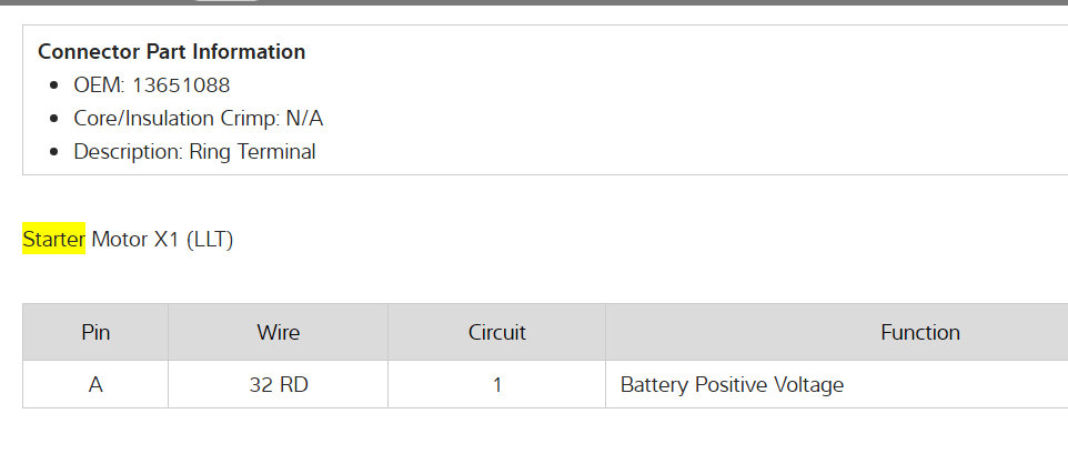

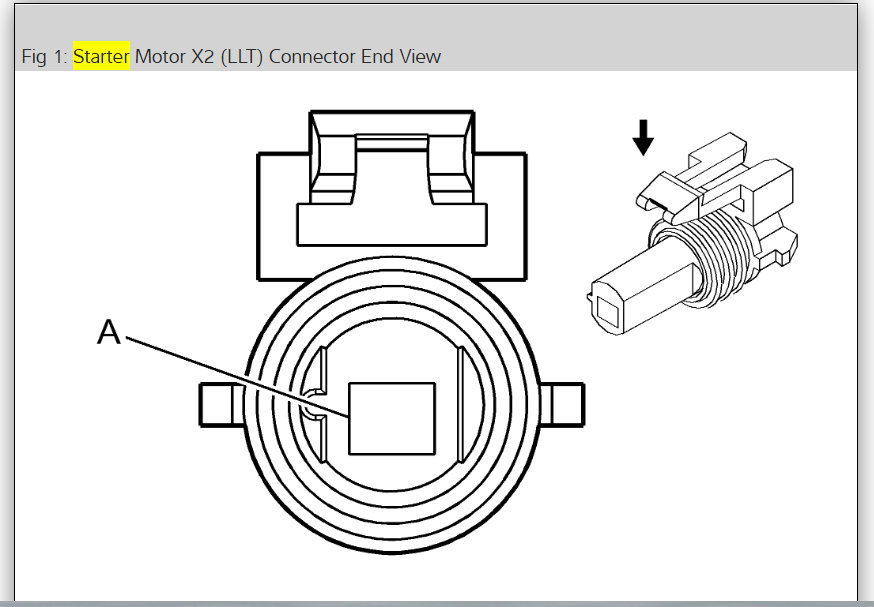

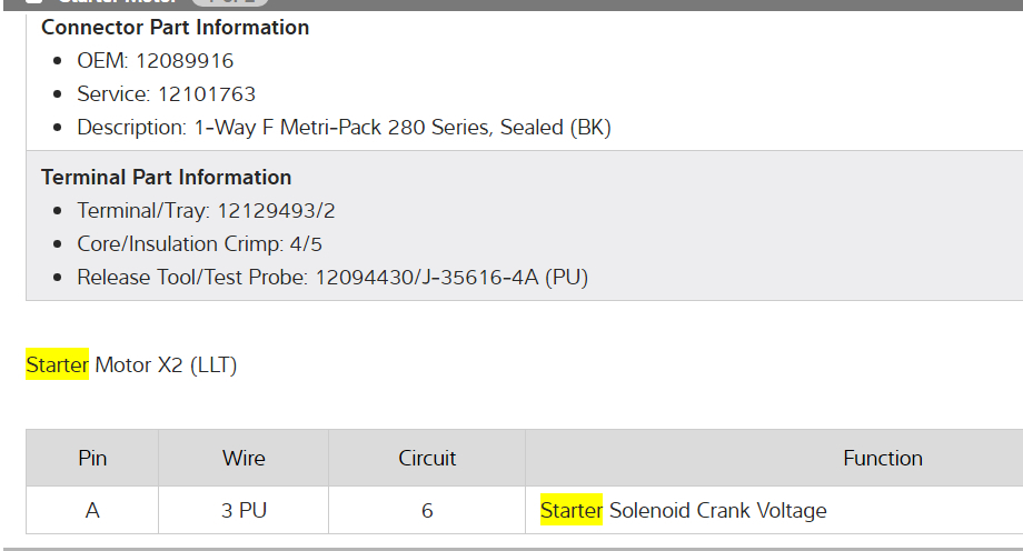

Okay, Then can you please check the connections at the battery? Make sure they are clean, corrosion free, tight, and have good metal to metal contact. Follow the wire from the battery(+) to the starter making sure it is not damaged and check the connections on the starter please. I have included information on the starter connections in the diagrams down below, Please check these connections out and get back to us with what you find out please.

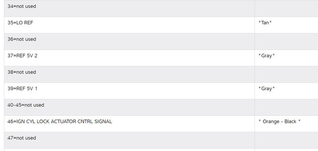

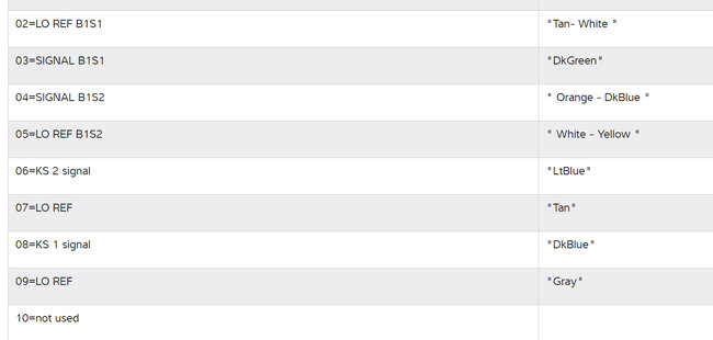

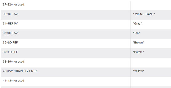

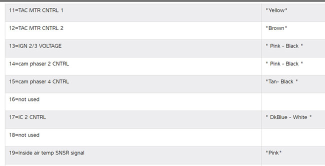

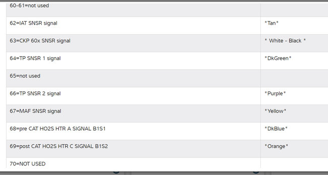

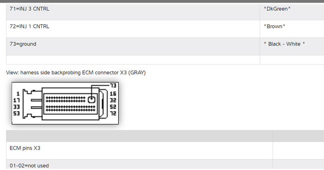

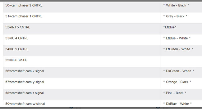

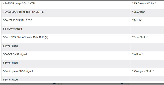

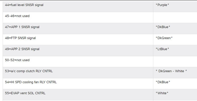

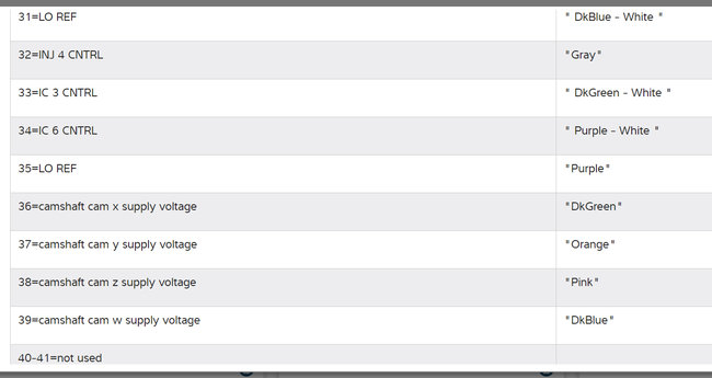

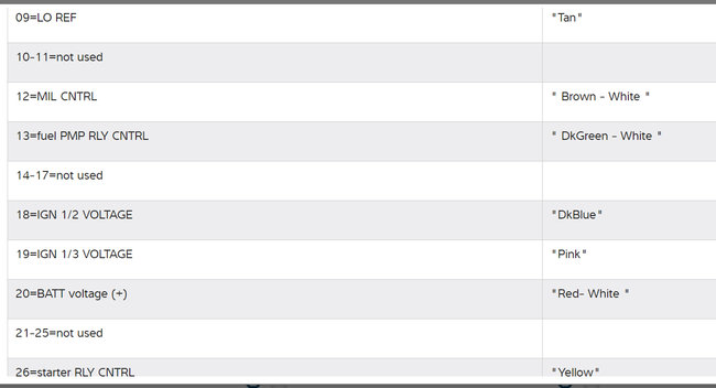

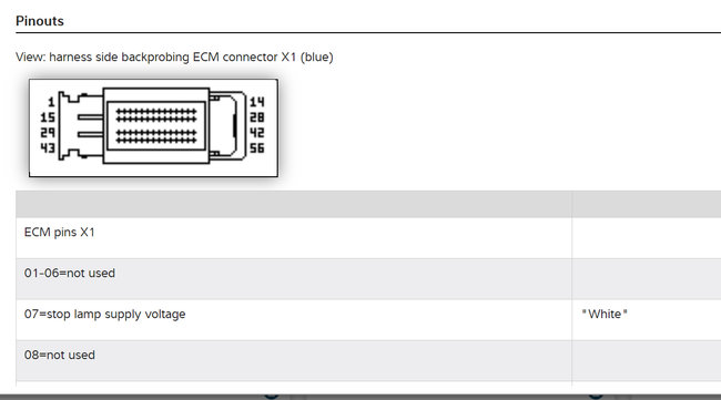

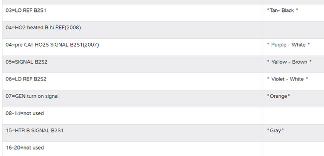

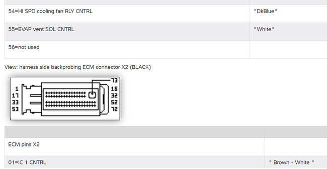

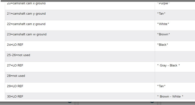

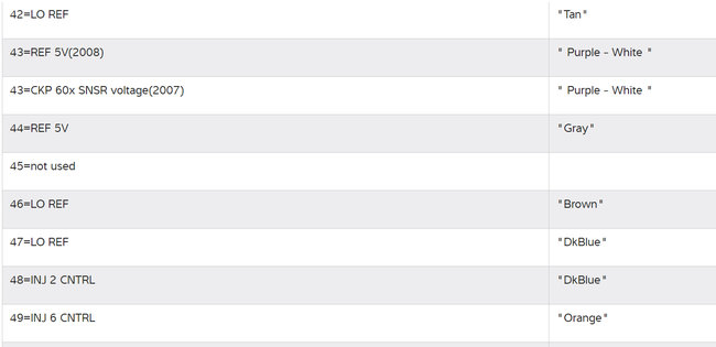

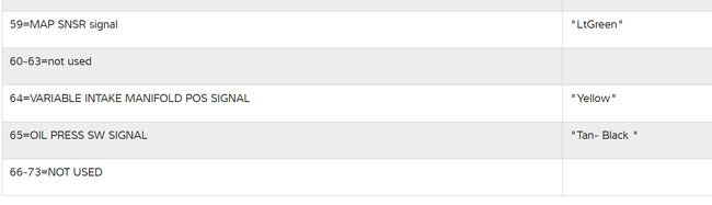

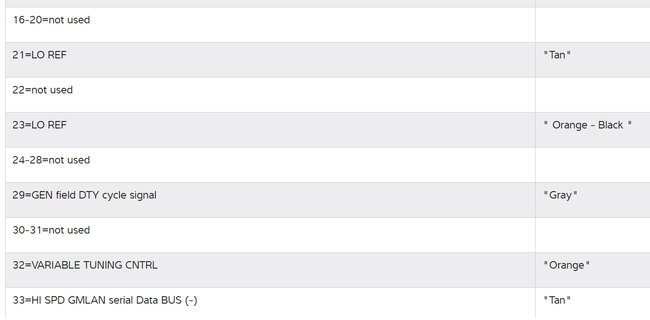

I have a 2007 Acadia that has a similar cranks but won't start issue.
It started to idle rough and after disconnecting various connectors and reconnecting them to see the effect, I discovered the root issue was a shorted cam position actuator wire pair near the connector. Unfortunately now the car just cranks but won't start. It has fuel to the fuel rail and spark. While using starting fluid, it blew a flame out of the intake. The only way that I figure it can do that is if a valve is open while it's firing a spark plug, which would mean that the spark timing is way off.
I've since changed the crank position sensor, tested all the fuel injectors to be good, and replaced the camshaft position sensors. I'm thinking that the electrical short may have fried the ECM, I've also bought and replaced that.
Does anyone have any suggestions? A ECM Pinout would also help so that I could verify wiring (like crankshaft position back to the ECM)
Please help..
Thanks
Jun 19, 2019 at 1:10 PM
SCGRANTURISMO
  • 4,897 POSTS
In the diagrams down below I have included the information that you requested, an Engine Control Module(ECM) Pinout with callout with wire colors. Please go through this Pinout chart and get back to us with how things turn out, please.
Thanks,
Alex
2CarPros
