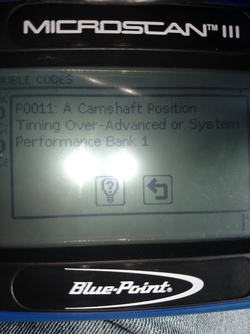

Will not start. Doesn't have enough compression

Here is the code that came up on my computer
+1
Saturday, January 28th, 2017 AT 12:37 PM (Merged)
  • 52,797 POSTS
How do you know the compression is low?
The code is for variable valve timing.
SHAWNSMITH0889
  • 9 POSTS
I used a compression tester. If was around 80
  • 52,797 POSTS
Ok, if all the cylinders are 80 then there is a good chance you have a failed timing chain.
