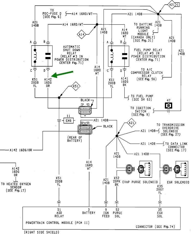

Hey guys,
I'm at a loss, my vehicle listed above I recently purchased was running fine just needed a jump start then ran out of gas, after I put some gas in it, it wouldn’t even turn over with a jump. I replaced the battery and battery terminals, and gave it a good quarter tank of gas, now it will turn over but not start. I don’t hear any noise from the fuel tank from the fuel pump when switched to on, oil light turns on, but oil levels are good. Any ideas are appreciated.

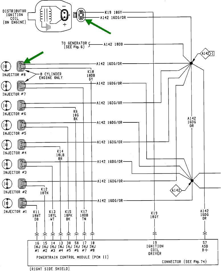

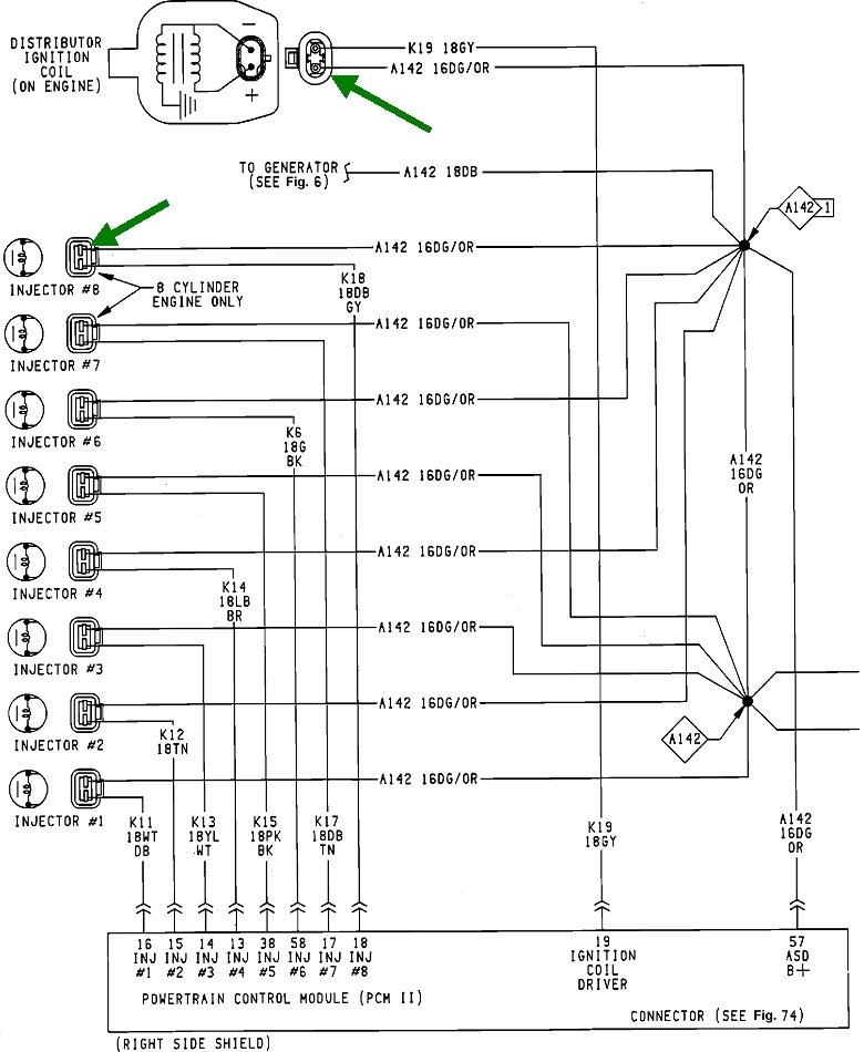

The next test it to check for 12 volts coming from the automatic shutdown, (ASD) relay. The easiest way to see if the circuit is working is to measure the voltage on the dark green / orange wire at the ignition coil or any injector. I prefer to use a test light so I can see it from inside the truck. Also, most digital voltmeters don't respond fast enough.
You should see the 12 volts appear for one second when you turn on the ignition switch, then it will go back to 0 volts. That proves the ASD relay is okay and the Engine Computer has control of it. You should also hear the hum of the fuel pump for that one second. What is important is if that 12 volts comes back during cranking. Most commonly for crank / no-starts, it will not, then you will have no injector pulses and no spark. About five percent of the time the 12 volts will come back during cranking. In that case you have a fuel supply or an ignition problem, but not both.
