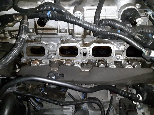

Decided to pull the intake manifold to see if injectors were dirty or I can test.

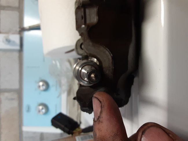

Injectors look pretty clogged.

Here is a link that explains how to test an injector in several different ways. Let me know if it helps.
https://www.2carpros.com/articles/how-to-test-a-fuel-injector

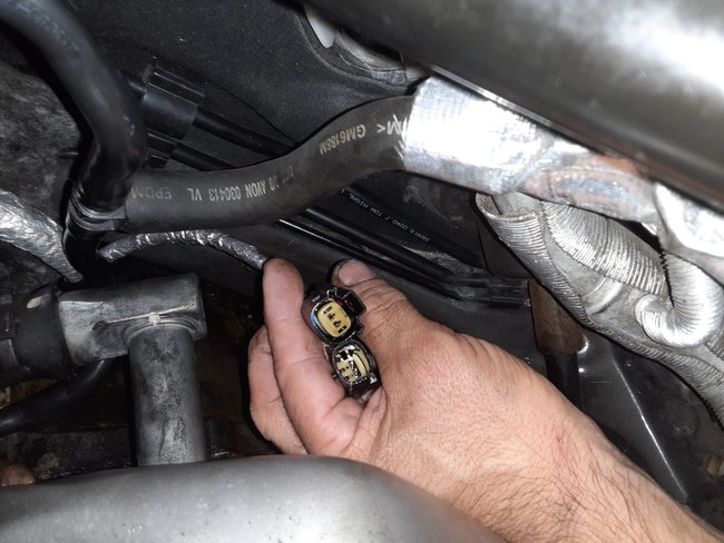

Well well, look what I discovered? Oil soaked plug at rear of block right where I cleaned. Can this possibly be crank sensor?

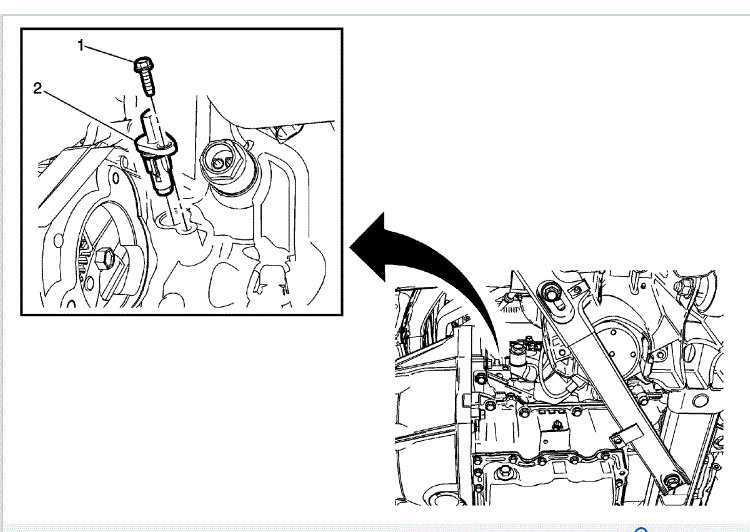

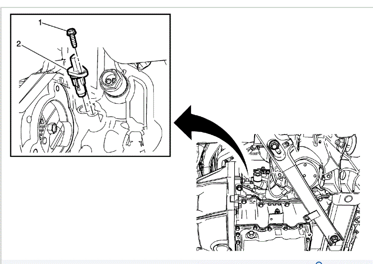

The crankshaft position sensor is behind the starter. Can you tell me where the sensor you found is specifically located? It could be an oil pressure switch. I have seen them leak through to the connector and fail. I have to do further research, but I believe if it fails, the engine won't run as a protection device.
See the pic below for the crank sensor.

It's a connector with a red safety tab and is mounted on a bracket on driver side rear and looks like a brake booster hose running next to it. The plug is routed going somewhere below the exhaust manifold.

Seems to be the oil pressure control valve plug. That plug had a lot of oil in the plug. I might consider changing just for the heck of it but have to remove the catalytic converter to get to that sensor. It's just above the oil filter.
Monday, April 6th, 2020 AT 11:04 PM
  • 109,885 POSTS
If that is what you found, I would replace it. They are known to leak internally and the oil goes into the connector.
