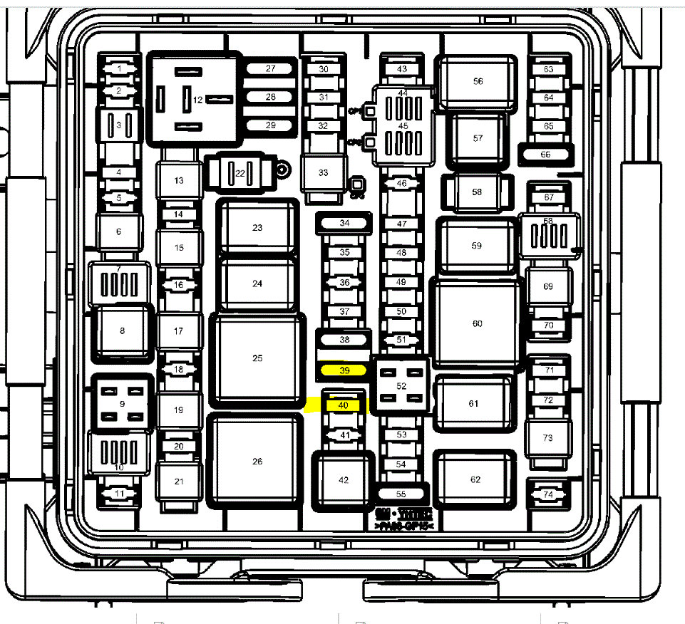

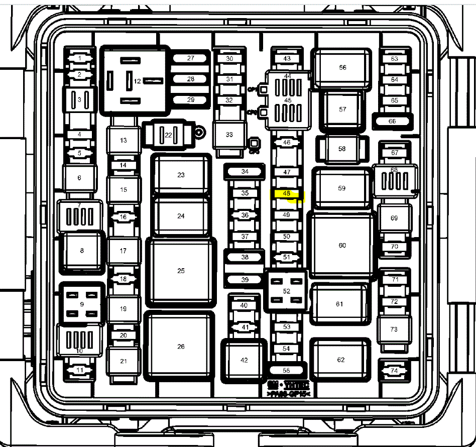

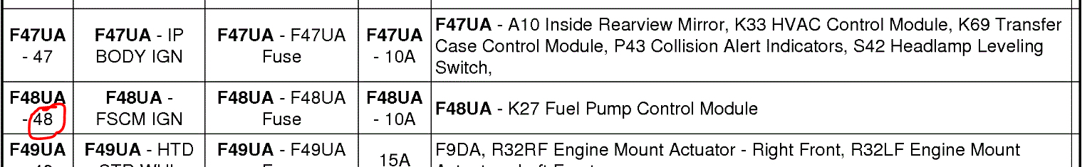

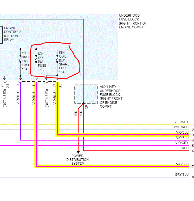

Now, here is what I need you to do. First check fuses 39 and 40 in the under hood fuse box. I attached a pic and highlighted the fuses. These fuses are responsible for the ignition coils.
Also, take a quick look at all fuses in the same box. There are ignition fuses that may have failed.

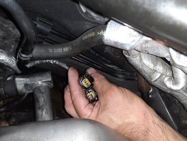

Let me know what you disconnected and dried. If you are not sure of the component's name, if possible, take a pic and upload it for me to see.

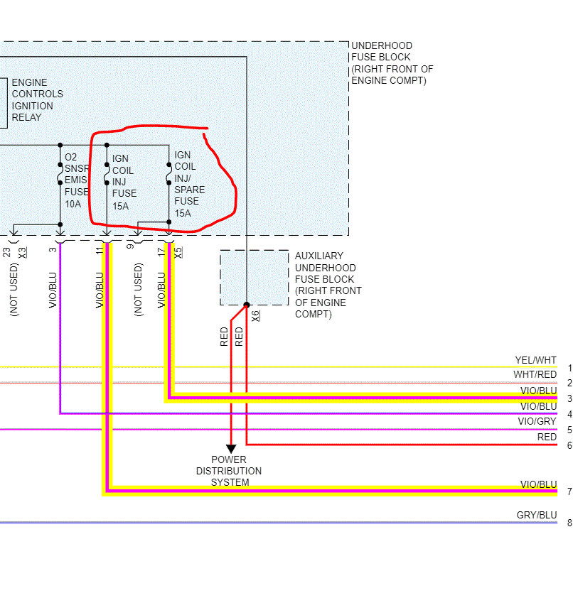

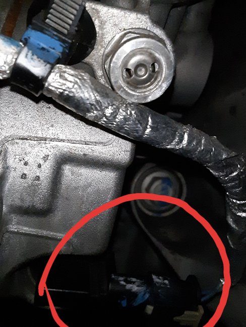

Hi Joe. Attached are the plugs (in red) that was disconnected and blew. In (blue) left connected but blew out. Other is general area.

So I checked fuse 30 and 40 as well as all fuses in that block and all are good.

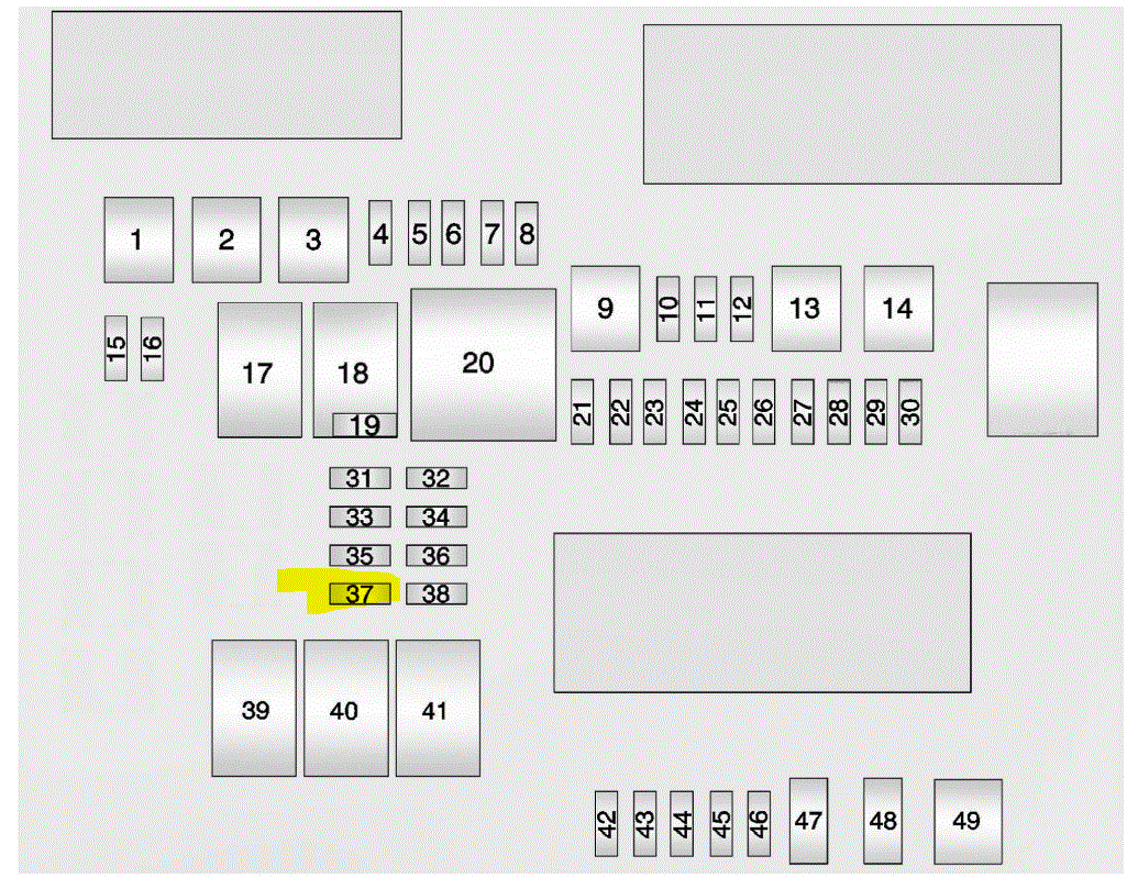

In addition to the fuses, is there power available to them? And was it 30 or 39 you checked? Also, if there is power to them and it still won't start, we need to check to see if there is spark and fuel to the engine. Ignition spark is my first suspect as being a problem and not fuel.
Here is a link that shows how it's done:
I need you to check that for me. Let me know the results.

My mistake, I checked 39 and 40 but also checked all fuses in that compartment. I did not check for voltage as I have no way of checking. We checked each coil for spark by removing coil and spark plug and plugged into spark plug just to see if plug created spark. All spark plugs did show spark with #4 the strongest. While plugs were removed, we did crank to clean out cylinders and did notice that #1 had more fuel than the rest, or in fact #1 spray from cylinder on #1 only that noticed. Checked all connectors again and seem okay. Unplugged battery again to reset. Still no luck. Engine light still came on with traction control and another light below it stays lit as well as traction control message needs diagnosis as well as message for reduced power diagnosis. I think my best bet it to tow it to shop to see if they can figure it out cause I'm getting frustrated and that when the worst will happen.

As far as testing for power at the fuses, all you need is a basic test light. They are very inexpensive and easy to use.

I also checked fuses with bulb and wire, turned ignition to on but no power to #39 or 40, but I'm not sure because it only sends pulses when it's cranking. To send the spark. I do not know.

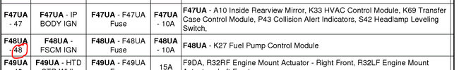

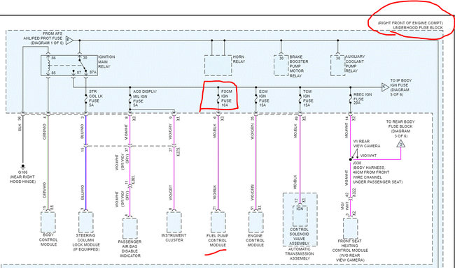

Okay. Chances are it isn't the pump, but rather something electrical. Check the following fuse. See attached pics. Pic 1 indicates the fuse purpose, pic 2 shows what it powers, pic 3 shows location in the fuse box under the hood.
Let me know what you find.

Checked and that fuse is not blown.

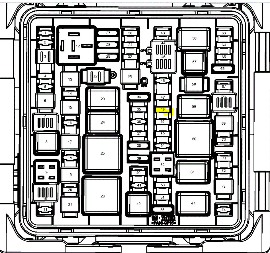

Check it for power. Something has most likely failed due to shorting from the water. It is hard to believe the pump failed. Not saying it isn't possible, but really odd. There is a fuse box in the trunk. I need you to check fuse 37 as well. See picture 1.
Sorry to be driving you crazy with fuses, but I really feel something got wet and shorted.

Too dark here now, but I did check that fuse earlier and was also good.

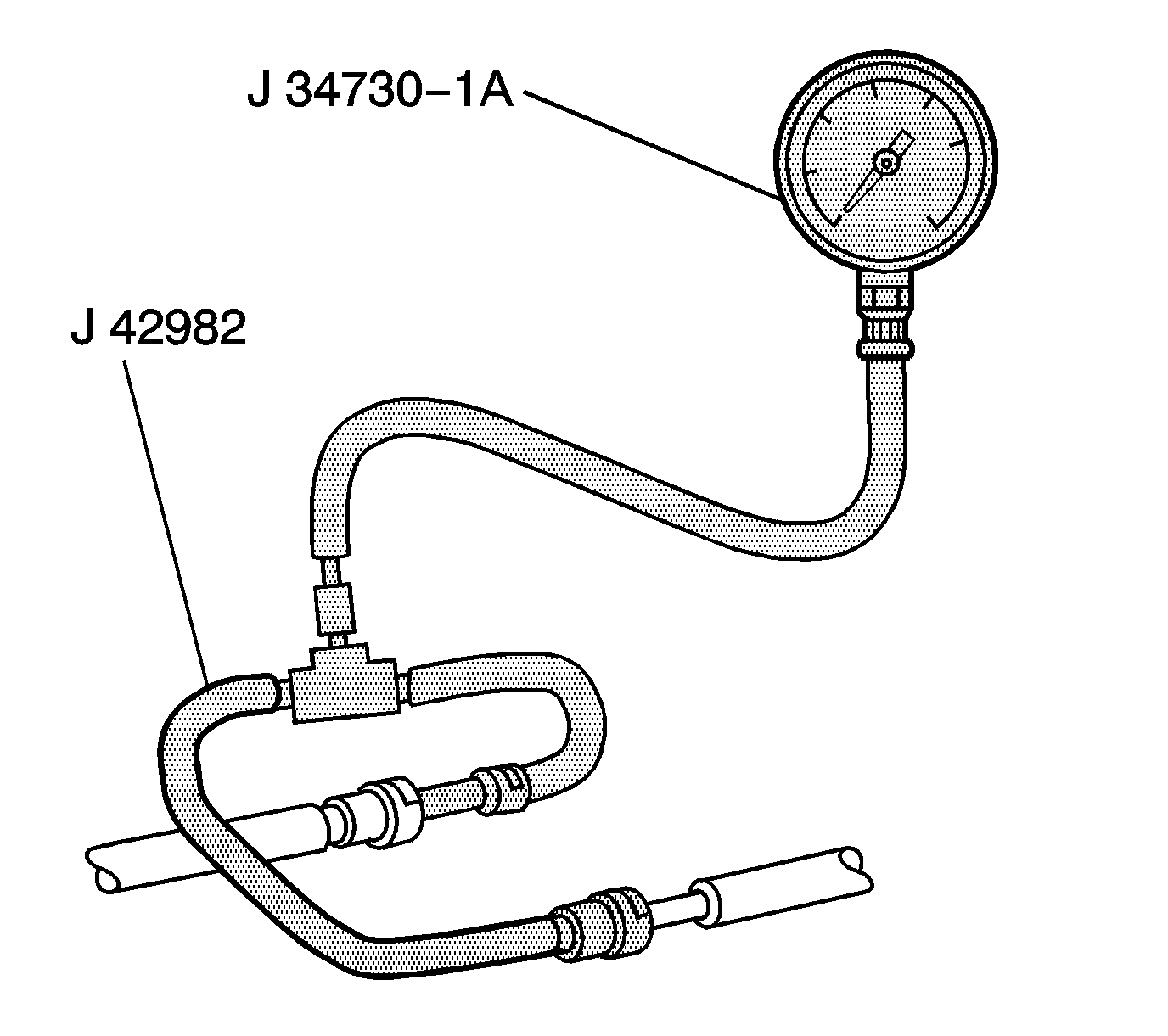

Here are the directions for connecting a gauge to your vehicle. The attached pics correlate with these directions.
____________________________
2013 Cadillac ATS Sedan RWD L4-2.5L
Fuel Pressure Gauge Installation and Removal
Vehicle Powertrain Management Fuel Delivery and Air Induction Fuel Pump Fuel Pressure Testing and Inspection Component Tests and General Diagnostics Fuel Pressure Gauge Installation and Removal
FUEL PRESSURE GAUGE INSTALLATION AND REMOVAL
Special Tools
* CH-47831 - Fuel Line Disconnect Tool
* J 34730-1A - Fuel Pressure Gauge
* J 42982 - Fuel Pressure Gauge Adapter
Installation Procedure
Warning
Gasoline or gasoline vapors are highly flammable. A fire could occur if an ignition source is present. Never drain or store gasoline or diesel fuel in an open container, due to the possibility of fire or explosion. Have a dry chemical (Class B) fire extinguisher nearby.
Warning
Wrap a shop towel around the fuel pressure connection in order to reduce the risk of fire and personal injury. The towel will absorb any fuel leakage that occurs during the connection of the fuel pressure gauge. Place the towel in an approved container when the connection of the fuel pressure gauge is complete.
Caution:
Clean all of the following areas before performing any disconnections in order to avoid possible contamination in the system:
* The fuel pipe connections
* The hose connections
* The areas surrounding the connections
1. Relieve the fuel pressure. Refer to Fuel Pressure Relief See: Fuel Pressure Release > Procedures > Fuel Pressure Relief.
2. Disconnect the quick connect coupling of the fuel feed hose from the fuel feed pipe of the fuel rail. Use a shop towel in order to catch any remaining fuel that may leak.
3. Remove the intake manifold cover. Refer to Intake Manifold Cover Replacement See: Intake Manifold > Removal and Replacement > Intake Manifold Cover Replacement.
4. Install the J 42982 - adapter between the fuel feed pipe of the fuel rail and of the fuel feed hose.
pic 1
Caution: Refer to Fastener Caution See: Vehicle > Technician Safety Information > Fastener Caution.
5. Install the J 34730-1A - gauge to the J 42982 - adapter, and tighten securely.
6. Turn ON the ignition in order to pressurize the fuel system.
7. Turn OFF the ignition.
8. Check for any fuel leaks.

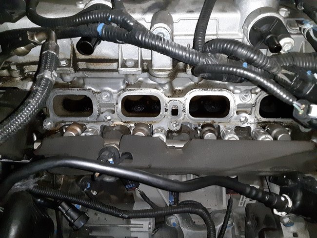

Decided to pull the intake manifold to see if injectors were dirty or I can test.
Apr 6, 2020 at 7:19 PM
STEVEAL01
  • 140 POSTS
Injectors look pretty clogged.

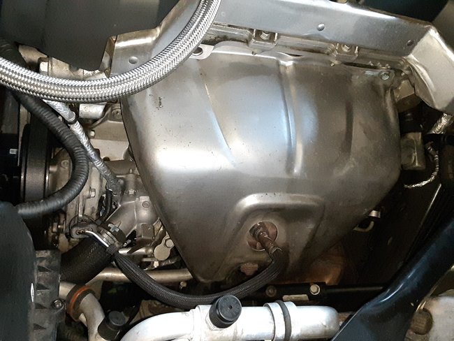

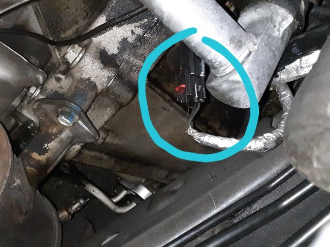

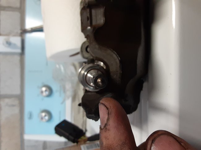

Well well, look what I discovered? Oil soaked plug at rear of block right where I cleaned. Can this possibly be crank sensor?

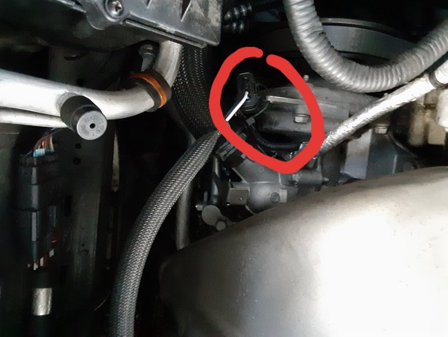

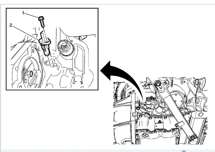

The crankshaft position sensor is behind the starter. Can you tell me where the sensor you found is specifically located? It could be an oil pressure switch. I have seen them leak through to the connector and fail. I have to do further research, but I believe if it fails, the engine won't run as a protection device.
See the pic below for the crank sensor.
Apr 6, 2020 at 9:14 PM
STEVEAL01
  • 140 POSTS
It's a connector with a red safety tab and is mounted on a bracket on driver side rear and looks like a brake booster hose running next to it. The plug is routed going somewhere below the exhaust manifold.
Apr 6, 2020 at 9:58 PM
STEVEAL01
  • 140 POSTS
Seems to be the oil pressure control valve plug. That plug had a lot of oil in the plug. I might consider changing just for the heck of it but have to remove the catalytic converter to get to that sensor. It's just above the oil filter.
Apr 6, 2020 at 11:04 PM
  • 110,194 POSTS
If that is what you found, I would replace it. They are known to leak internally and the oil goes into the connector.

So got it going and runs sweet as before. Cleaned intake, valves, injectors and connectors that had oil. No one had that oil pressure switch so just had to roll the dice and cleaned.
