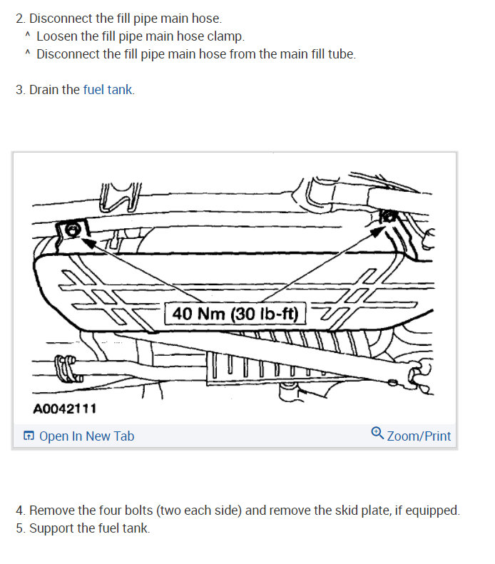

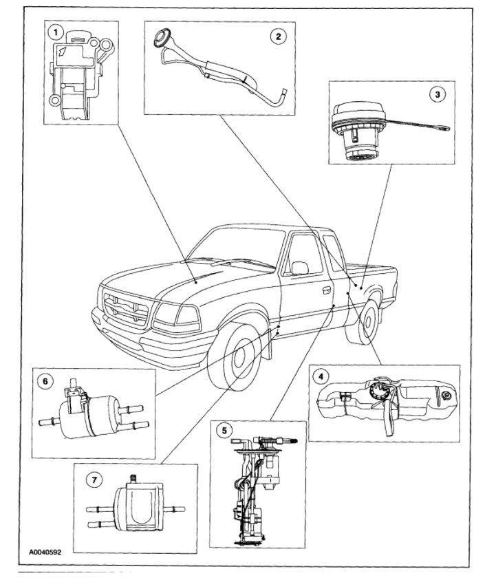

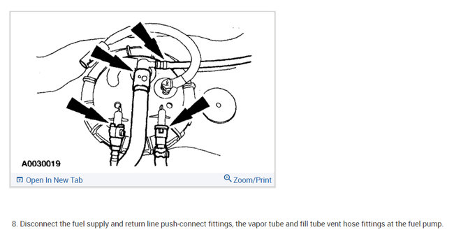

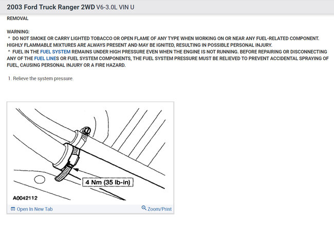

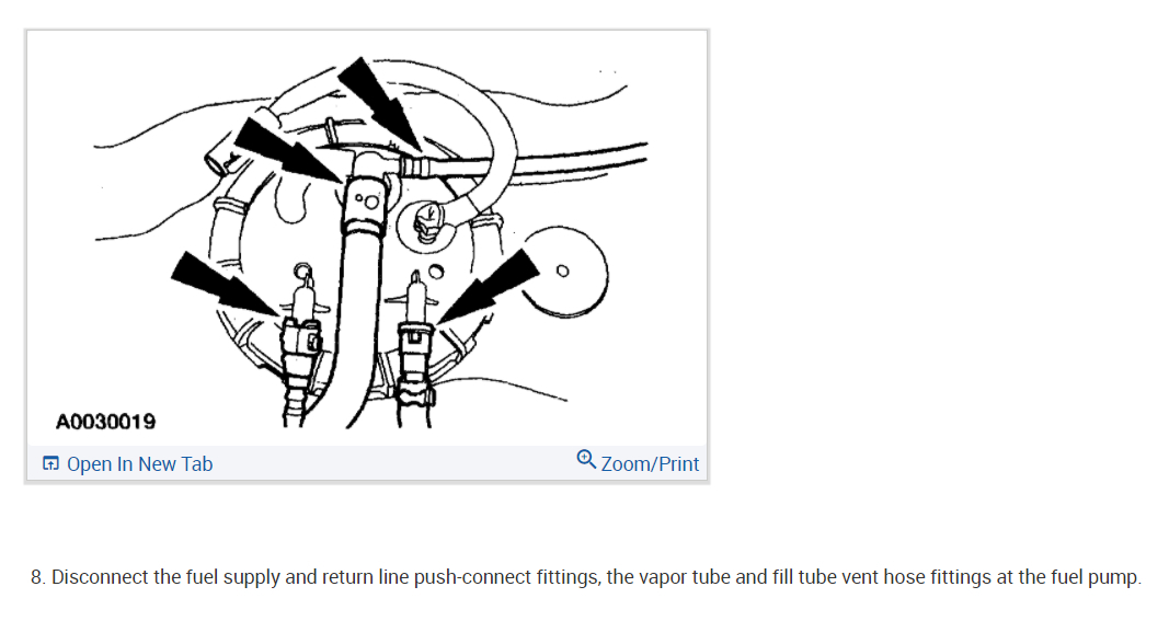

I realigned my TRS and changed my fuel filter the other night and now my truck just cranks but it won't start. Prior to this I had no fuel delivery problems, no hard starts intermittent, no stalling or anything. I hadn't an issue with my TRS being out of line and while I was down there, I changed my fuel filter. Last night I took the battery out to go get it charged and while that was up, I pulled the fuel pump relay and the PCM and hit the inertia reset button. The battery was out for a little over an hour and as well as the relays I put the battery in primed it turned it on and off and it started up, so I drove her around for about 10-15 minutes. Shut her off went out this morning same issue crank but no start.
May 6, 2022 at 4:40 AM
  • 55,743 POSTS

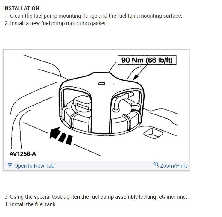

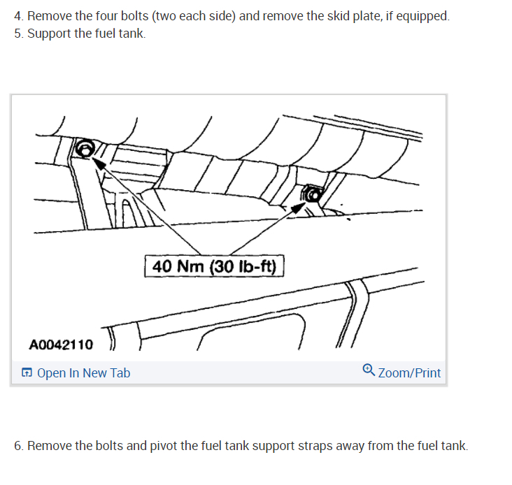

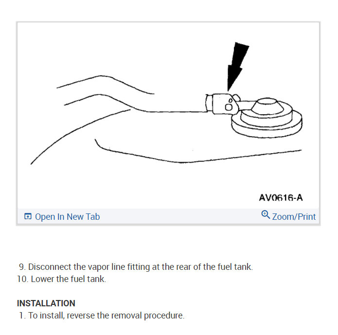

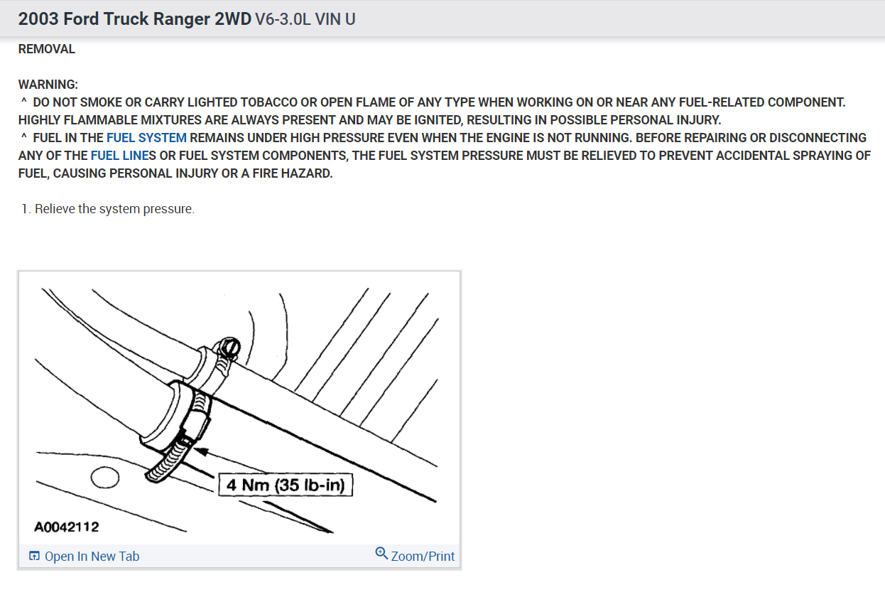

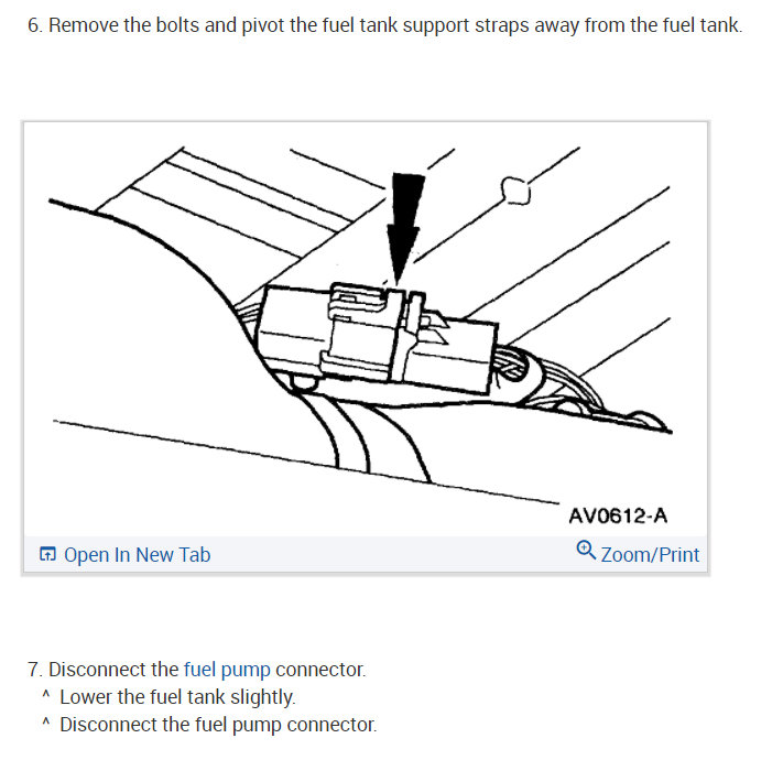

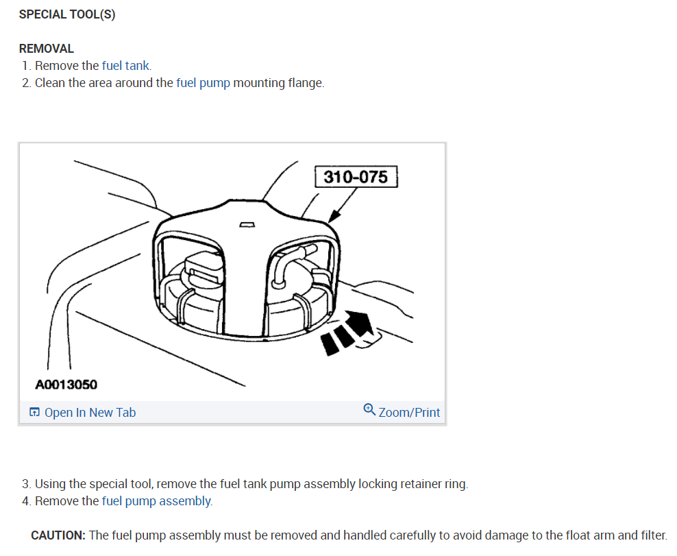

Can you hear the fuel pump hum in the tank when you turn the key on but not start the engine? If not, it sounds like the fuel pump has gone out, which sometimes happens when changing out the fuel filter. Here are instructions on how to change the fuel pump out in the diagrams below, also I have included two engine no start guides please go over them as well.
and
https://www.2carpros.com/articles/car-not-running-advanced
