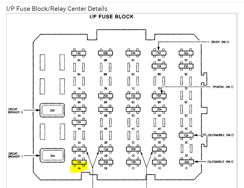

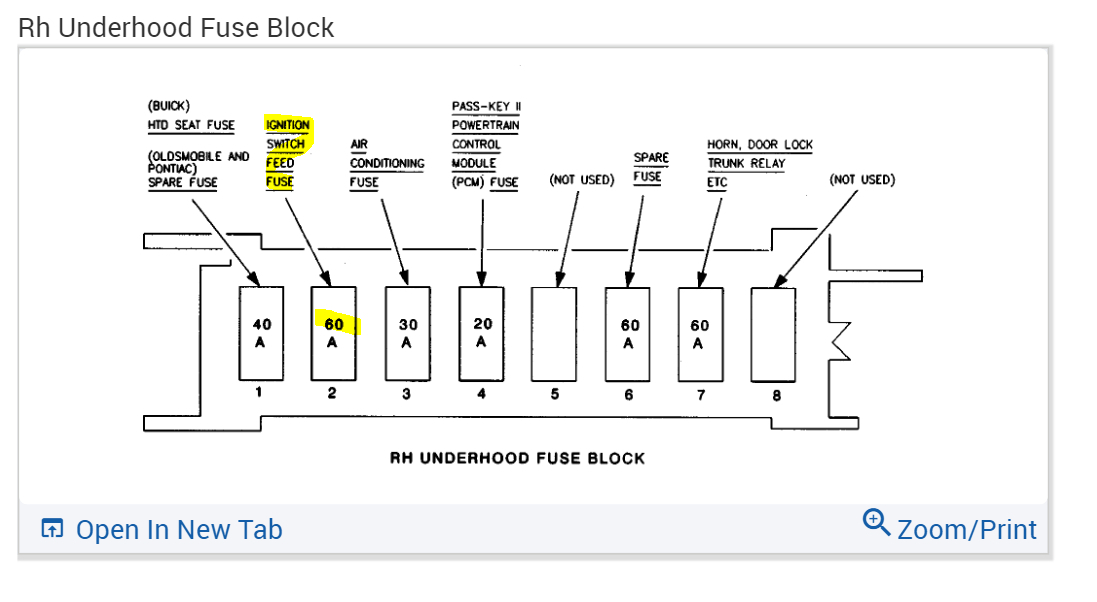

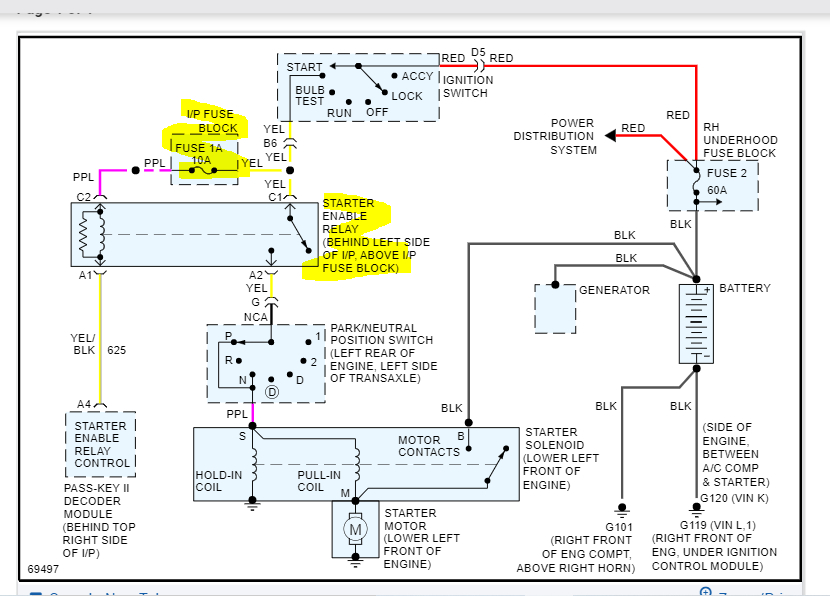

Car wouldn’t crank.
Checked fuses.
Replaced starter.
Batteries good.
When you turn the key, all the lights come on and it makes a click in the bottom right side of the dash.
When I jump the starter the vehicle cranks and runs for about 3 seconds and cuts off.

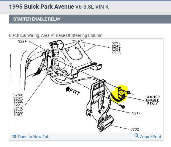

I attached the starting system wiring schematic below so that you have a reference. Here is the thing, there is a relay that could make a click under the dash, but it should be on the driver's side.

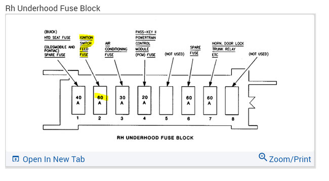

Will the starter engage if you place the shifter in neutral? Also, have you checked the starter relay under the dash and above the fuse box as well as fuse 1A in the instrument panel fuse box? if not, do that. Additionally, check fuse 2 in the under-hood fuse box. Also, confirm there is power to and from them.
Also, here is a link that explains how to test a relay. Use this when testing the starter relay.
