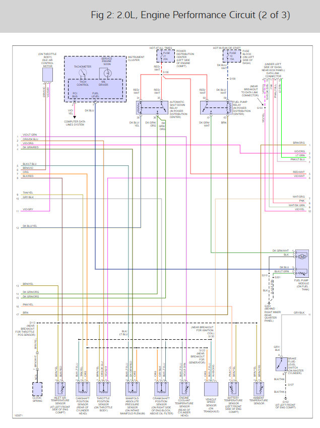

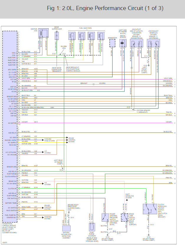

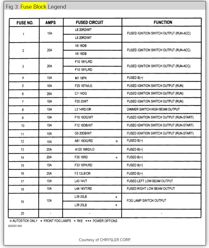

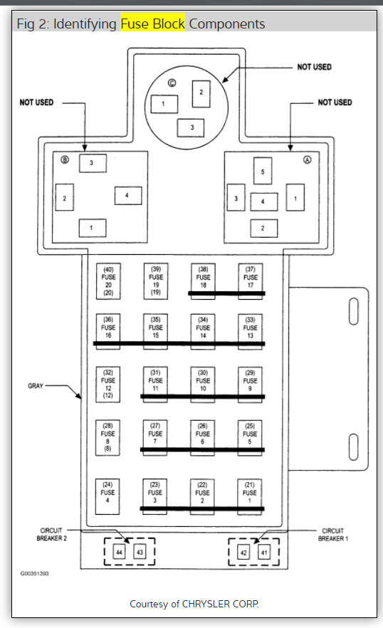

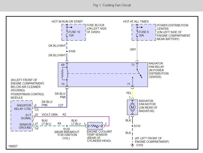

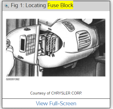

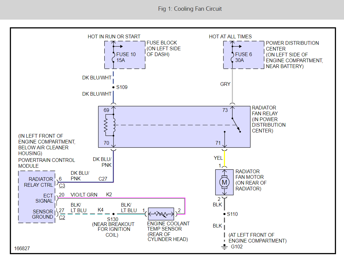

The codes says there is a problem in the circuit. Lets do a pin to pin check on the coolant fan wiring to see what you can find. here is a guide:
Use the wiring diagram above.

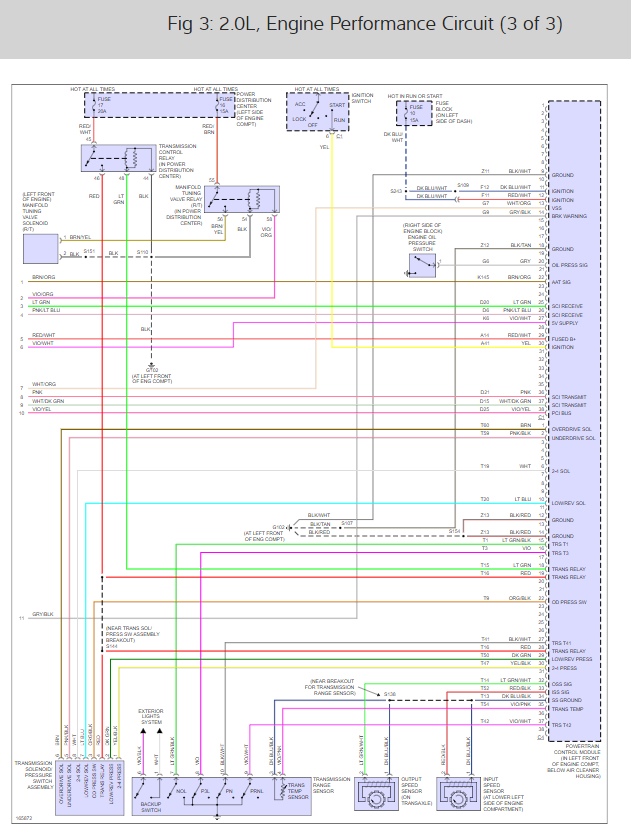

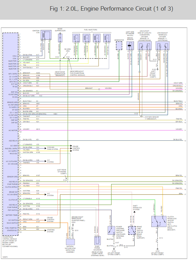

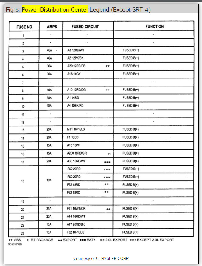

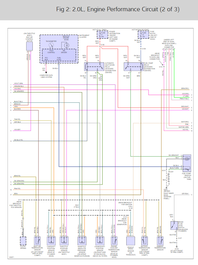

It does sounds like you have a wiring issue. Below are the rest of the wiring diagrams for you.

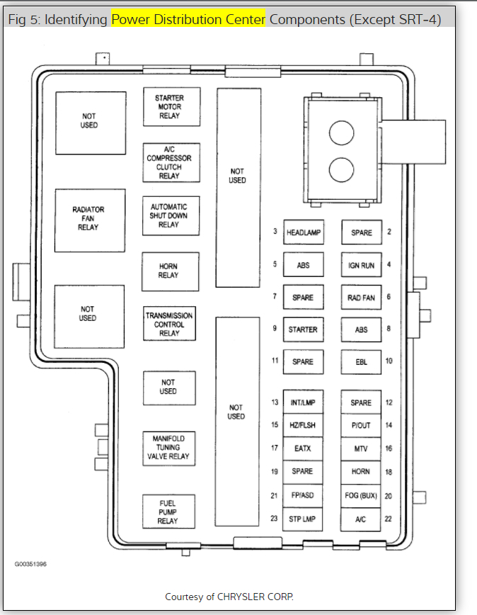

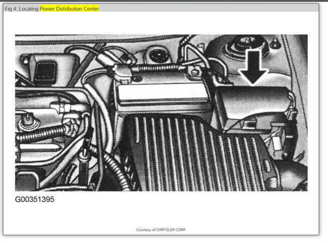

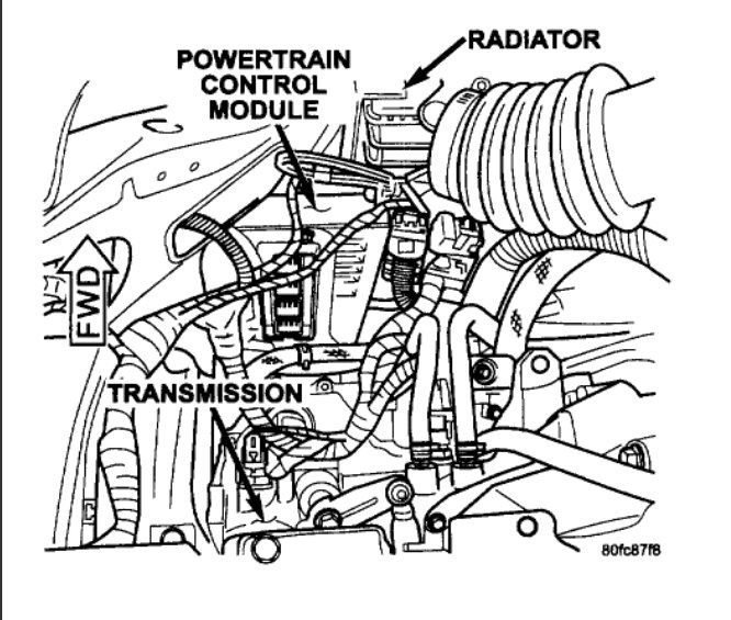

The computer runs the fans, it sounds like its having a problem with the coolant fan control driver inside the PCM. If you checked the wiring I would try swapping the PCM out with a used one to see what happens. Here is the location.
