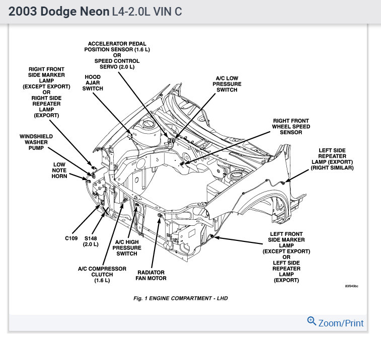

It sounds like the AC system can be overfilled causing the high pressure sensor to kick on the fans. Here is a guide to help us confirm the issue. When you remove the high pressure sensor wiring connector does the fan stop. Here is the location:

Sorry for the long delay. Son's been driving it as is for the last 2,000 to 3,000 miles. AC has been checked as well. Could it be related to the RF filters on the fan motors? I am getting close to just putting an adjustable fan controller on it lol. I love to troubleshoot though!

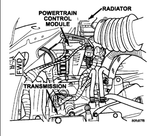

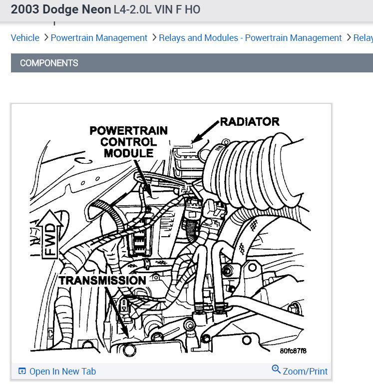

Yep its fun trying to get to the solution. It sounds like the PCM is bad telling the fans to run all the time. I would try a used unit to see what happens. Here is the location. Let me know.

I have tried two different PCM's in it a while back and both exhibited the same symptoms.

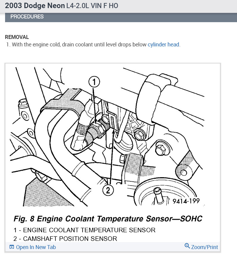

It has got to be the wiring or the coolant sensor then. Here is a guide and the sensor location:

I will double check the wiring, but I have replaced the sensor and the connector and the gauge is reading correct on the dash. Would that matter?
