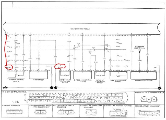

Okay, so I was finally able to test the wiring and it has two wires running to it. One runs directly to the computer it got 5.03 volts. The other wire runs to the throttle position sensor. The one that runs to the TPS had no voltage but it had continuity. All other wires to the TPS had around 5v to them.
Shouldn't that wire running from the TPS have voltage to it also since according to the wiring diagram it has a wire running directly to the computer? I attached the picture and circled and drew around the wire I am referring to.

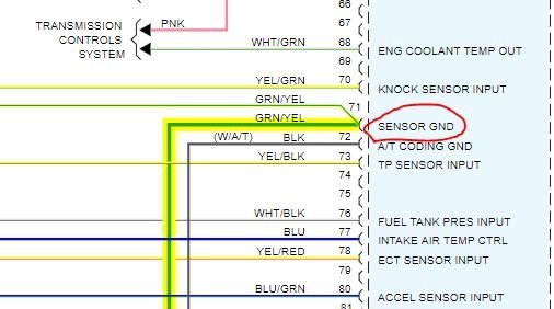

Is the wire you are referring to green and yellow? If it is, that is a sensor ground for several different sensors, and it does run to the TPS. That's why you have continuity. See picture 1. If it is a different color, let me know.
Now, what the heck is causing the code you have. The voltage is great, you have ground, the sensor is new, so why. I know you replaced the connector. Is there any chance when you attach the sensor that another wire is making contact and shorting to power?
