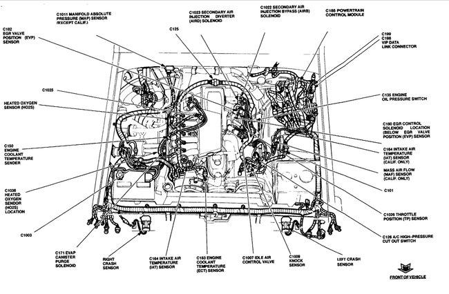

The temperature gauge on the dash recently stop working. I want to replace the coolant temperature sensor thinking this might fix it?
It does sounds like the coolant temperature sensor is bad here is a guide to show you what you are in for when doing the job and I have the coolant sensor locations below.

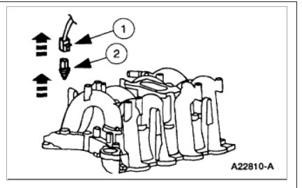

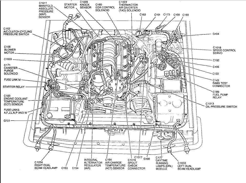

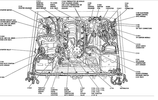

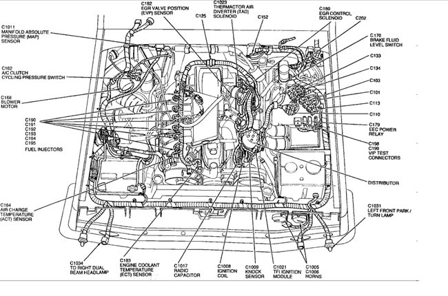

Where exactly is the heat sensor located at on the 5.0 302 engine. Also, what if anything can cause it to seem to never register a temperature when start. is there anything else that can cause it to not show movement while running or after it has been driven for a long period of time? please give me all items that can benefit stronger acceleration or at least to what it should be. thank you very much.
May 6, 2021 at 11:59 AM
(Merged)
You must be talking about the engine coolant temperature sensor located on right front side of intake manifold.

Thank you brother, truly appreciate your time and the picture that shows me so much.

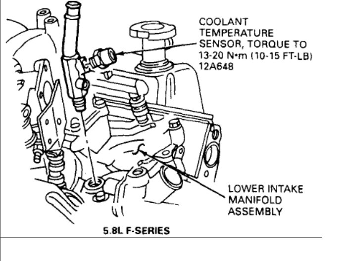

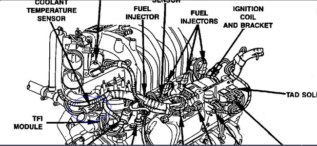

Having a hard time finding the ECT sensor on my truck. The engine is a 351w (5.8L) from a 1989 F150. Do I need to remove the throttle body to access it? Thank you, and sorry if I'm asking a question that has already been answered.
Jun 5, 2021 at 9:07 AM
Good evening,
No, you can access it under the throttle body.
I enlarged a picture for you to view of the location. Release the tab holding the connector to the sensor. Then you will need a 19mm deep socket to attach to the sensor. Then you can remove it.
https://www.2carpros.com/articles/coolant-temperature-sensor-cts-replacement
I would drain some coolant from the radiator so you do not leak a lot when you remove the old sensor.
https://www.2carpros.com/articles/coolant-flush-and-refill-all-cars
Image (Click to enlarge)
Professional Diagram for 2CarPros Members
Click here to log in and view diagram.
Jun 5, 2021 at 9:33 AM
Thank you, Roy! Much appreciated. To be clear, I'm looking for the sensor that communicates with the PCM (computer), not the gauge on the dash. Seems that's the one in the picture, just want to be certain. Thanks again!
Jun 5, 2021 at 9:40 AM
That is the correct one for the ECM. It is a thermistor that sends a varying voltage to the ECM and that is what the ECM bases the fuel mapping.
