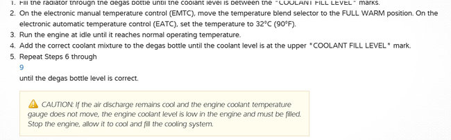

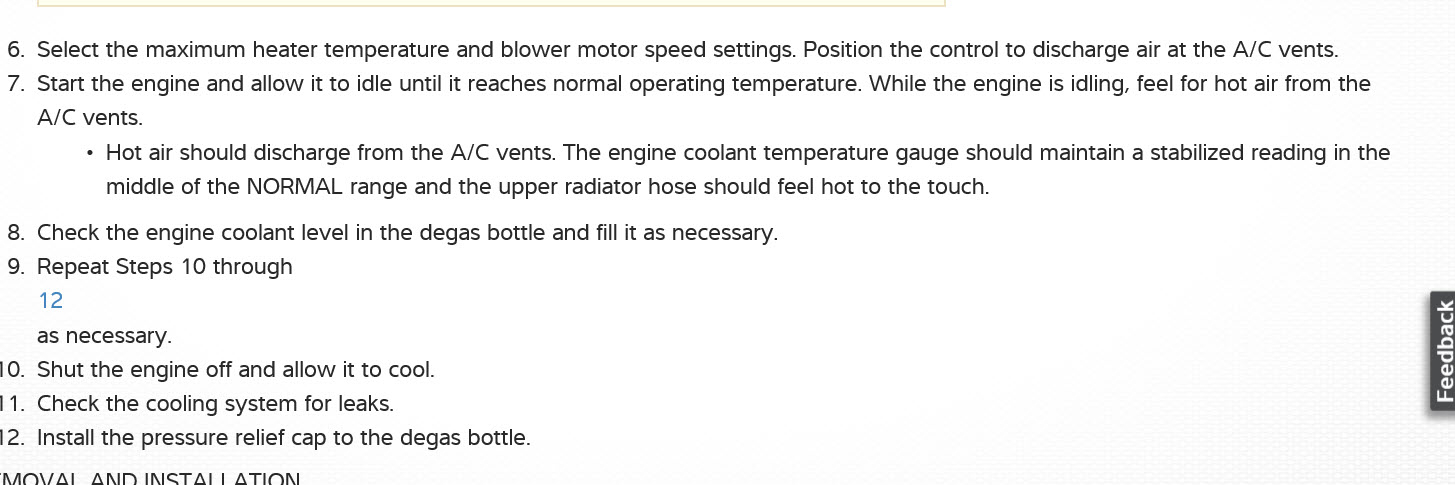

I just changed the heater core in my truck and heater core hoses are cold and fluid is rising in the overflow. I am trying to bleed the air, I do not see any bleed screws. What is the best way to bleed the system? Thanks!

see pictures for bleeding system.

Should this process be done with radiator cap on or off?
Sep 22, 2016 at 2:53 AM
J.STIEG
  • 361 POSTS
Should this process be done with radiator cap on or off.
HMAC300
  • 48,601 POSTS
with it off then install cap after it says right in instructions.
