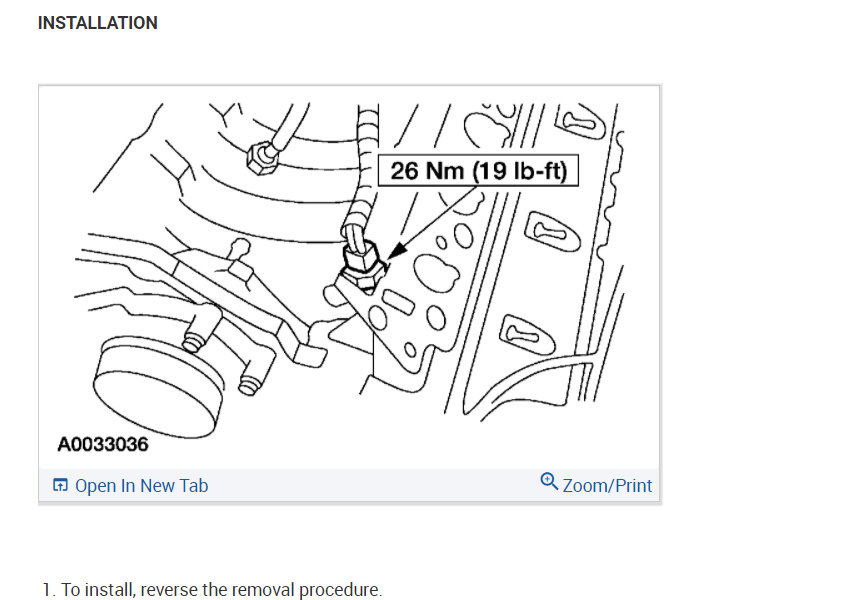

Coolant temperature sensor location for replacement?
2004 FORD F-150
22,200 MILES • 4.6L • V8 • 2WD • AUTOMATIC
JFIRTH

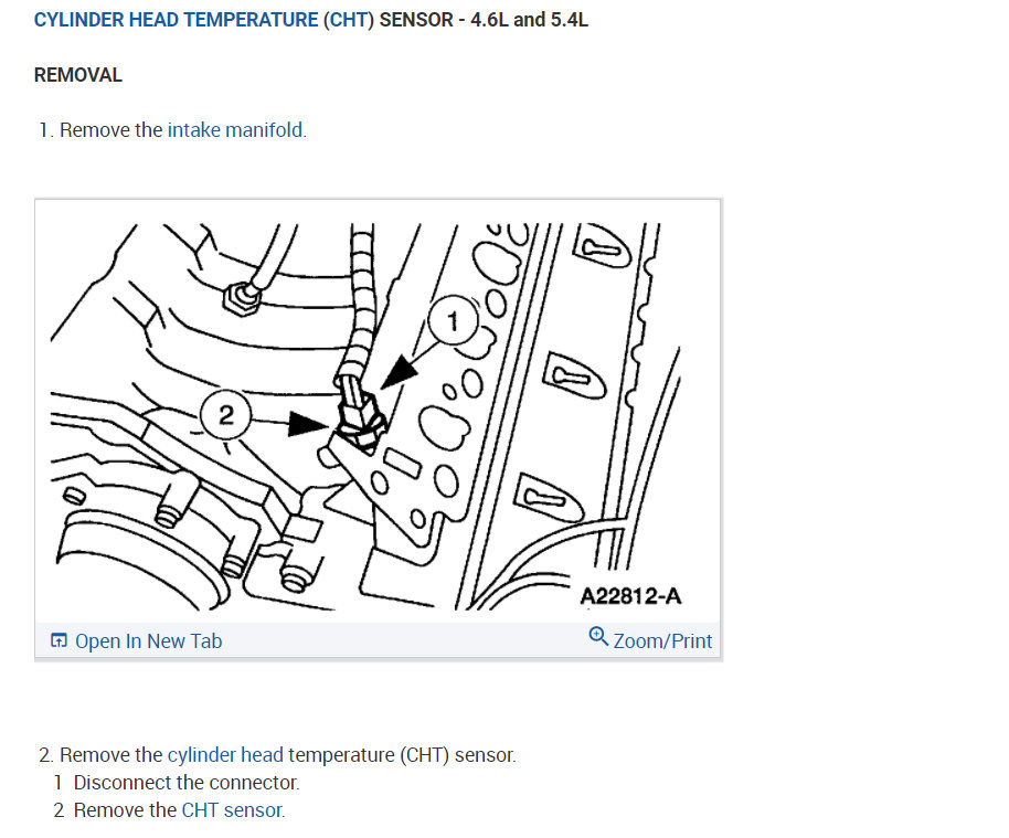

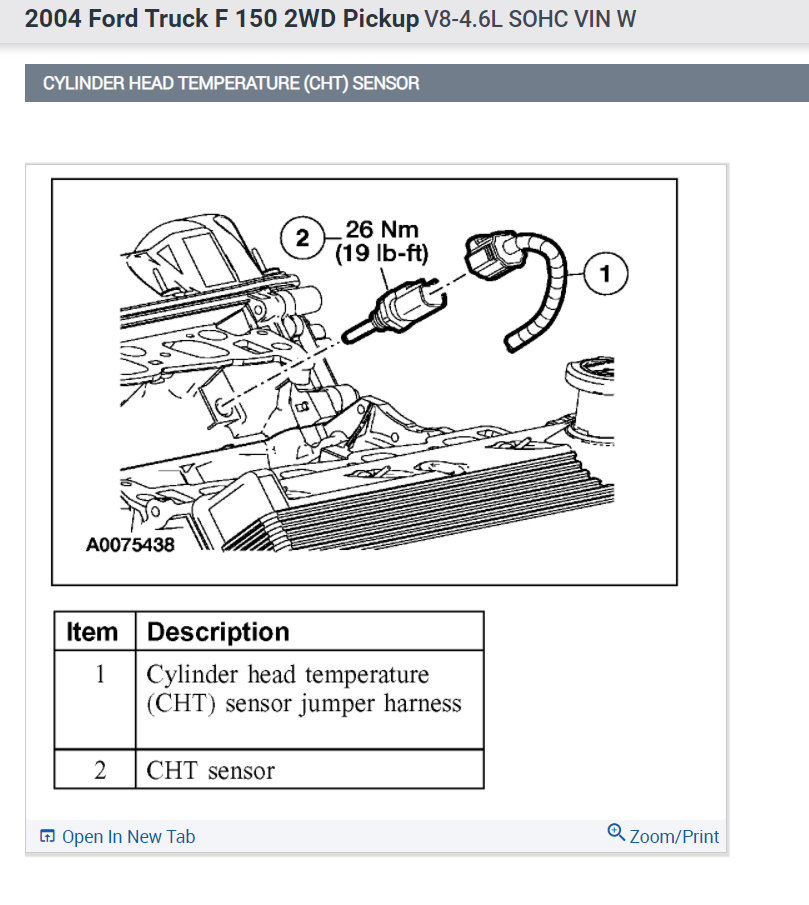

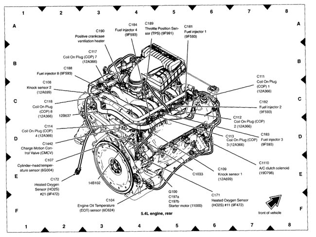

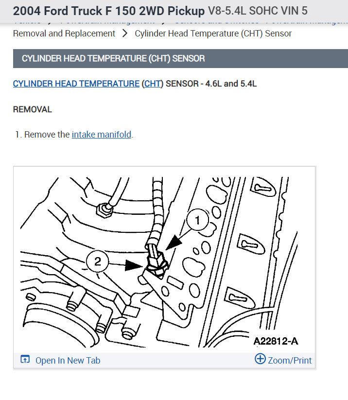

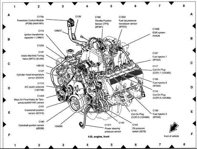

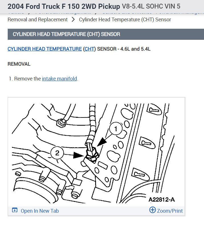

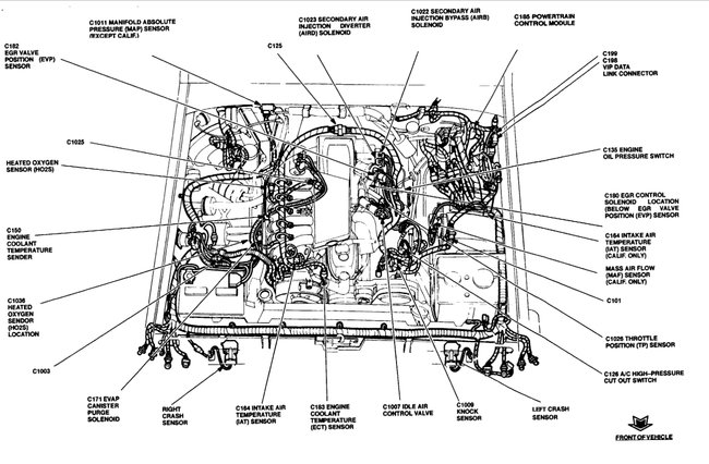

Does my truck have a coolant temperature sensor?
Apr 11, 2018 at 5:53 PM
Good morning.
It is located on the driver side head at the front by the alternator under the intake manifold. Here are both location in the diagrams below it is a two wire sensor that just screws into a coolant passage. The diagrams and instructions below to show you how on your car. Check out the diagrams (Below). Please let us know if you need anything else to get the problem fixed.
Apr 11, 2018 at 8:57 PM

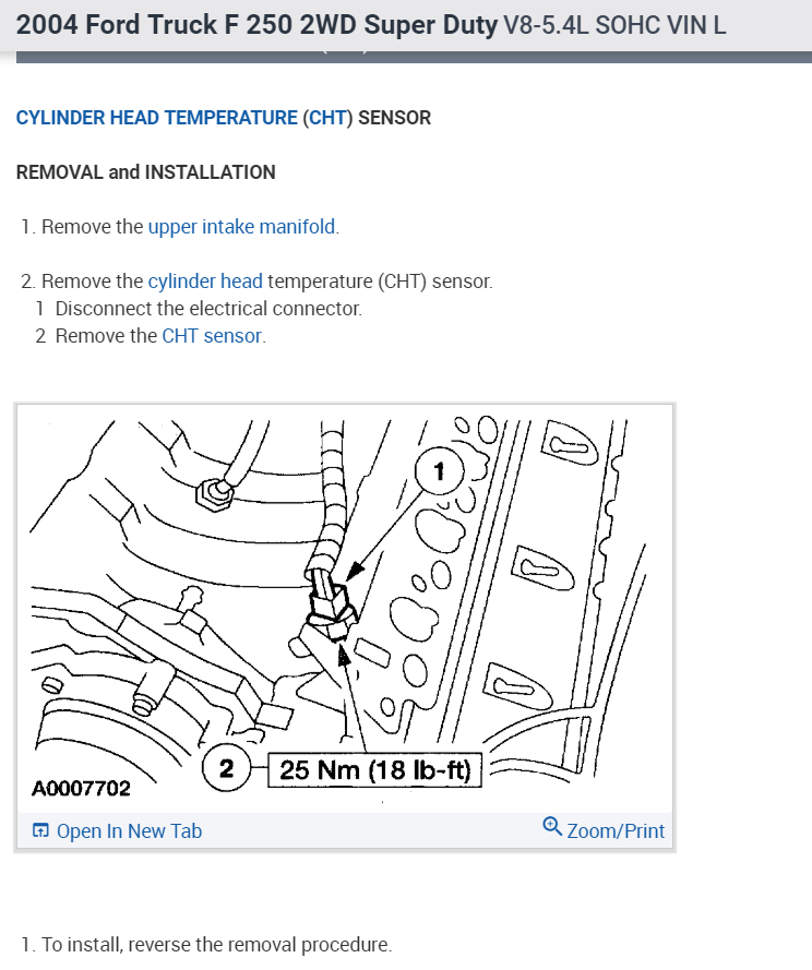

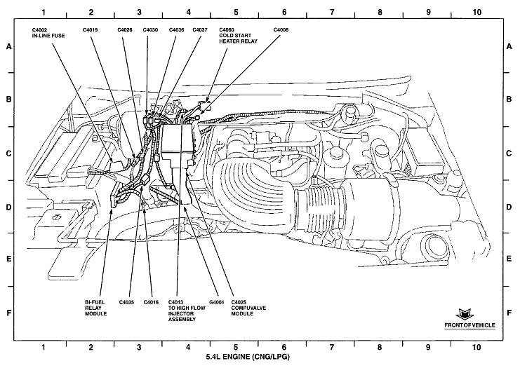

Where is the coolant sensor located? It is a 5.4 engine. Thanks
May 6, 2021 at 11:57 AM (Merged)
  • 55,399 POSTS

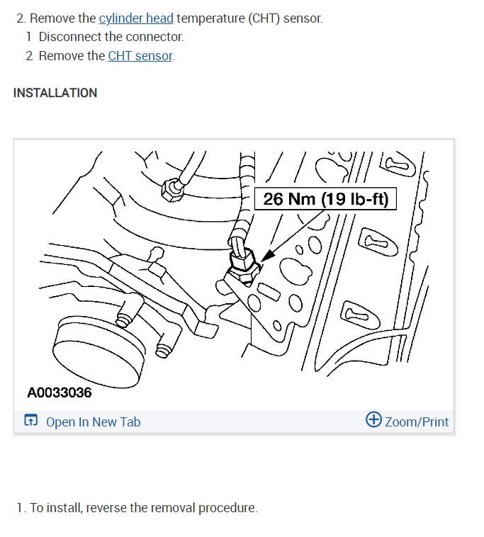

The engine coolant sensor is located near the front of the engine on the drivers side. Here is a guide that will give you an idea on what you are in for when doing the job.
https://www.2carpros.com/articles/coolant-temperature-sensor-cts-replacement
Here is the diagram (BELOW)

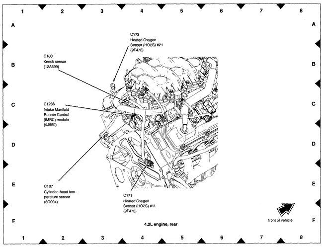

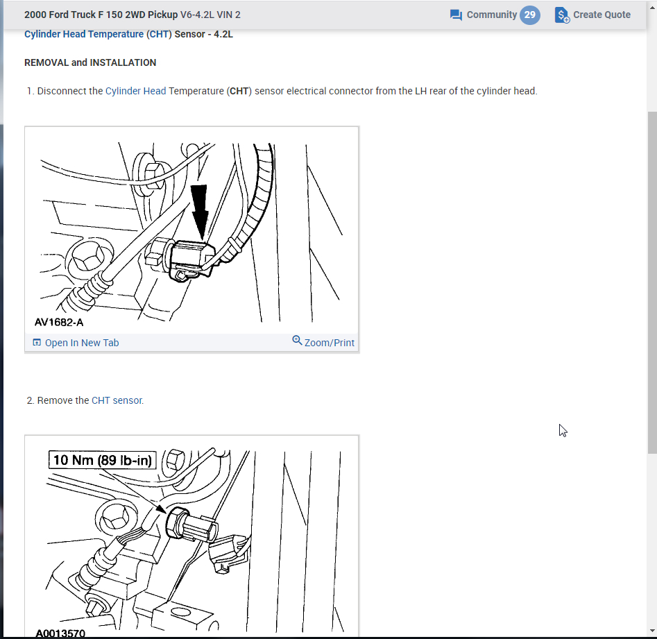

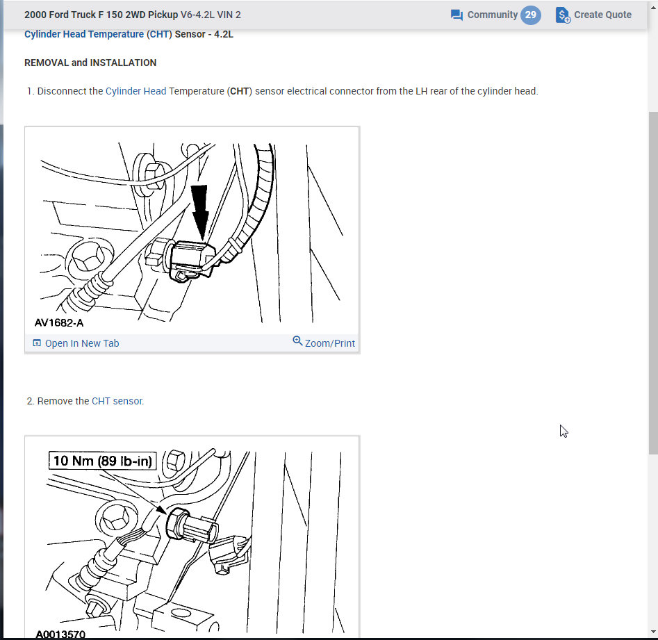

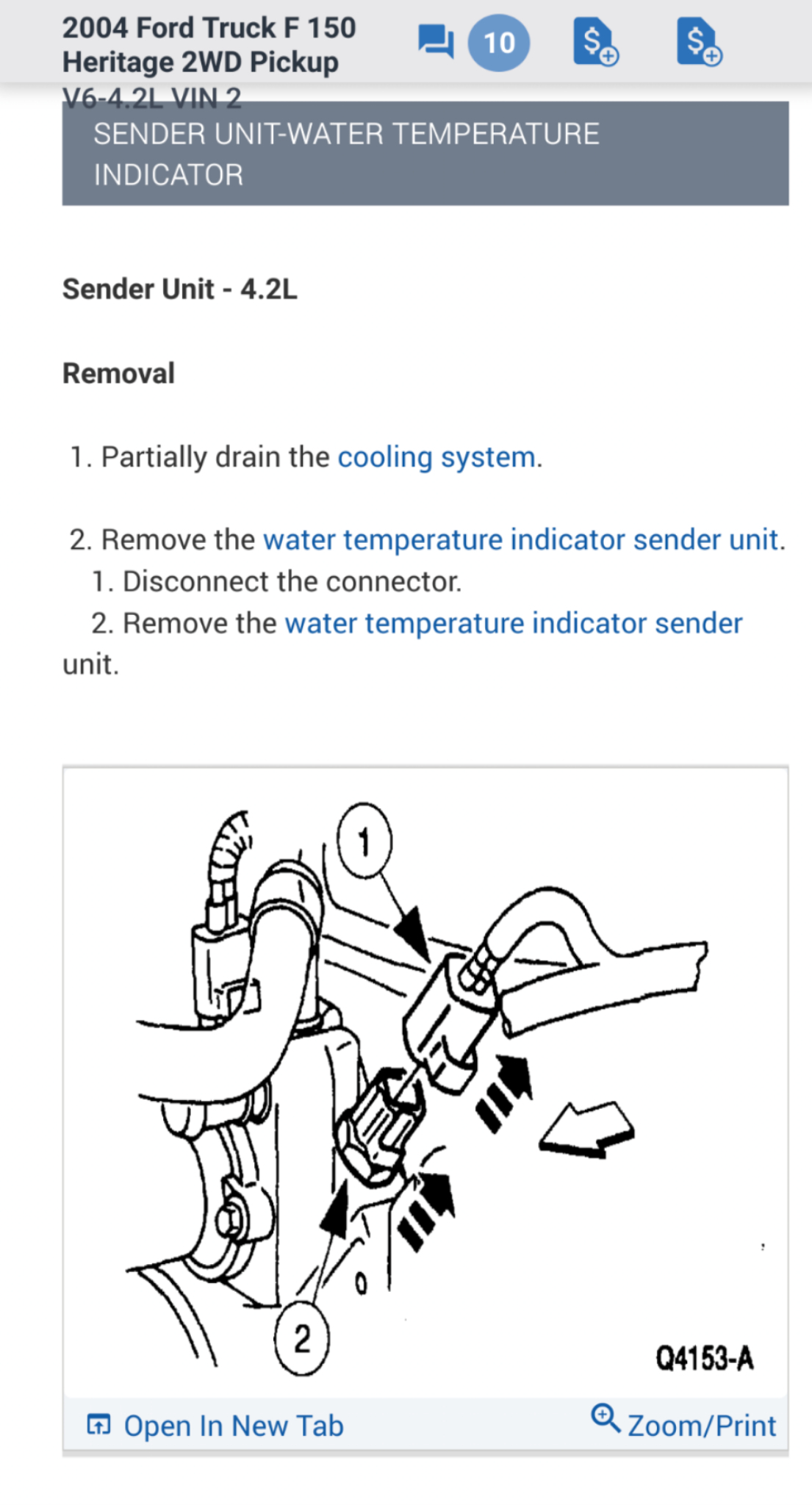

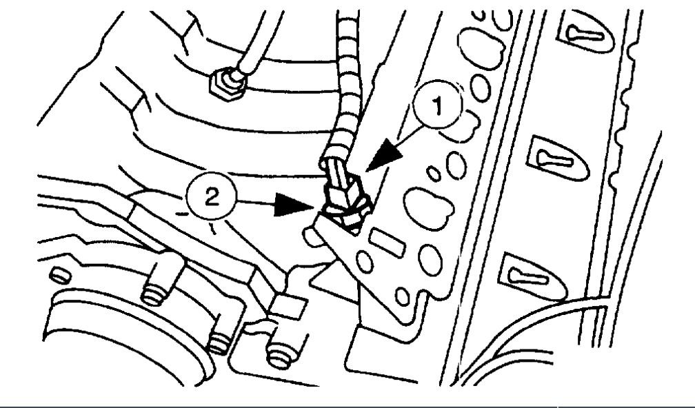

I need to find the location ECT on a 2004 ford f 150 xl Heritage v6 . i read on 05 and up there 2 ECT . I keep looking up ECT, all i find is V8 engines locations , i need location for the ECT 4.2L V6 and is there 2 ECT for this V6 ? if possible can I get a picture of the location or image. thank you for your time.
May 6, 2021 at 11:58 AM (Merged)
HARRY P
  • 2,292 POSTS
Hello. I'm Harry. I've dug around and I think I've figured out the source of the confusion. Ford calls it a Cylinder Head Temperature Sensor while AllData goes back and forth between that name and the more generic Engine Coolant Temperature Sensor. That seems to make it appear that there are 2 such sensors. What I've uncovered is that there is just the one sensor. I'm including the requested information in the attached images.
Hopefully that should shed light on what you're trying to do. Good luck and let us know how it goes.

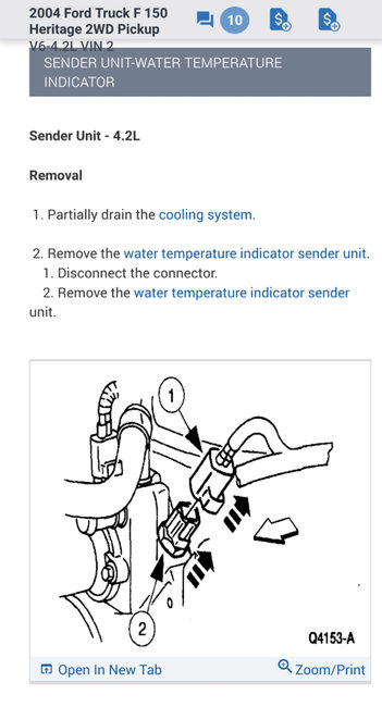

JRFINDS
  • 23 POSTS

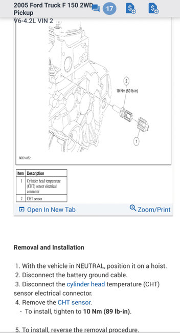

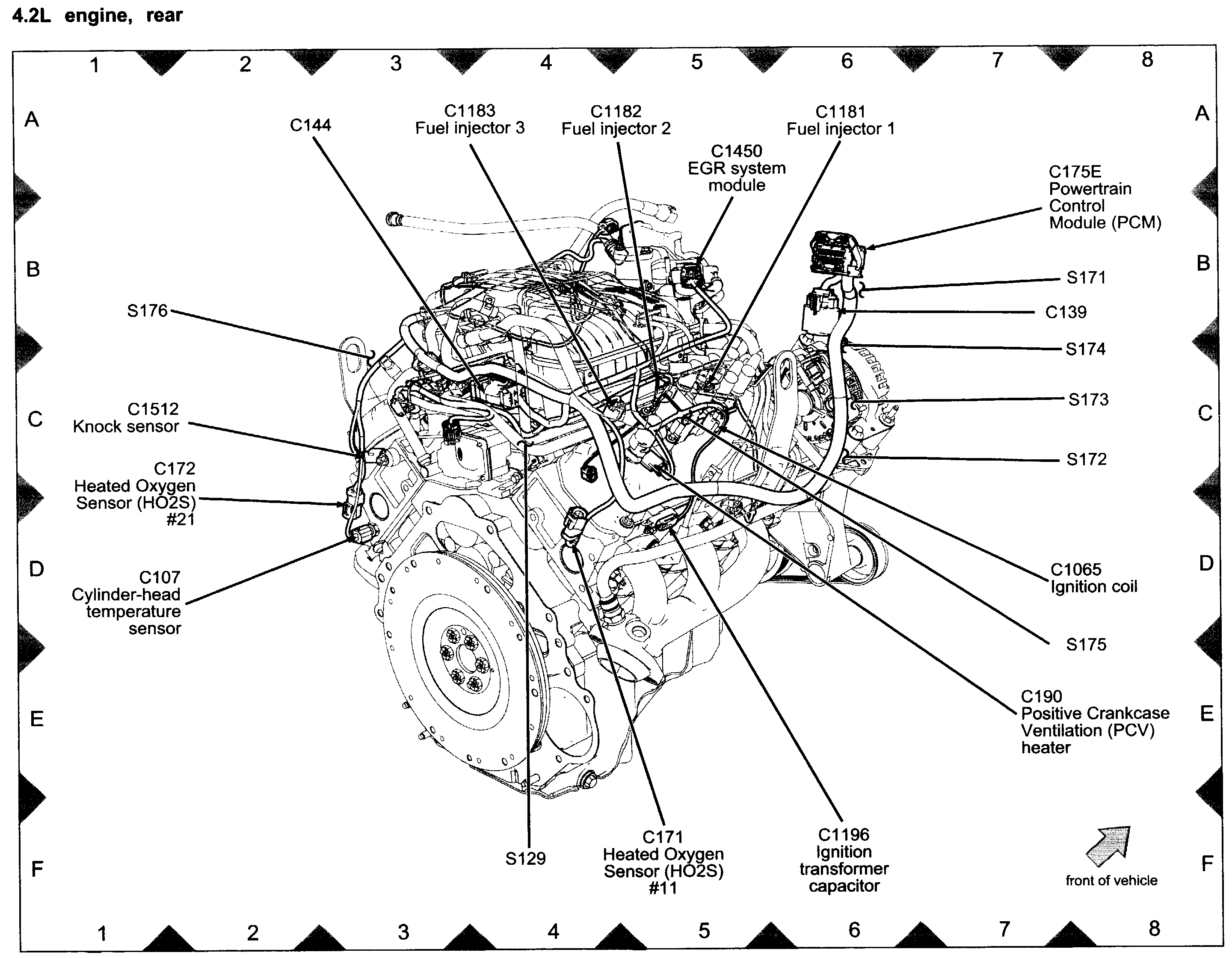

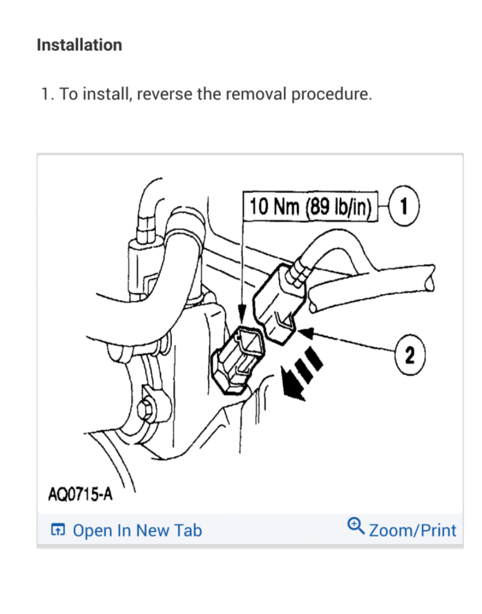

Ford explorer has (2006) has two sensors the second is located on the passenger side block, and nobody seems to know a thing about it including ford parts.
This is for the 2004 Ford 4 Doors f-150 heritage xl 4.2l V6 ?, The first image is 05 right and the second image I believe is the 04 right. I just wanted to Thank you for helping so fast. That's sensor is on the driver side right.
JRFINDS
  • 23 POSTS
Just check my truck. Thank you again I got it now!
HARRY P
  • 2,292 POSTS
Hello again. Sorry about that. Guess I clicked the wrong year and didn't catch it. Good news though it's that the information does still apply. I looked up the 2004 truck and am attaching the info in case someone else needs it and comes across this thread.

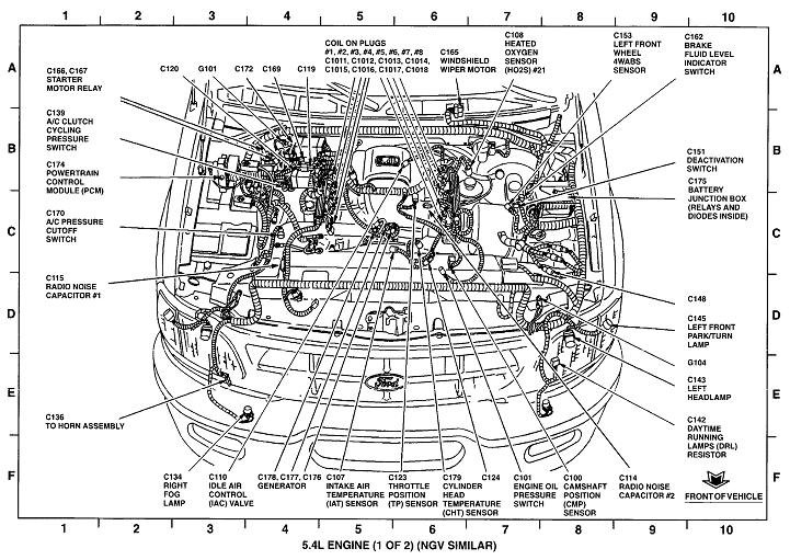

BENSTER30

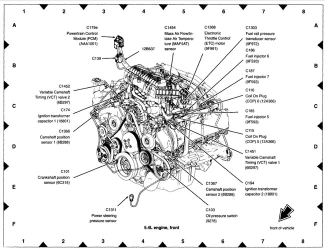

need to find the location of the temp sending unit. my check engine light is on due to this sender not functioning correctly. 2004 f150 new style and mine is on the front of the engine block on the bottom. Seems like mine is a 2004 1/2. Like to have never found it and they kept trying to sell me the wrong one. It is smaller than the parts house tried to sell me. It is underneath, bind radiator on front of block.
  • 55,399 POSTS

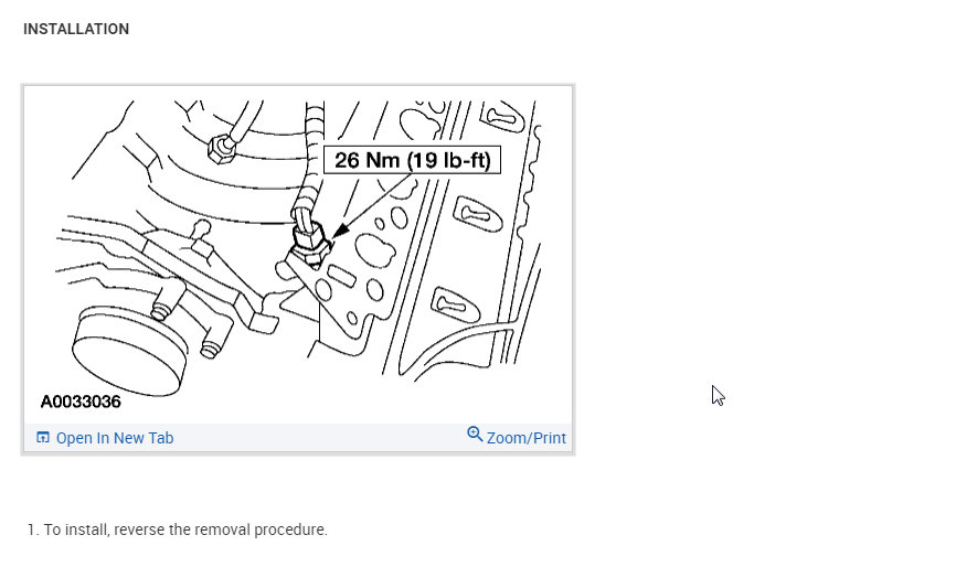

The coolant temperature or cylinder head temperature sensor is located near the rear of the engine, Here are some diagrams (below) that will show you where they are.
This guide will help you see what you are in for when doing the job step by step.
IMAGES OF THE SENSOR LOCATIONS CLICK BELOW. Please let us know if you need anything else to get the problem fixed.

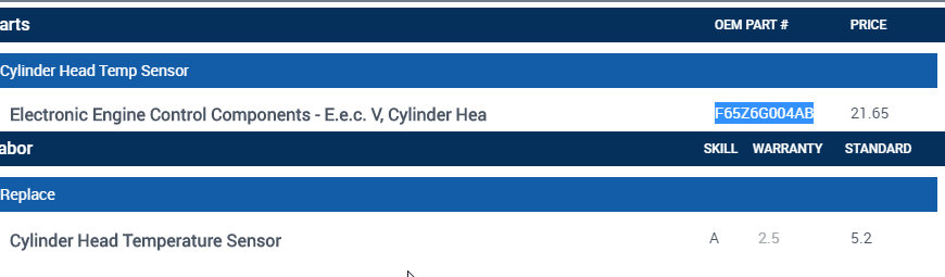

WRENCHTECH
  • 20,761 POSTS

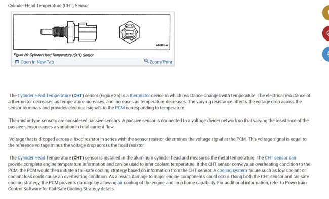

It uses the info from the main temp sensor called the Cylinder Head Temp sensor and gets the data from the PCM. https://www.2carpros.com/images/external/111932279.gif

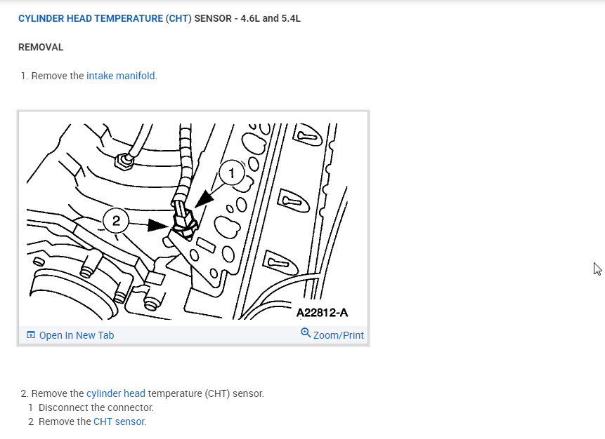

THOMAS.VIGIL

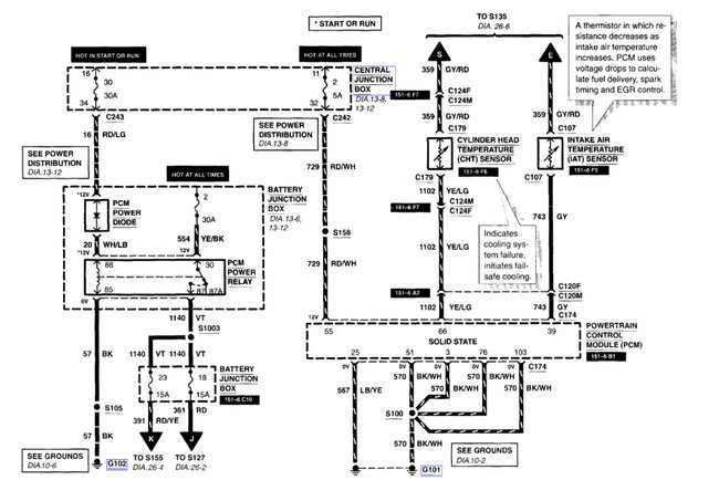

I can't find the Coolant Temperature Sensor (CTS) on my truck listed above. I know where the Cylinder Head Sensor (CHS) is and all the information I have found is not distinguishing the difference between the two sensors. Does this truck actually have a coolant temperature sensor or sending unit that controls the coolant temperature or is something else controlling the coolant temperature gauge?
Good afternoon,
The cylinder head temperature sensor is for the gauge. I attached the procedure and an explanation for you of the sensor and what it controls.
https://www.2carpros.com/articles/how-a-coolant-temperature-sensor-works
WASHGUY
Computer said my coolant temperature sensor was bad. I purchased one. Have looked at many diagrams for location. I removed alternator and took out sensor behind thermostat housing and below about a foot towards center of motor. Have done small jobs before but cannot find this one. Thanks for help!! The sensor I took out is much smaller in diameter at the threads than my new one.
Just make sure you got the correct sensor and am looking in the correct location. I have run into this many times with people not getting the correct sensor. This engine has a Cylinder Head Temperature sensor and a lot of stores will not look this up correctly.
CARADIODOC
  • 34,378 POSTS

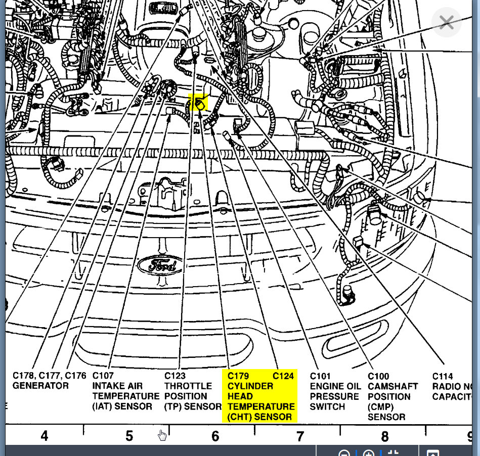

There's a whole bunch of problems here. The first one is there is no drawing that shows the location of the coolant temperature sensors. There is a cylinder head temperature sensor indicated at the bottom / center of the first drawing. They do make reference to two other coolant temperature sensors, but they aren't even shown on the electrical diagrams. At this point I can't show you were they are, but you will usually find them close to the thermostat housing at the end of the upper radiator hose. On V-type engines, you might also find them on the intake manifold. With inline engines, they might be found on the side of the block.
The next problem is there are usually two of them. One is for the dash gauge and will have just one wire connected to it. The other is for the Engine Computer and will always have two wires. Ford did have a lot of trouble with the two-wire sensors in the early to mid '90s, but other than that, temperature sensors have an extremely low failure rate because there's just one component inside them. It's much more common to find spread or corroded connector terminals that aren't making a solid connection.
The last concern is the diagnostic fault code did not say to replace the sensor or that it was bad. Fault codes never say that on any brand or model. They only indicate the circuit or system that needs further diagnosis, or the unacceptable operating condition. First we have to rule out wiring and connector terminal problems associated with that part. Also, there are many fault codes that can be set related to temperature sensors, and they mean very different things. What was the exact fault code number you're diagnosing?

Hi KASEKENNY1. Looks like we found the same diagrams.

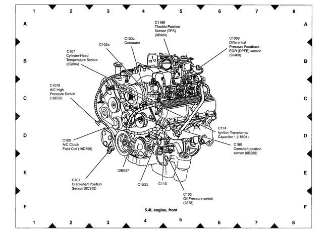

I can't seem to locate the ECTS on my engine.. help?

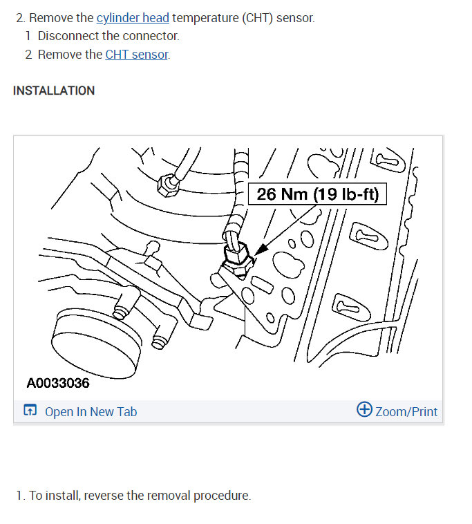

This is not uncommon on these engines. The reason is, it is called a cylinder head temp sensor so when you are searching for it under ECT sensor in any manuals it doesn't pull anything up.
Here is a guide that will help with this in general:
Below you will find the process from the manual on this. let us know if you have other questions. Thanks

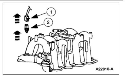

your vehicle uses a cylinder head temperature (CHT) sensor and it should be on the top front of the engine or maybe left side of engine if for the 4.2L engine.
Here is a guide to help you see what you are in for when changing it out.

The Cylinder Head Temperature (CHT) sensor:
is mounted into the wall of the cylinder head and is not connected to any coolant passages.
sends a signal to the powertrain control module indicating the cylinder head temperature.
if the temperature exceeds 126°C (-258°F), the powertrain control module disables four fuel injectors at a time. The powertrain control module will alternate which four injectors are disabled every 32 engine cycles. The four cylinders that are not being fuel injected act as air pumps to aid in cooling the engine.
if the temperature exceeds 154°C (310°F), the powertrain control module disables all of the fuel injectors until the engine temperature drops below 154°C (310°F).
DTCs are set.
If the engine reaches critical temperature, the following happens:
The coolant temperature gauge pointer will read fully hot at 121°C (250°F).

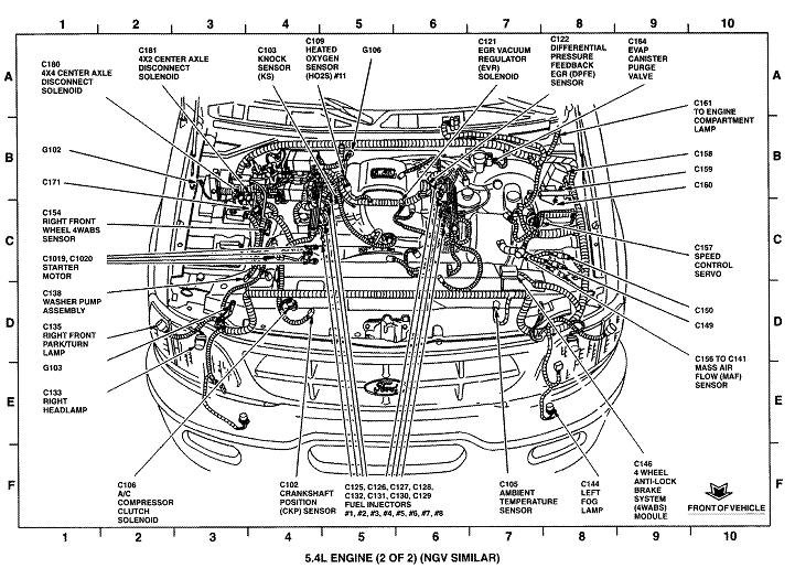

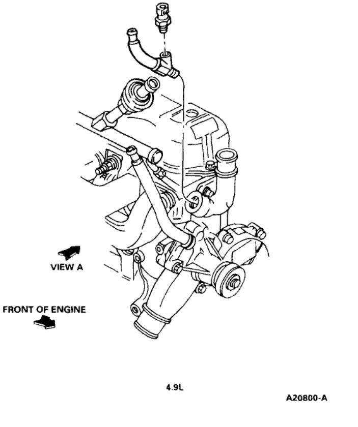

I bought a new switch today form NAPA, and am having trouble finding it. Any ideas? I have the Haynes book, it says right rear corner of engine block, just below cylinder head. Only problem is that I don't know if by right side, they mean when you're sitting in it, or outside looking at it. I also do not really know what the cylinder head is.
  • 75,992 POSTS
The coolant temperature sensor is located near the front of the engine for both 6 and 8 cylinder engines. Here is a guide to help you see what you are in for when doing the job
Here is the engine coolant sensor location for both engine (below)
Cheers

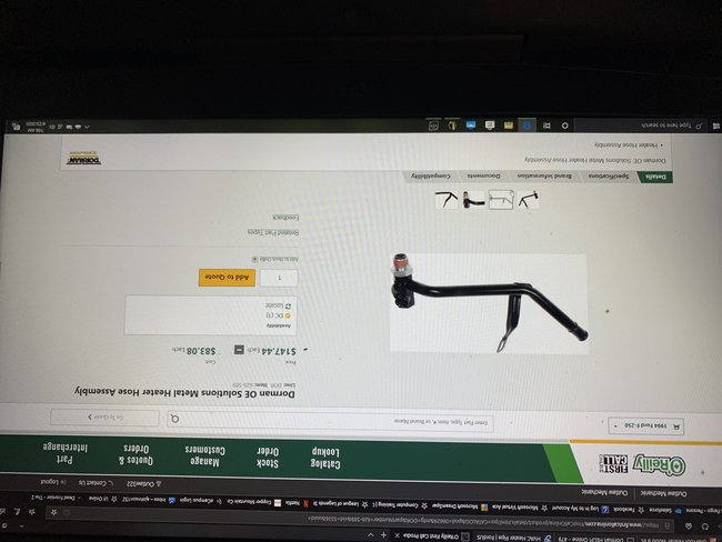

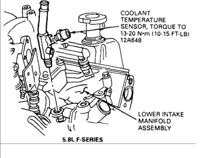

what is the housing called that the coolant sensor is fastened into? My truck has the 5.8l engine. The thermostat housing is on the front of the engine. This is on the top just above it. It houses the coolant temperature sensor and two tubes for coolant coming out of it (the sensor screws/fastens into it has a connector wire running to it) it is octagon in shape and has two tubes brazed into it. Also, one tube about ten inches in length goes into a heater core hose, the other smaller tube and hose goes to the throttle body base. I have a ford parts# its, number 18B402 off of a 1995 Ford 5.8l diagram, cannot seem to locate this part anywhere. No one knows what it is called and when I go to a parts warehouse the number off the diagram comes back as a AC/Delco brake drum. Thanks for the help.

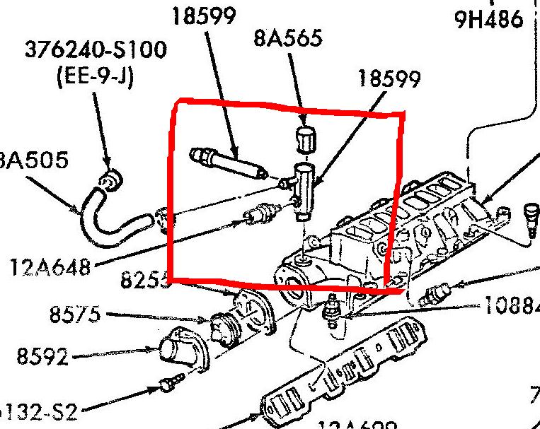

SUWLF
diagram of 1995 Ford F150, 5.8l coolant temperature sensor housing/tower? part number 18599.
SUWLF
part number 12A648 is the coolant temperature sensor, that was no problem finding. part #18599 is the mystery part with no name that i cannot find anywhere. thanks for the help.
ALEXANDER JOHNSON
Hello guys.
If this hasn’t been resolved yet, the part you are referring to is a heater hose assembly. Ford discontinued the part; however, Dorman makes an aftermarket solution you can order and obtain through any O’Reilly Auto Parts.
Take a look at Dorman part number 626-589 and I believe this is the part you are looking for.
Hope you were able to solve your problem.
