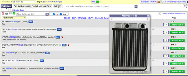

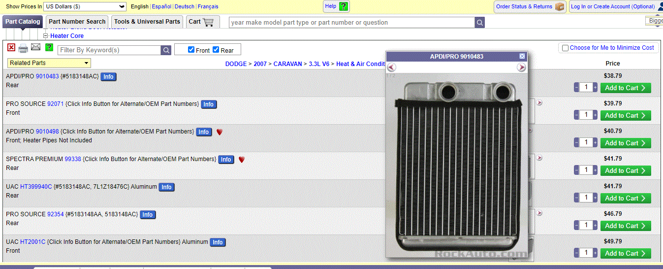

Coolant system fluids are leaking from the A/C drain port from the fire wall inside engine compartment. I have already replaced the heater core followed by the water pump. Pump was bad, heater core seemed to be fine. This vehicle does have rear compartment heating and cooling. All online searches point to heater core. What else is a possibility?

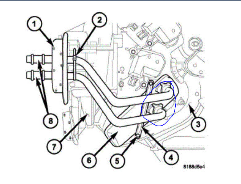

The heater core is the reason for coolant leaking from the A/C drain hose.Since you have the tubes from the firewall to the heater core, those tubes may be the leak. Look carefully at the connections.

WARNING: The heater core tubes are not serviced separately from the heater core. The heater core tubes should not be re-positioned, loosened or removed from the heater core. Failure to follow this warning could result in a coolant leak and possible personal injury or death.
NOTE: LHD model shown. RHD model similar.
1. Disconnect and isolate the negative battery cable. See: Battery > Service and Repair
2. Remove the HVAC housing from the vehicle and place it on a workbench. See: Housing Assembly HVAC > Service and Repair
3. Remove the foam seal from the heater core tubes and the flange located at the front of the HVAC housing (Figure 1).
4. If equipped, remove the plastic retaining strap that secures the heater core tubes to the flange.
5. Remove the two screws that secure the heater core retaining bracket to the driver side of air distribution housing and remove the bracket.
6. Disengage the heater core tubes from the flange while carefully pulling the heater core straight out of the side of the air distribution housing.

Yes, I did replace the heater core. The used one looked as good as its replacement. There was no evidence of leakage at the sealed locations. Are you saying the tubes coming from the heater core may be faulty some how? Where and how do they intersect? The heater core tubing and the ac drain port. (head scratcher)

One end is where the hoses from under the hood connect.
https://www.2carpros.com/articles/car-is-leaking-coolant
The other is the heater core.
I would pressure test the system and inspect the tubes and the core for any leak. The leak should be evident under pressure.
https://www.2carpros.com/articles/radiator-pressure-test
You can rent a tester at a parts store.
