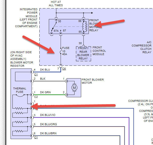

AC FEELS COLD BUT NOT BLOWING
2007 DODGE CARAVAN
139,000 MILES • 2.4L • 4 CYL • AUTOMATIC
JMONTOYA
FOR THE LAST MONTH SO MY AIR CONDITIONER WOULD STOP BLOWING THE AIR THROUGH THE VENTS. I CAN FEEL THAT THE AIR IS COLD. I HAVE NEVER CHANGED THE CABIN AIR FILTER. I AM TRYING TI LOCATE IT NOW. AT TIMES WHEN I WOULD TAP UNDER DASH ON PASSENGER SIDE THE AIR WOULD START BLOWING AGAIN

check for a loose ground on hvac unit it's an org/blk wire behind lh side of dash. also check blower resistor as there is a thermal fuse there that may be bad. also check front blower motor relay in underhood fuse box.
