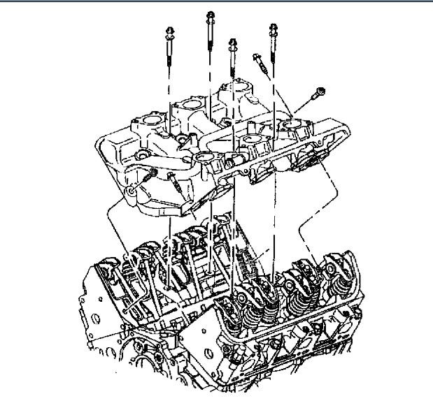

I have a coolant leak somewhere toward the mid to back of the engine the reservoir looses fluid. I get puddles under my car i have checked the reservoir and the oil and the oil is not discolored and I don't see any oil in the reservoir. I have looked at most of the hoses and cannot determine where the leak is coming from. Could this be as simple as the reservoir cap needs to be replaced?
Sep 26, 2019 at 11:58 AM
Good evening,
If the cap was bad, it would leak right from the cap area.
You need to pressure test the system to determine the leak.
https://www.2carpros.com/articles/radiator-pressure-test
Those motors were common for intake manifold gaskets. They leak out the back of the motor and drip on the ground on the drivers side.
https://www.youtube.com/watch?v=rUlBJNK-80s
Sep 26, 2019 at 1:00 PM

Depends where the leak is, 3.1 engines are known to leak at the intake manifold. Pressure test first to find the leak.

About 700.00 or so, but if it was mine, I would pressure test it first, other things can and do leak!

Mine only took $500 when it leaked at the intake manifold.

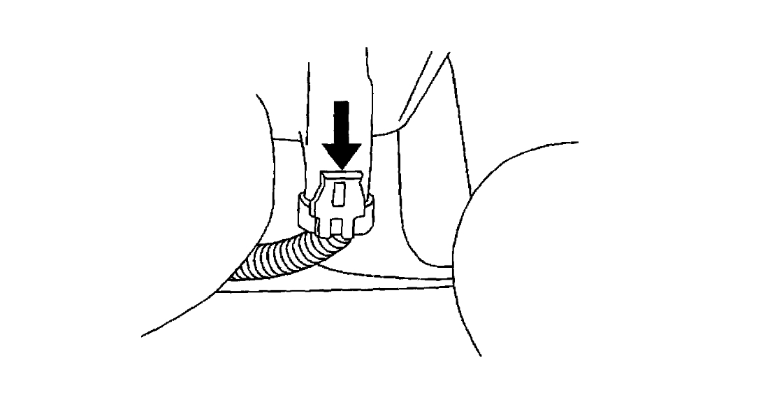

I had a friend replace the radiator reservoir and now the coolant low level light stays on even though the coolant can be seen in the reservoir where it is supposed to be.
Dec 9, 2020 at 3:39 AM (Merged)
Good evening.
Did your friend replace it with a new unit with the switch? There is a sensor at the bottom and needs to check if it is plugged up.
https://www.2carpros.com/articles/coolant-reservoir-replacement
BEVERLY THOMPSON
Hi Roy,
Yes it was bought new, but I am not sure about the sensor; however that sounds like the problem. I will check it out and if it has a sensor, that will be an easy fix. If it does not have a sensor, I will get back to you.
Beverly
