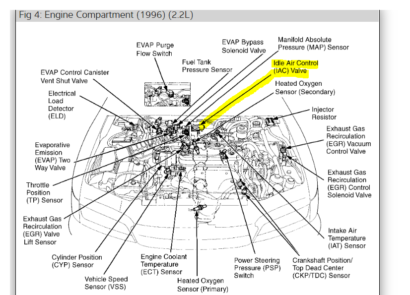

Sometimes will not start, but if I push the gas pedal while starting it'll fire right up. I'm confused. please help.
Apr 26, 2020 at 8:06 AM

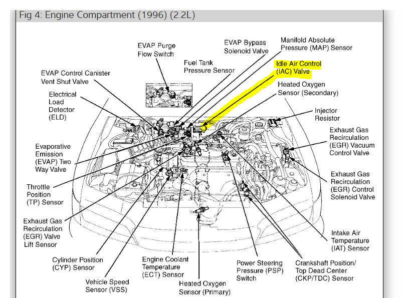

Good evening,

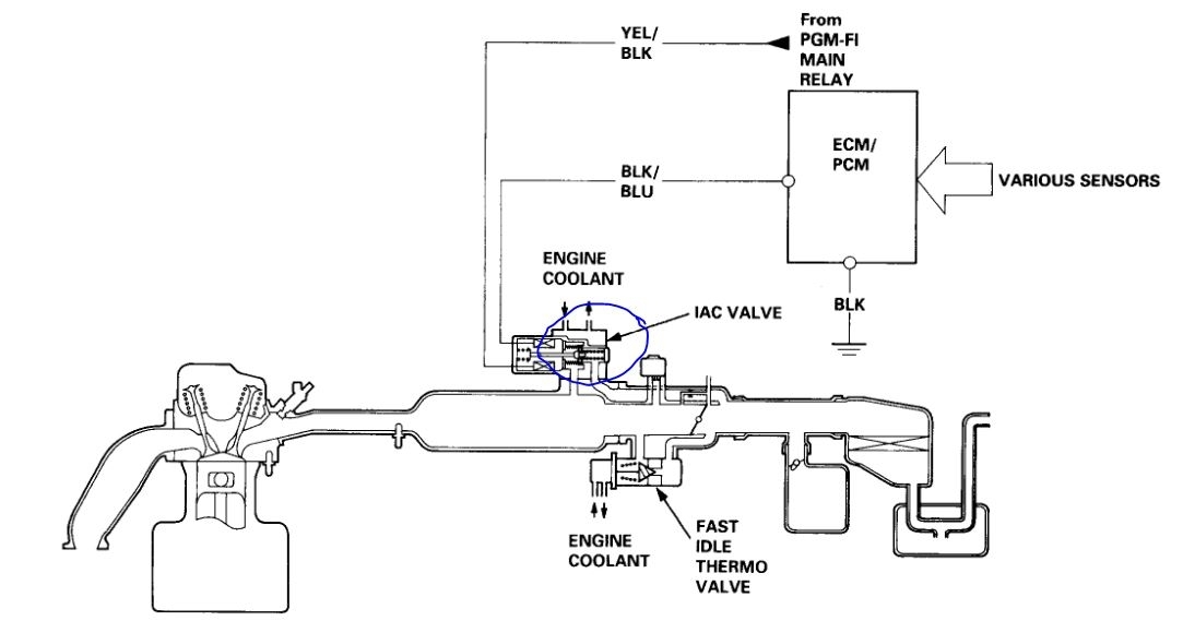

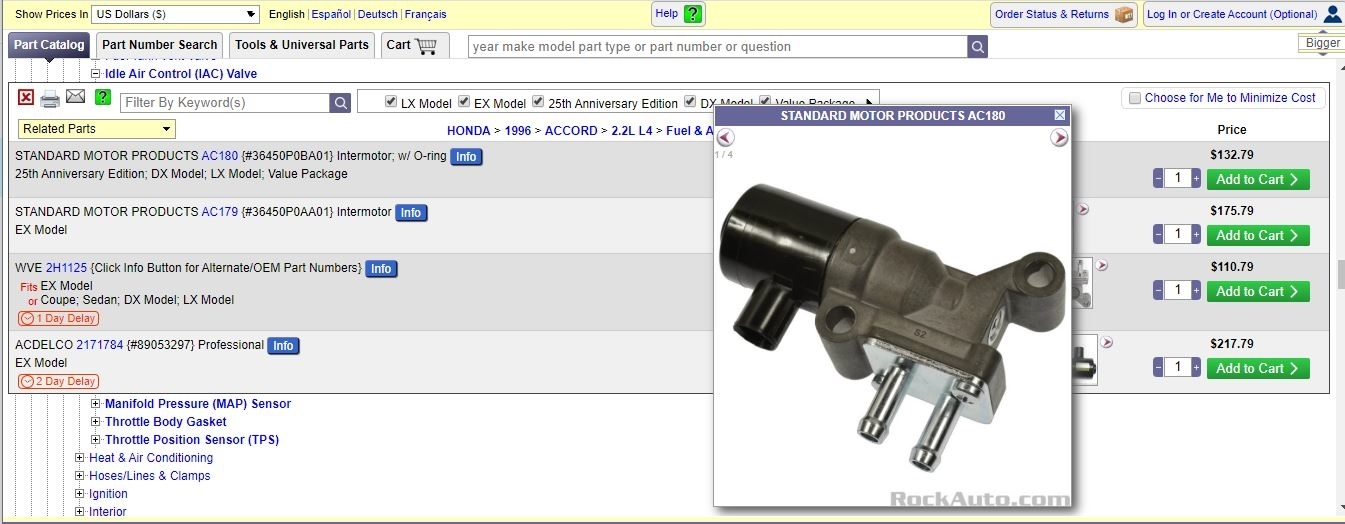

The most likely cause of this is the idle air control valve. It is not sitting in the correct position for starting.
When you inspect it, make sure the bore is clear of all carbon deposits.

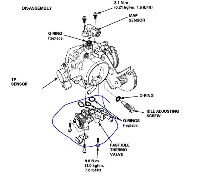

SYSTEM DESCRIPTION
The idle speed of the engine is controlled by the Idle Air Control (IAC) Valve.
The valve changes the amount of air bypassing into the intake manifold in response to electric current controlled by the ECM/PCM. When the IAC Valve is activated, the valve opens to maintain the proper idle speed.
1. After the engine starts, the IAC valve opens for a certain time. The amount of air is increased to raise the idle speed about 150-300 rpm.
2. When the coolant temperature is low, the IAC valve is opened to obtain the proper fast idle speed. The amount of bypassed air is thus controlled in relation to the engine coolant temperature.
3. When the idle speed is out of specification and the scan tool does not indicate Diagnostic Trouble Code (DTC) P0505 or P1508, check the following items:
Adjust the idle speed

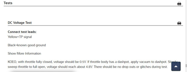

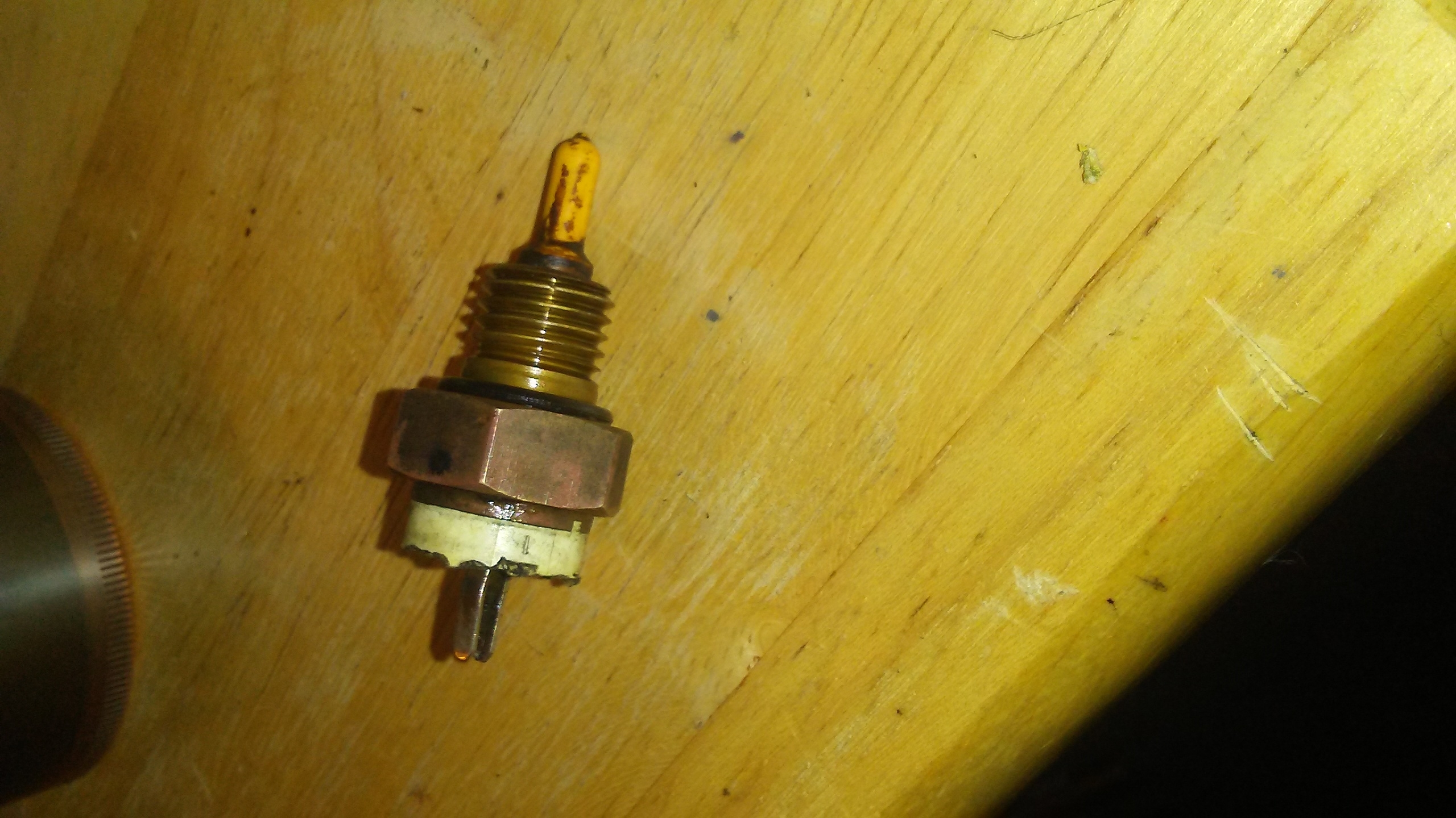

I think I found the problem.. The IAT sensor busted off in the connector somehow.
Apr 26, 2020 at 11:05 AM
Okay, try and see if it takes care of it. That alone should not cause it to not start.
It should also have set a code for that as well.
Did it set a code?

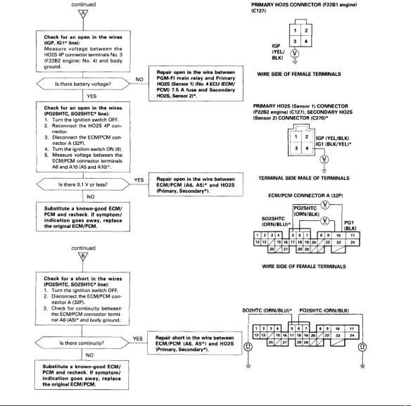

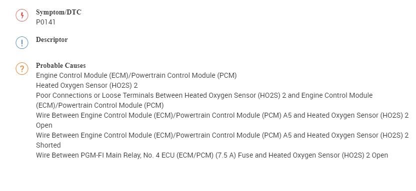

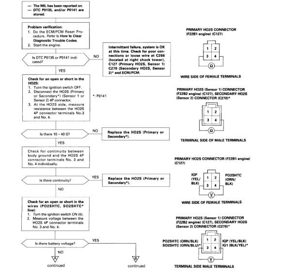

Codes P0113, P0135 and P0141.
Apr 27, 2020 at 12:40 AM

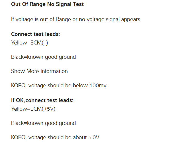

Okay, the 113 is your broken sensor.
The 135,141 are O2 sensor heater codes. I attached some possibilities below along with a flow chart for determining the failure.
These codes are not related to the hard starting either.

Did you follow the flow chart I posted?
Tell me the results of each step?

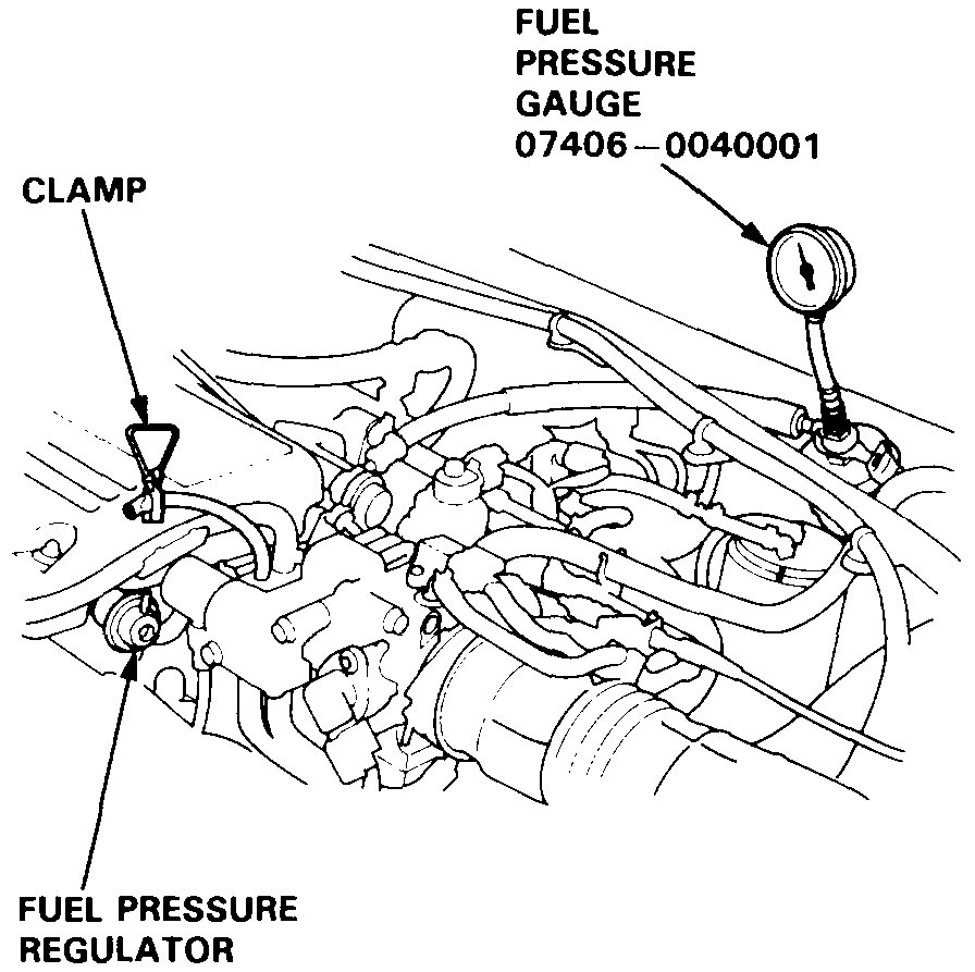

  • 110,248 POSTS
Welcome to 2CarPros
There are many things that can cause this to happen. However, based on your description, I would like you to check if there is spark to the plugs. Here is a link that shows how it is done:
If you find no spark, my first suspect is the crankshaft position sensor. Take a look at this link.
Check to see if there is spark to the plugs let me know what you find.
As far as fuel, yes, it could be related, but usually it's all or nothing with a pump. If you want to check it, here is a link that shows how to check for pressure:
Here are directions specific to your vehicle for testing fuel pressure. The manufacturer's specs are included in the directions. Pic 1 correlates with these directions.
1. Relieve fuel pressure.
2. Remove the service bolt on the fuel filter while holding the banjo bolt with another wrench. Attach the special tool.
3. Start the engine. * Measure the fuel pressure with the engine idling and the vacuum hose of the fuel pressure regulator disconnected from the fuel pressure regulator and pinched.
Pressure should be: 304 - 353 kPa (3.1 - 3.6 kgf/cm2, 44 - 51psi)
See Pic 1
4. Reconnect vacuum hose to the fuel pressure regulator.
Pressure should be: 245 - 294 kPa (2.5 - 3.0 kgf/cm2, 36 - 43 psi)
*: If the engine will not start, turn the ignition switch on, wait for two seconds, turn it off, then back on again and read the fuel pressure.
^ If the fuel pressure is not as specified, first check the fuel pump. If the fuel pump is okay, check the following:
