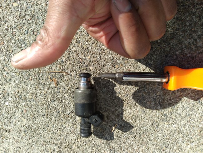

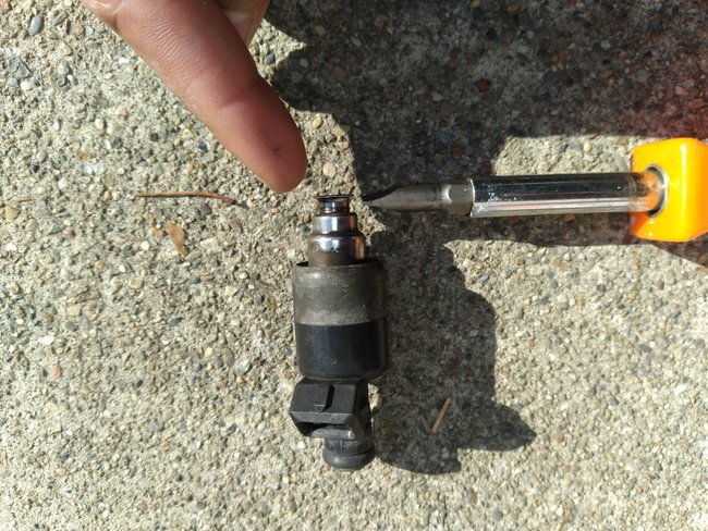

One issue I found is one of my fuel injectors was missing another o ring, but I replaced it!
Sunday, December 20th, 2020 AT 11:58 AM
  • 52,797 POSTS
Good find.
Did you replace them all?
Sunday, December 20th, 2020 AT 5:39 PM
IGENIUS92
  • 205 POSTS
Now just one that gave me issues.
Sunday, December 20th, 2020 AT 7:24 PM
  • 52,797 POSTS
I would replace them all. If one wore out, the others are close behind.
