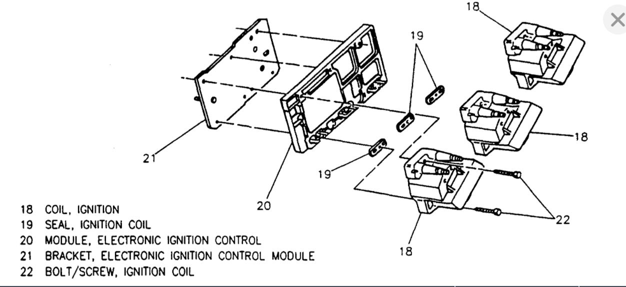

what size are the lug nuts that hold the coil pack plate on?
1997 CHEVROLET CAMARO
155,000 MILES • 3.8L • V6 • 2WD • MANUAL
IGENIUS92
  • 205 POSTS
Hello, I have the car listed above that I'm working on and I need to know what size is the lug nut that came of the coil pack plate? It's two nuts and I lost them. I think I took a 13mm to get them off but to replace them what size is the thread? Not the bolts on the coil packs but the two lug nuts that hold the coil pack plate on.
Nov 10, 2020 at 12:15 AM
Good morning,
They are 8 mm, 1.25 thread pitch.
You can get them at any parts store or hardware store.
Nov 10, 2020 at 1:18 AM
IGENIUS92
  • 205 POSTS
The bracket plate there's two screws that has has two nuts i need the size for those.
Nov 10, 2020 at 1:31 AM
The size wrench or socket will be 13mm.
Is that the information you need?

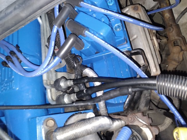

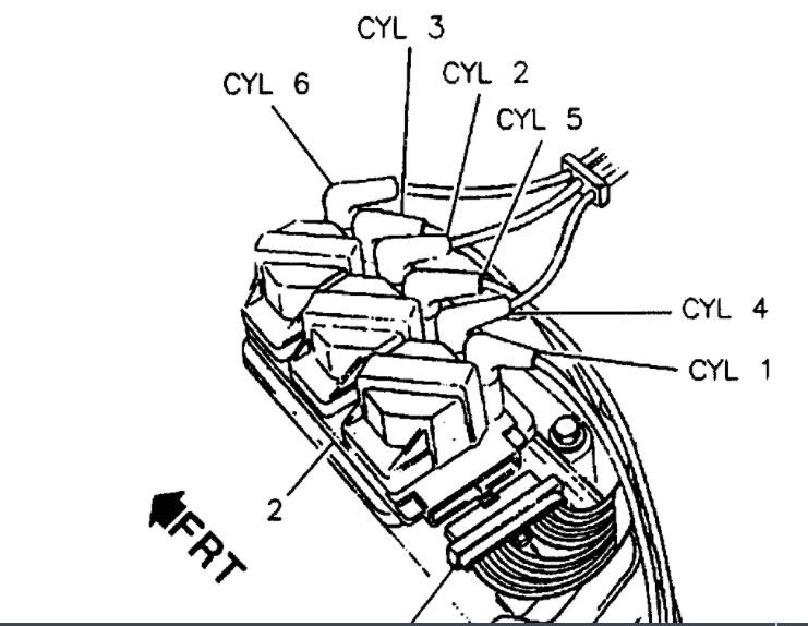

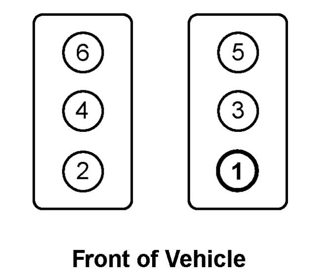

No, I'm sorry. the lug nut thread size for the 13mm nut, and do you know the firing order for the spark plugs? Also the firing order for the coil packs? I'm trying to get the right order for the spark plug wires to connect to the coil packs. guess I should of marked them, lol. but I was in a hurry.
Nov 10, 2020 at 7:49 AM
The stud size is 8mm 1.25 by 1 1/2 inches.
I attached the wire location for the coils and the cylinder identification.

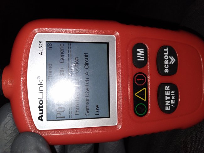

So I took of the fuel lines, air box, MAP sensor, fuel injection system and cleaned up the engine. tried to put it all back together some I marked some like the fuel lines I didn't now it started but running very rough and a few pieces of metal shot out the tail pipe red hot. Also I got a check engine code light on with this code.
Nov 22, 2020 at 5:14 PM

I do yes, but maybe I mixed up the firing order along with the fuel line? Can you send me a diagram?
Nov 22, 2020 at 5:49 PM
I sent you one already of where the the cylinder numbers are located and the coils where the wires go.
Nov 22, 2020 at 5:56 PM

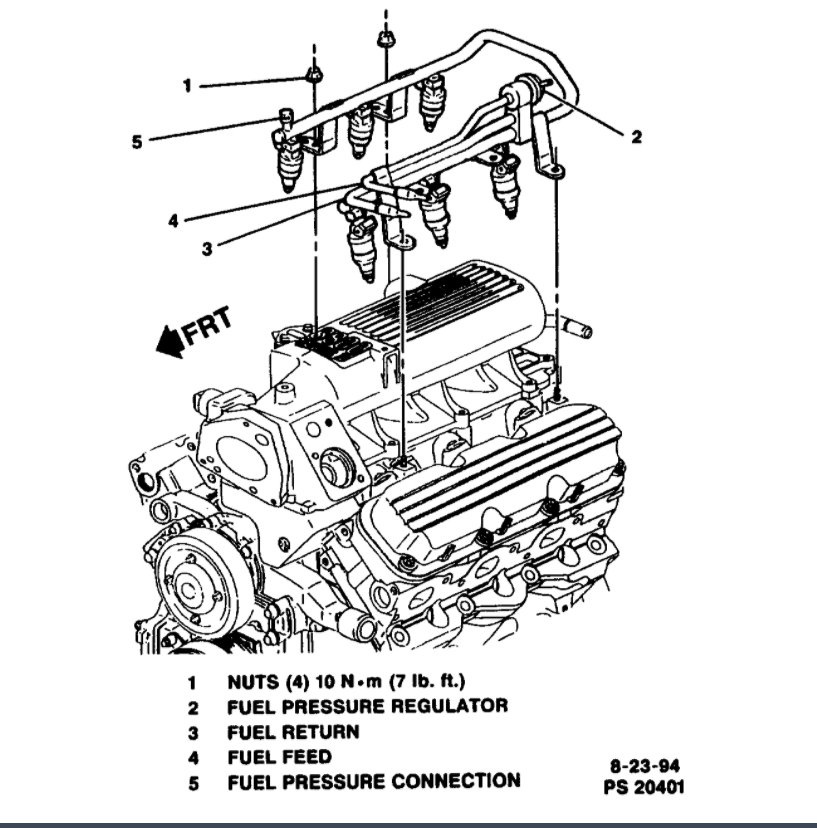

Okay, so update: i changed the spark and still have the p0306 cylinder 6 misfire code, and I also have a gas leak somewhere. I can smell it and when I pulled it out the drive way. I could see a spot where it was leaking looks like it came from the engine somewhere. Geez I'm getting so frustrated with this car.
Nov 24, 2020 at 5:46 AM
Did you do a compression test on number 6? You need 140-160.
Do not drive the car with a fuel leak. It could catch fire very easily.
Check around the injectors for a leak. I attached a picture for you of the rail.
Nov 24, 2020 at 5:57 AM
IGENIUS92
  • 205 POSTS
Can't really see where the leak is coming from the fuel injection system looks fine and dry. it is dripping down near my oil pan just can't see where it's coming from. how would I know if I hooked the fuel rails to the fuel injection system up correctly? If I crossed them up would it even start? This is so annoying i'm ready to drive this car, but the leak is my issue.
Nov 24, 2020 at 7:43 AM
Look carefully around the fuel rail where the injectors attached. Make sure you do not see any fuel leaking.
Check the lines to the rail as well. Make sure there is not leaks where the hoses connect.

I can't see anything that would have it leaking but you know after doing a little research I just may have those fuel lines that goes into the fuel injection rail mixed up and that's possibly why it's leaking? So I'm going to pull of the two fuel lines and switch them then key on engine off tonprime the fuel pump and check for leaks what do you think? Good idea? Any risks in switching them id have to worry about?
Nov 26, 2020 at 7:27 AM
Give it a try. They should be locked on the rail.
Nov 26, 2020 at 7:33 AM
IGENIUS92
  • 205 POSTS
Would it have any risks of messing anything up? Like damage to fuel pump?injectors etc etc? Fire risk?
Nov 26, 2020 at 7:35 AM
You will not damage anything if it is them.
Just make sure they are secure and clean off the engine the best you can of any excess fuel.
