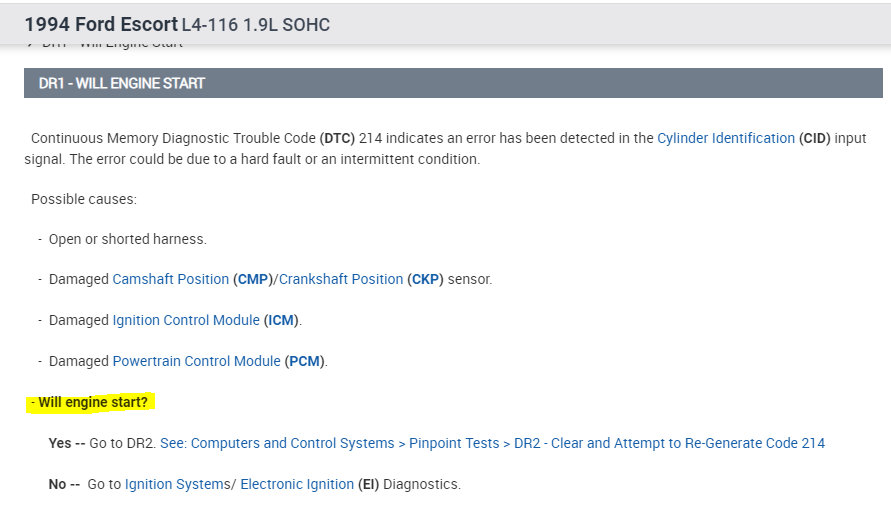

The code indicates there is an issue with cylinder identification. This could be the result of a few different things.
If you look at the attached pic below, I need to know if the vehicle is still running. I realize you mentioned poor acceleration/rough idle which indicates a misfire to me. But I need to confirm that it still runs to know which test to focus on.

Hi, yes, engine runs well.

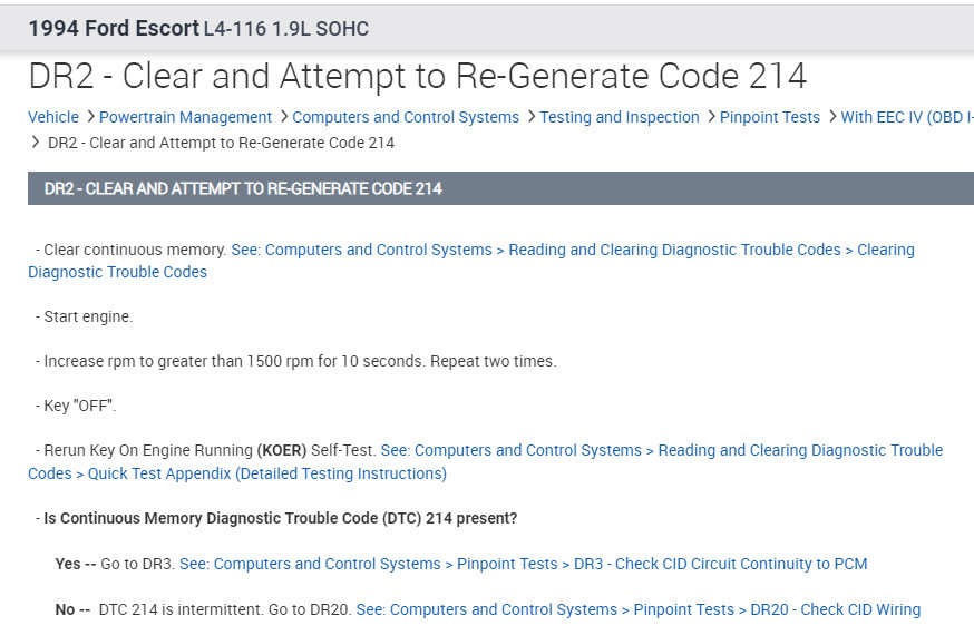

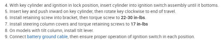

That takes me to a test that indicates to clear the code and see if it resets. Here is what to do: Disconnect the battery. With a zip tie, tie the two cables together and allow it to sit for approximately 10 minutes. Connecting the cables drains capacitors, so it's important to do it.
See the attachment below. Next, I need to know if it returns or not. Follow the directions and let me know what happens.
See pic below.

Okay, I'll try that. I disconnected for a couple hours, nothing. I'll be back. Thank you

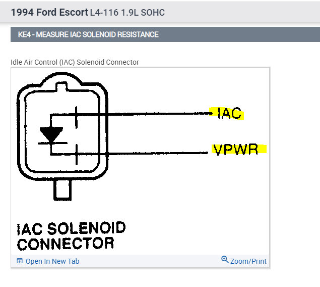

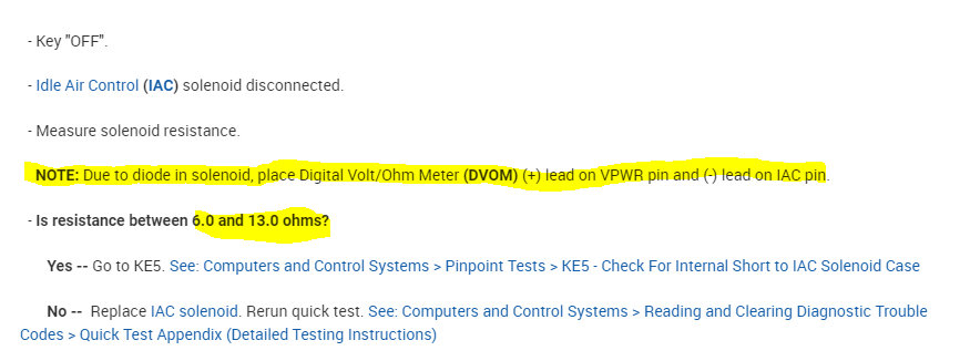

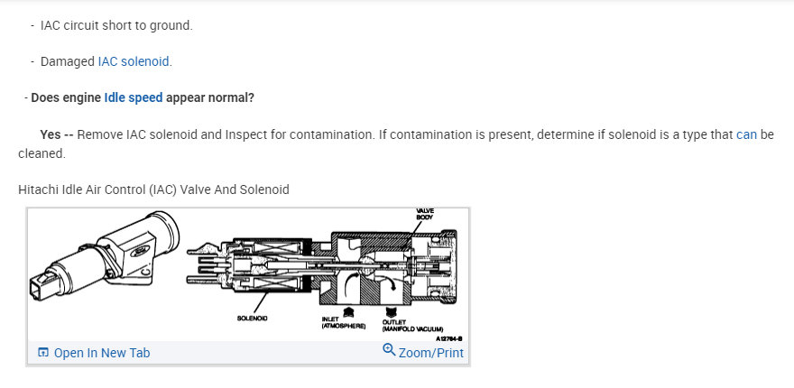

Also, I am looking at IAC valve, it reads 11 ohms across the solenoid. The information I can find lists less than 1 ohm as proper, do you know anything about that?
Jul 31, 2022 at 2:20 AM
  • 110,248 POSTS
The reading you have, 11 ohms, is normal. The only concern is there is a diode in the IAC. You have to make sure you have it connected the right way when checking.
I have a feeling the person that said less than 1 ohm had it hooked up backward.
I attached the directions below. Take a look and confirm you tested it the correct way.
See pic below.
Jul 31, 2022 at 5:05 AM

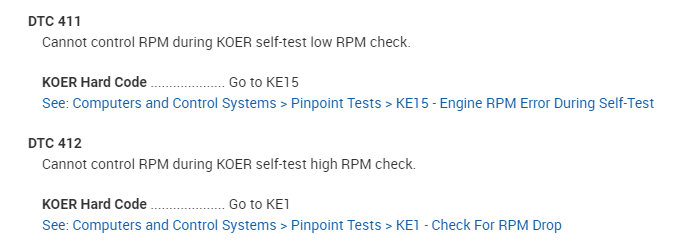

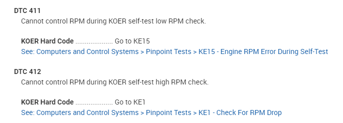

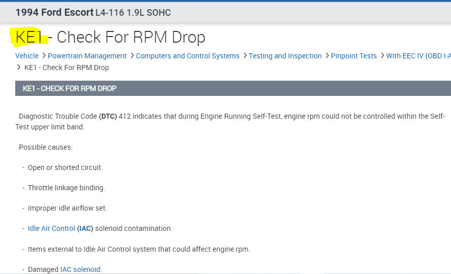

Hi again, did I lose you? I am wonderingif you have anything more onthe411, 412 code and the lag when accelerating from idle?
Aug 3, 2022 at 3:51 AM
  • 110,248 POSTS
Nope, I'm still here. I thought I lost you. LOL

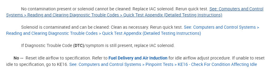

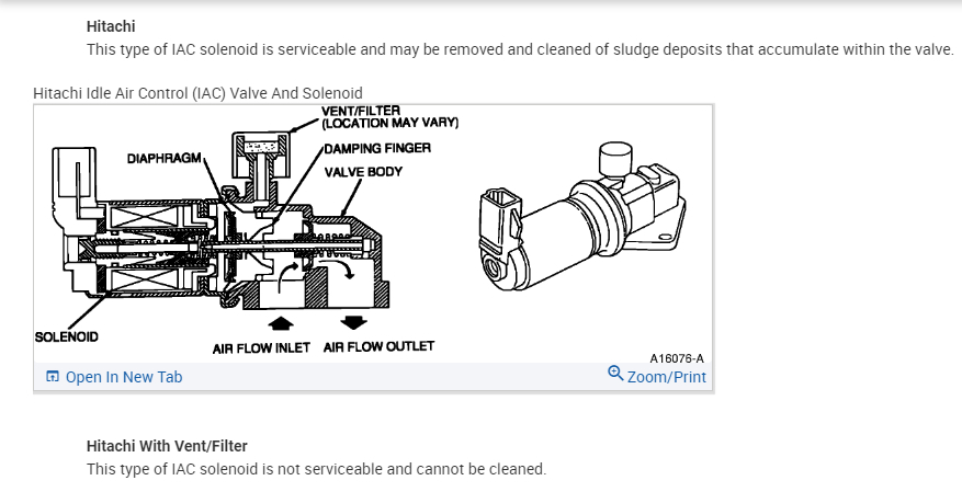

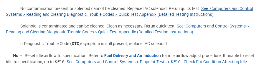

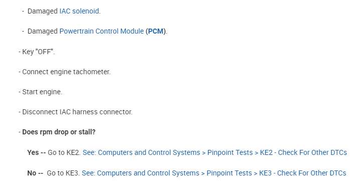

Take a look at pic 1. It shows the diagnostics for each code. I have attached them for you. Here is what I noticed. One thing in common that both codes have is an issue with the idle air control valve (IAC). However, a faulty IAC isn't the only possibility. They indicate in both to check for contamination.
Additionally, there are two different IAC valves that may have been used. One has a filter on it and is non-serviceable. if that is plugged, maybe it is causing an issue.
Take a look through them and let me know your thoughts. Additionally, at the end of the second set of diagnostics, it indicates what direction to test next, based on findings.

Hi, On testing IAC with ohmmeter, I get 11.4 ohms each way, switching back and forth no difference, is that a shorted diode? an open would be infinite resistance (or close)?
Aug 4, 2022 at 3:44 AM
  • 110,248 POSTS
The IAC sounds bad. It isn't an open circuit, but it sounds as though the diode has failed. Have you already tried a new one?

ALLAN HENDRIX
  • 18 POSTS
So, I have it on and the lag from idle is better, but light is still on. will check codes again and see what's up with that. maybe disconnect from juice for a while and see if it clears.
