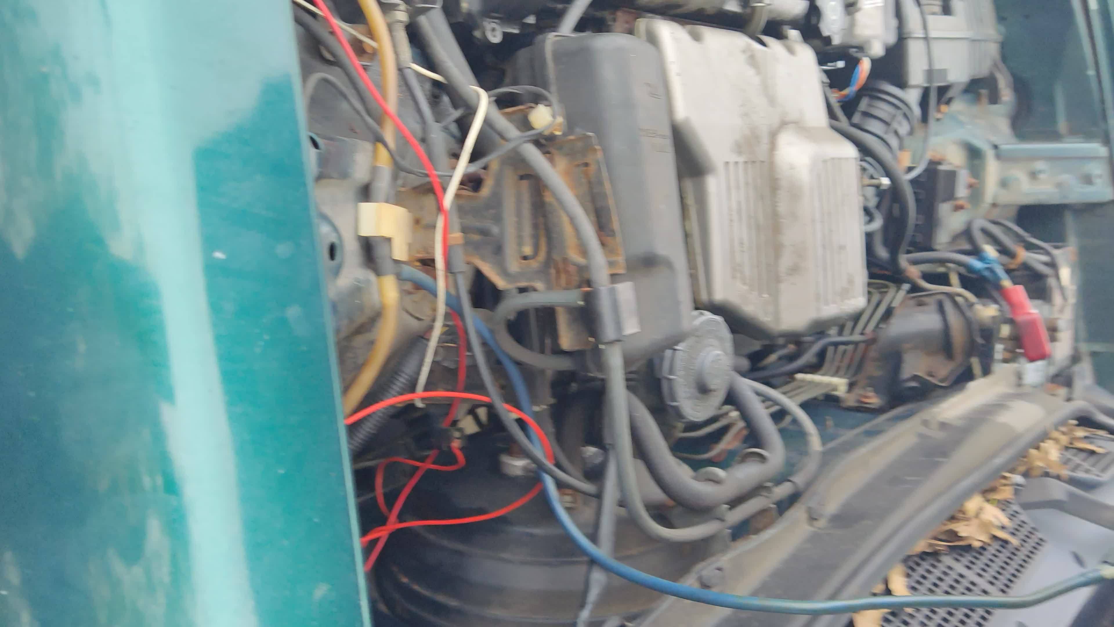

Here is whole story from start to finish. I should of started with this. I will record a better video now I have someone to help me. By plunger I mean the inner joint. More details I forgot to include. It all started when driving home. I was turning left and the wheel didn't return it kept turning. I get home and look at right side and saw outer tie rod is bad. I replaced Inner and outer right tie rod. I saw sway bar link was snapped. I drove to shop and started to hear a very faint banging that got progressively worse. After having sway bar link replaced it got worse. I get the car home and I replaced Inner and outer tie rod on left side and still happening. When at dead stop and turning going no more then 5 mph it clunks and bangs. Even when going straight it vibrates. Now at complete stop and turning the wheel it was clunking and popping. When I shortened tie rod ends on left side that popping banging stopped for most part. When shifting gear it would jump and make same noises. I replaced left CV and now it is no longer making noise when shifting. When you start to turn wheel and move just a few mph it makes that loud banging clunking noise. When this happens the entire engine jolts forward and backwards it does look like mounts are bad. I thought it would help if you knew everything start to finish my bad for not starting off with all this first. I will also include video ASAP.
Thursday, April 15th, 2021 AT 5:03 AM
GENESIS88
  • 140 POSTS

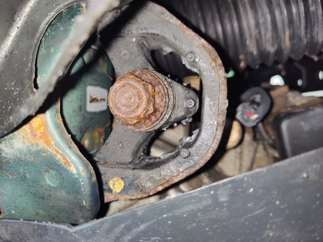

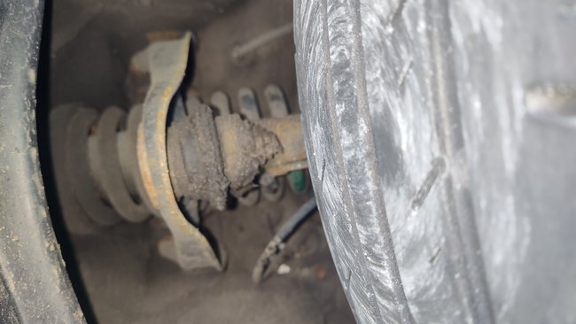

Lower Front left engine side this one has gone for years.
Thursday, April 15th, 2021 AT 6:23 AM
GENESIS88
  • 140 POSTS
Sorry got it backwards facing car this photo is lower left transmission side other photo is lower right engine side.
Thursday, April 15th, 2021 AT 6:25 AM
GENESIS88
  • 140 POSTS

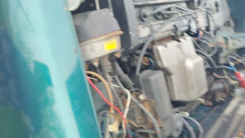

At 8 seconds in it makes the noise you will see engine jump. The clunk you hear sounds a lot louder in person and is very rapid. In video car was barely moving 1 mph. Steering wheel was turned.

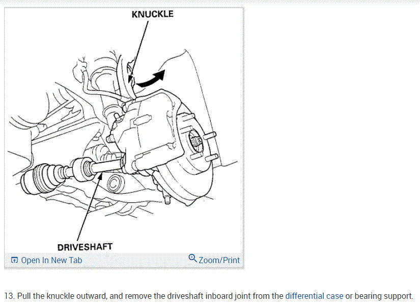

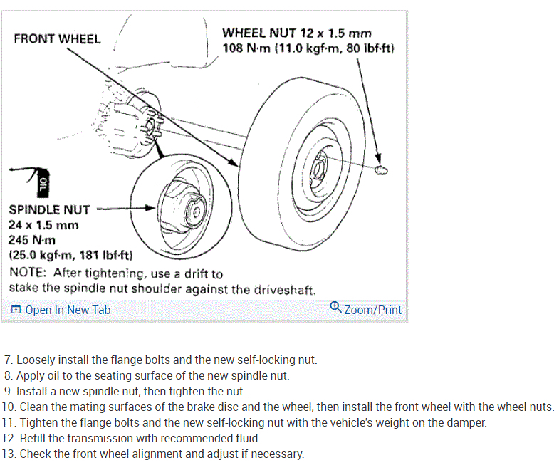

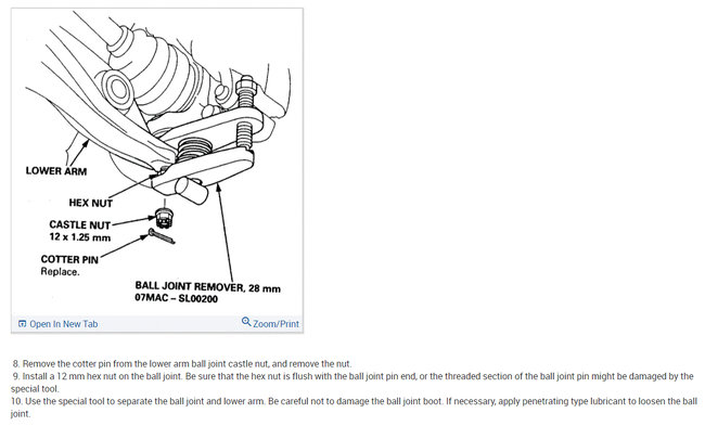

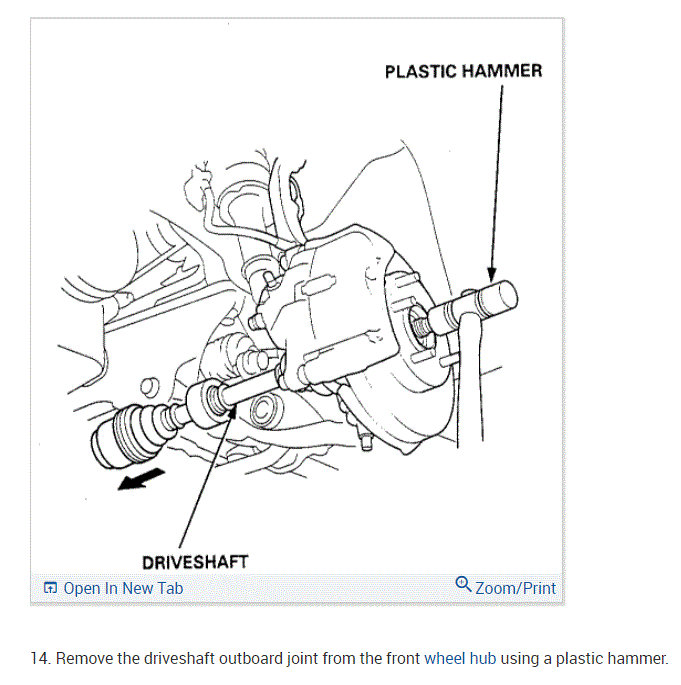

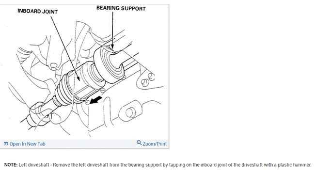

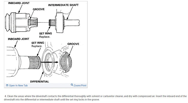

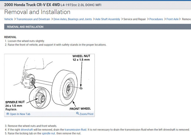

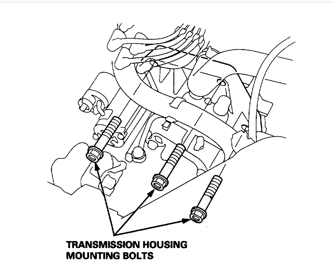

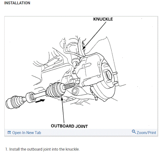

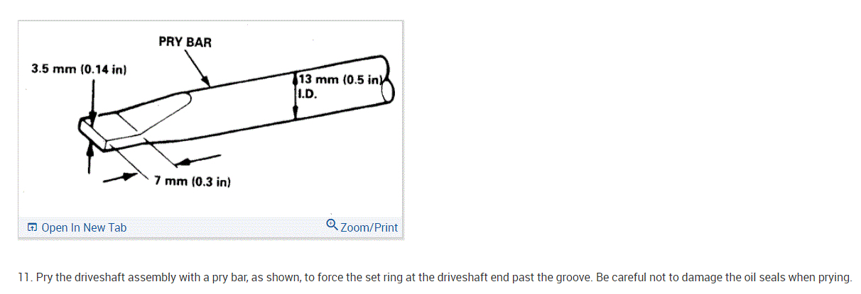

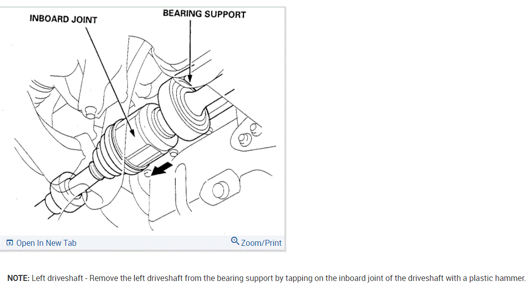

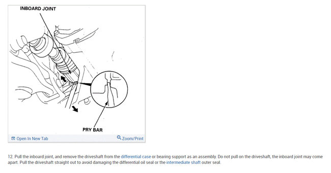

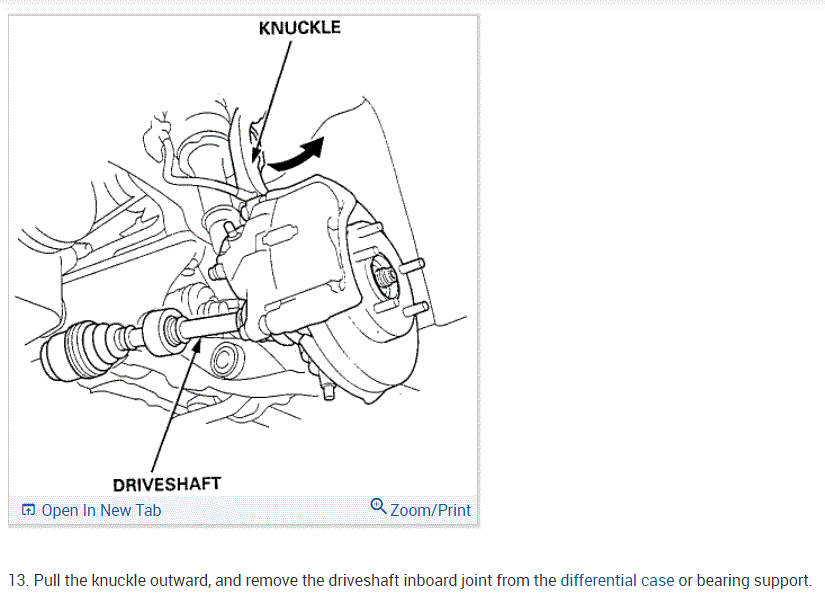

I watched the video. It really seems like you have a bad CV joint causing it to jump like that. I realize you replaced the left one, but have you inspected the right one? Also, are the splines on the axle fully seated?
That is what I would be checking. If you find the axle/CV joint is the issue, here is a link that shows in general how it is done:
https://www.2carpros.com/articles/replace-cv-axle

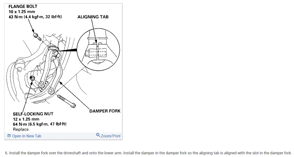

If you look at the attachments below, they include the directions and pics specific to your vehicle for replacement.

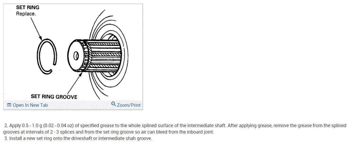

I can't find a replacement set ring for intermediate shaft. I am not sure what size or what else I can use.

When I shift you will hear minor knock and see slight movement with engine. Right as I start to turn wheel you will see engine lift forward. Oil pan is in front of inner joint.
Friday, April 16th, 2021 AT 12:42 PM
GENESIS88
  • 140 POSTS

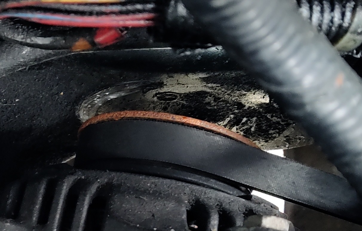

Alternator is hitting. The video I sent you see the engine lifting when turning wheel. I redid CV and it still clunks but not as loud or as much.
Friday, April 16th, 2021 AT 2:07 PM

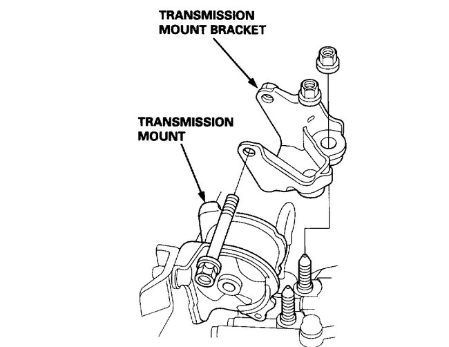

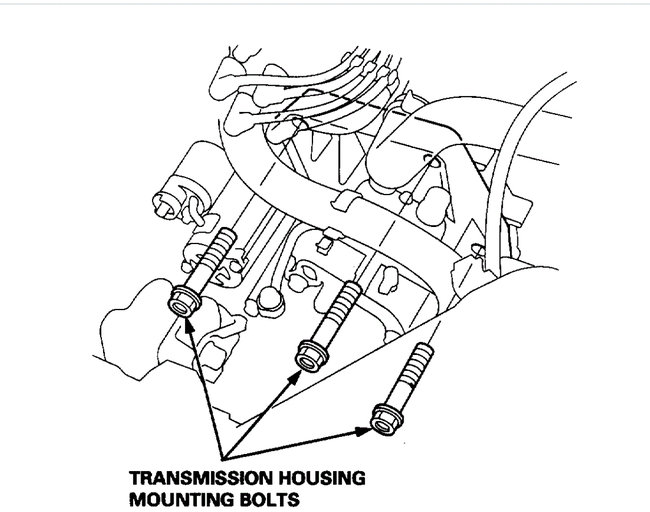

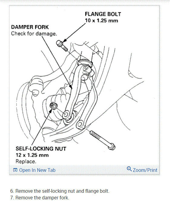

  • 109,874 POSTS

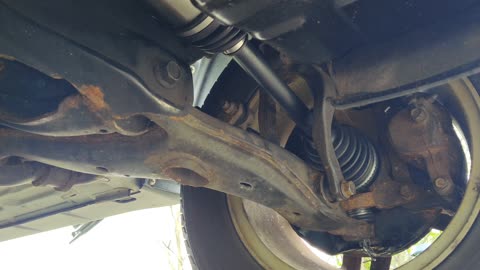

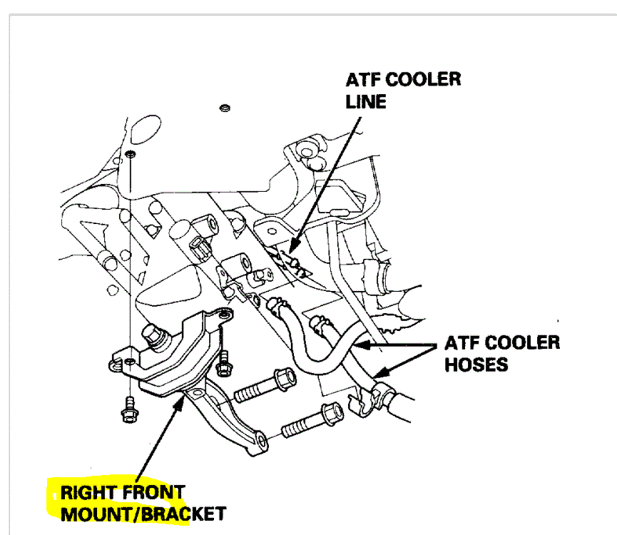

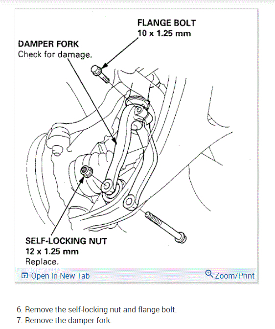

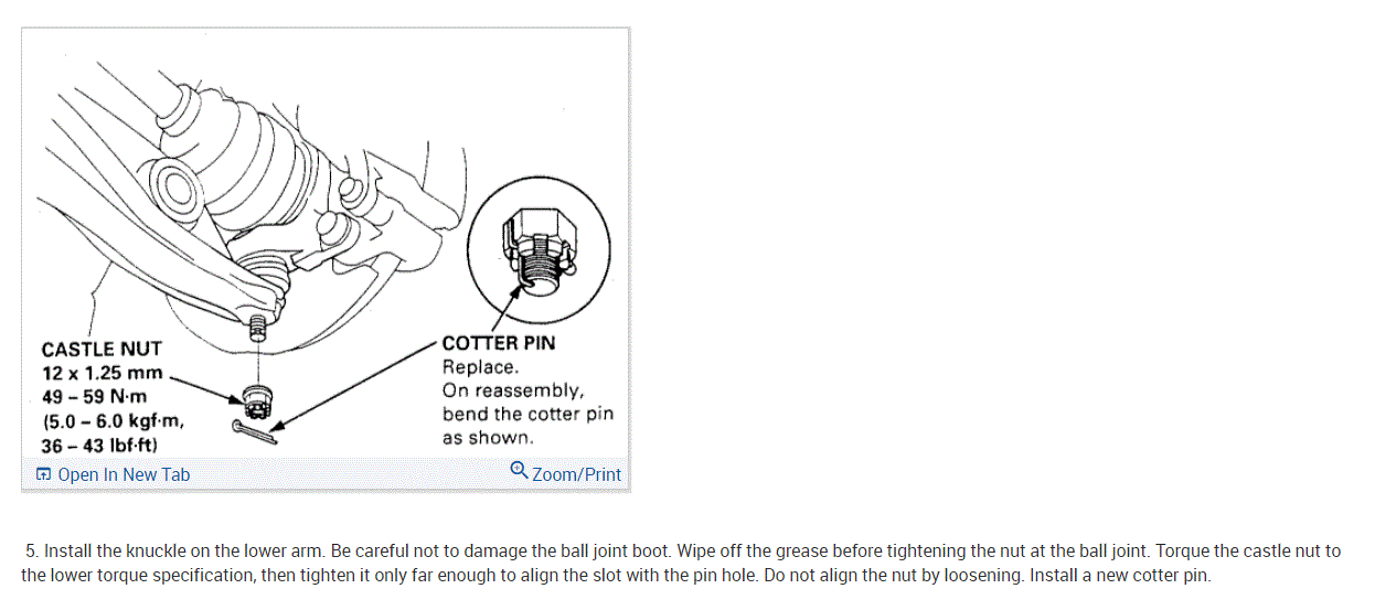

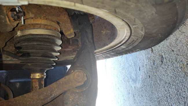

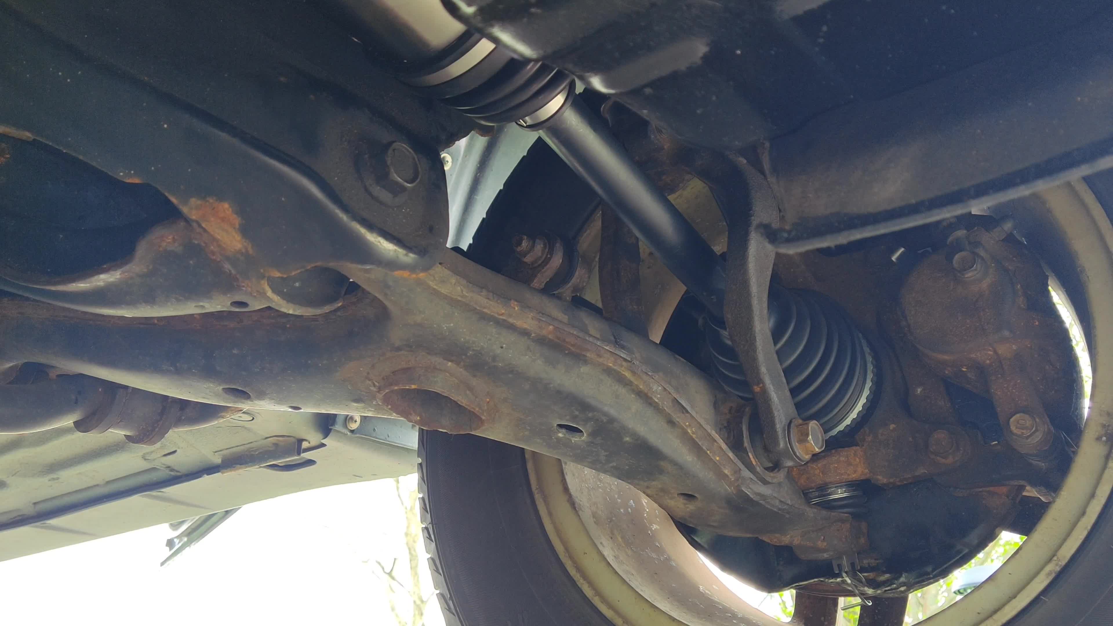

The entire engine/transmission has to be moving for the alt to hit and it looks like the axle is hitting or nearly hitting the control arm.
Take a look at the pics below. Check these things and let me know if you find anything broken, missing bolts, or loose.
As far as the set ring, that may be a hard find. Have you tried the dealership? Did you lose the original one?
Friday, April 16th, 2021 AT 7:54 PM

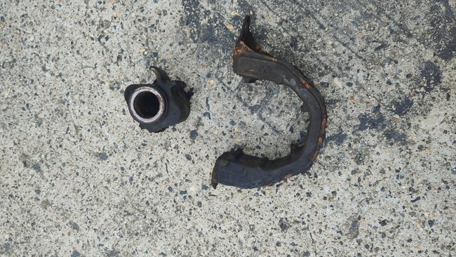

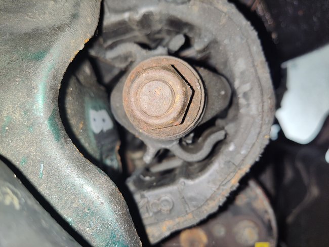

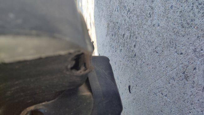

This motor mount is no good. This is how it came out. When I was taking this mount off I was able to move the engine back and forth With very very little force.
Saturday, April 17th, 2021 AT 9:31 AM
GENESIS88
  • 140 POSTS
I forgot to mention I haven't look closely at the others. I do know the lower left engine side is gone. The lower right trans side is cracked through.
Saturday, April 17th, 2021 AT 10:50 AM
GENESIS88
  • 140 POSTS
So I think it's fixed. I installed lower front engine mount. I also found upper mount wasn't fully tighten. I did timing belt couple months ago and forget to torque them to spec. I tested car in driveway to neighbor driveway going forward and reverse and turning wheel fully both way with no noise. Once I fix my alignment I can do a real test drive. So it looks like the lower front transmission mount cracked all the way, since the lower engine mount was gone engine dropped slightly and caused a lot of movement. In turn it caused cv to bind and make a lot of noise. The original CV axle was bad. The first 2 replacement where defective. So it looks to be a whole mess of things going wrong in a row. Also me making a mistake and not double checking my work. Now I don't know for sure, but this was the first time it make zero noise when testing in driveway to neighbor drive forward/ reverse and turning wheel both ways fully and stomping gas and then brakes. I should know in a few days when I do a at home alignment if it's truly fixed. Also the rest of the motor mounts are in good condition. Only the 2 front lower where bad and the 2 nuts on top engine mount loose.
Saturday, April 17th, 2021 AT 6:33 PM
  • 109,874 POSTS
I think you have found the problems. I don't think I've ever seen a mount as bad as the one you attached. The engine and transmission are moving all over the place.
As far as the one on the trans side, replace it and any other ones that are bad. Let me know if you need help with anything. If you have a chance, let me know the outcome.
