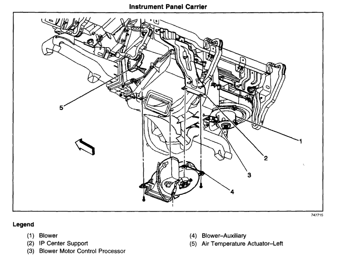

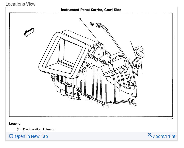

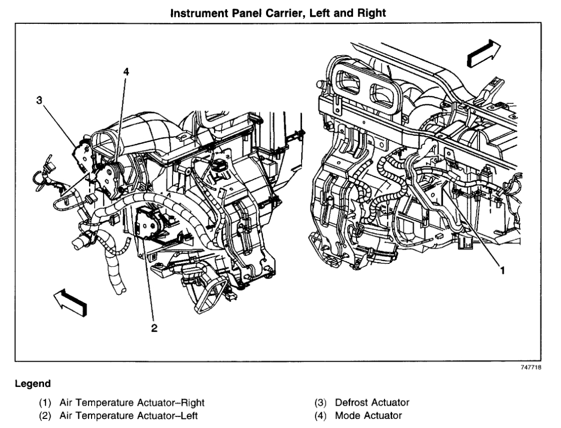

Ac is working on passengers side blows nothing but heat on drivers side suggestions on how to repair?
Saturday, June 20th, 2020 AT 10:31 AM (Merged)
HMAC300
  • 48,601 POSTS
This is common when the blend door actuator goes out this guide will help walk you through the replacement steps with instruction in the diagrams below to show you how on your car.
Check out the diagrams (Below). Please let us know what you find.
