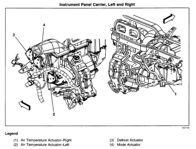

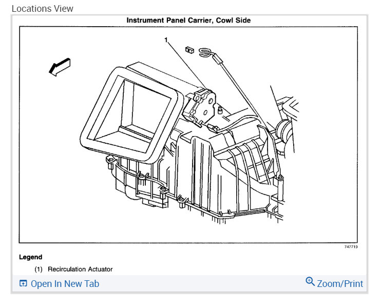

Loud Clicking noise when I put the heat on the feet area and/or the defrost or heat is turned completely off. There is no clicking noise or problem when the vent is toward you and you/floor vent. Basically there is no problem when the heat option has AT LEAST one of the options as the heat going towards your upper half. But if there option is not one (aka only defrost, or only towards the feet and also when the heat is turned completely off) then the loud clicking noise occurs.
Tuesday, January 21st, 2014 AT 9:34 AM
22 Replies
SATURNTECH9
  • 30,869 POSTS
Sound's like you have a bad mode door actuator or broken mode door your going to have to get in there and see which.I would say most like the actuator not uncommon on those cars.
These guides will help fix it
and

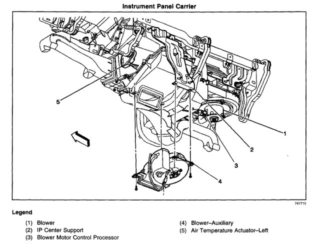

(1) when the envoy is started, the air conditioner works fine, and blows cold air through the vents.
(2) after about 30 minutes the air speed gets slow through these vents, and becomes less cold.
(3) additionally, I noticed small ice pieces (tear drop size) spitting out from the vents every few minutes.
Saturday, June 20th, 2020 AT 10:27 AM (Merged)
HMAC300
  • 48,601 POSTS
Have this checked for freezing up it may not have anything to do with blower speed but you may need a evac and recharge. due to moisture in system. for the blower check harness going to resistor and blower motor draw it may be one or the other or both.
This guide can help fix it
