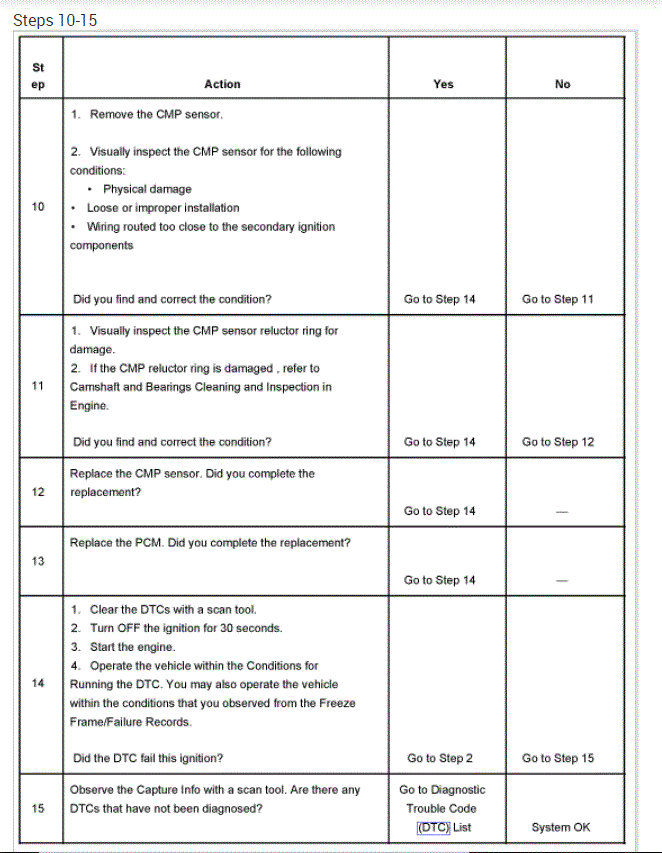

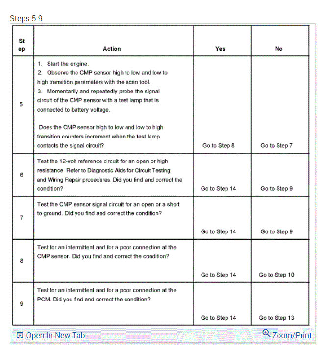

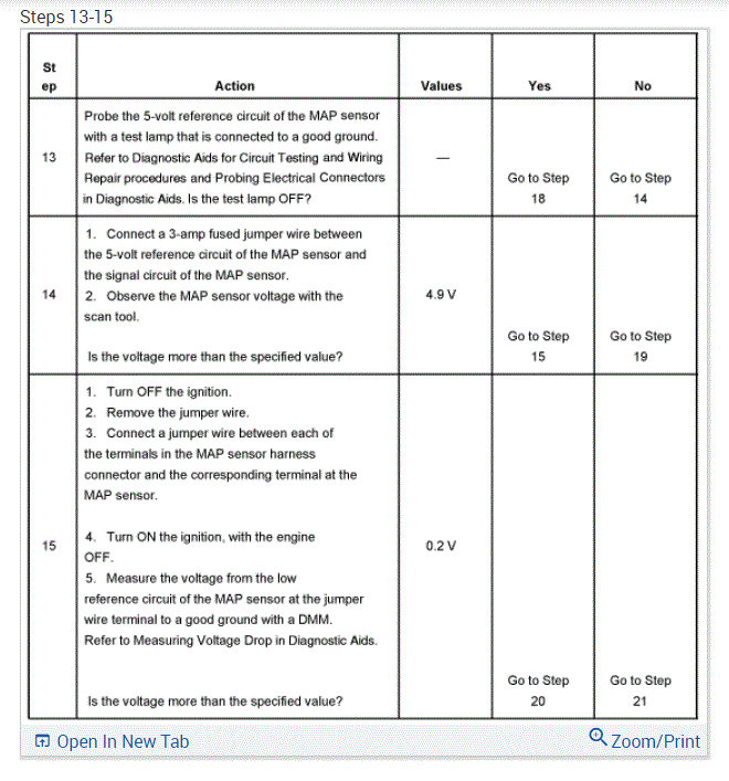

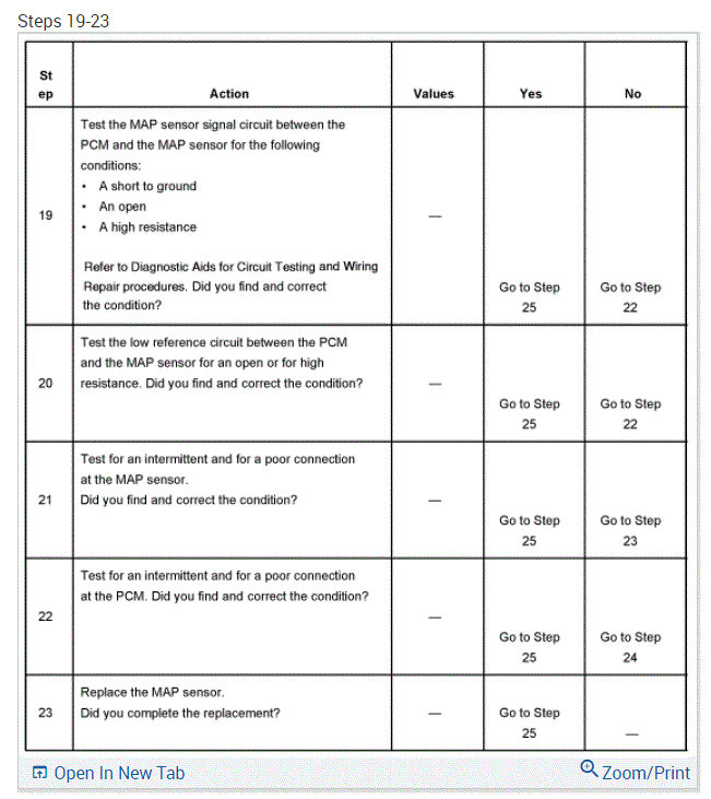

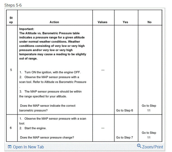

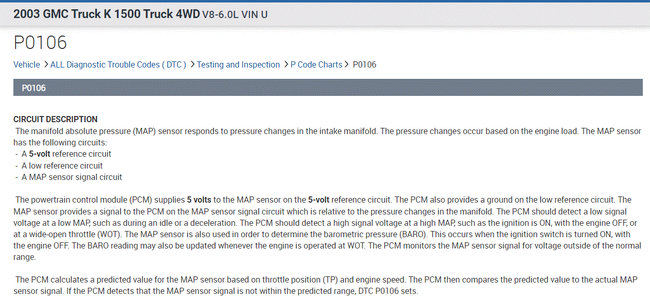

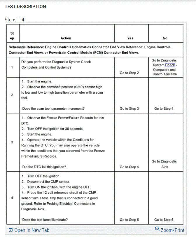

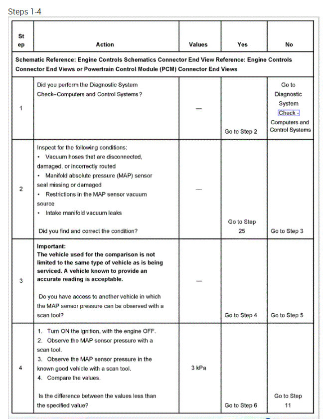

Have you checked the reference voltage to the sensor? It should be right around 5v. Also, check the low reference for continuity to ground. Also, have you done anything with the cam sensor? It too could be a ground issue or voltage problem.

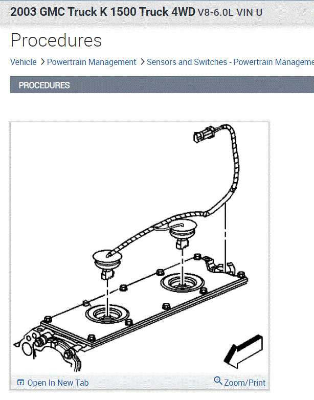

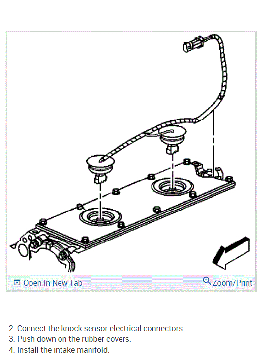

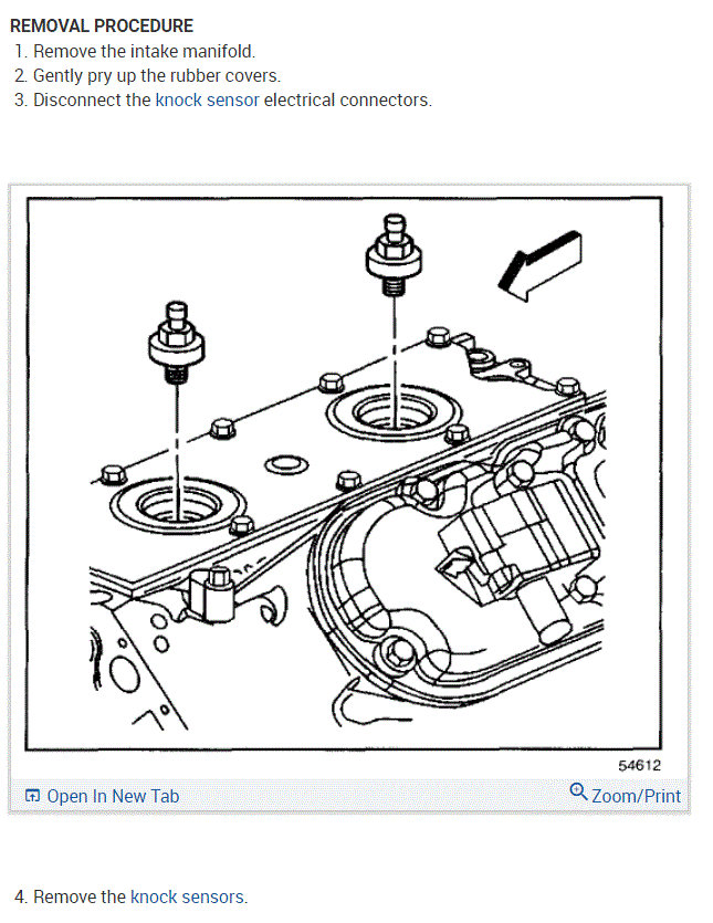

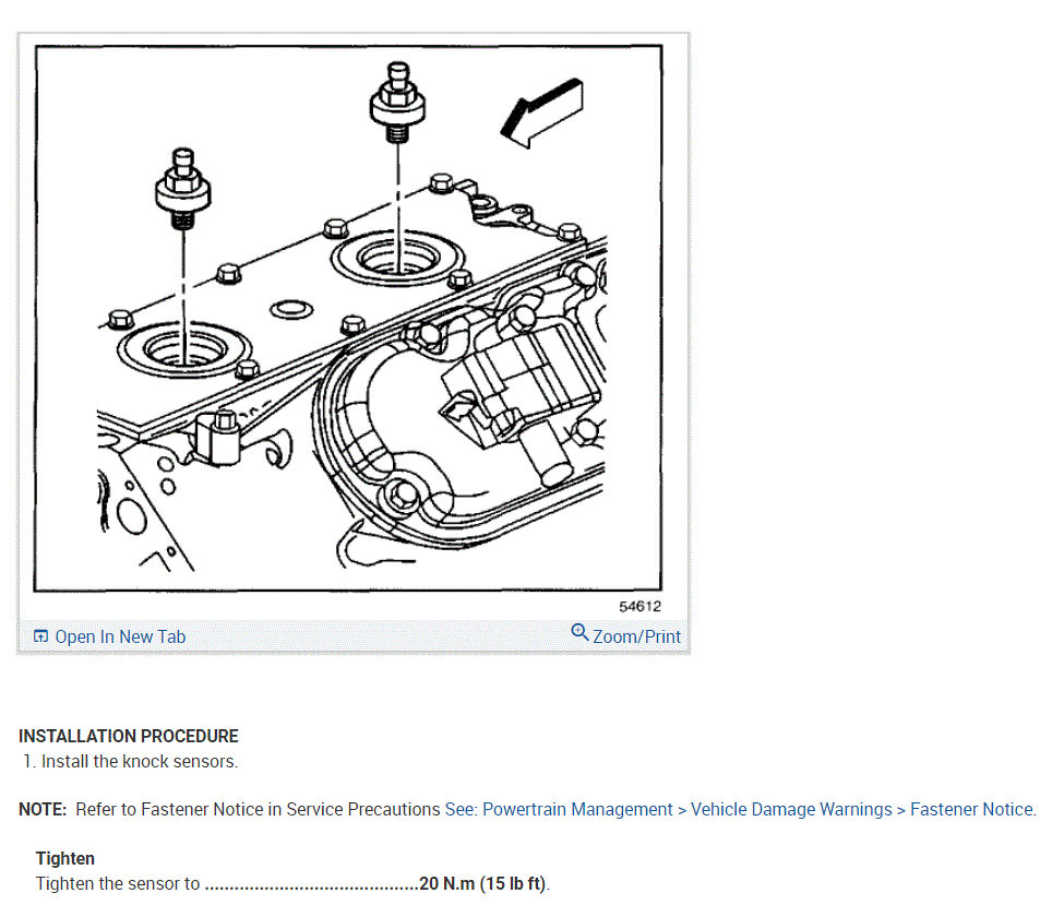

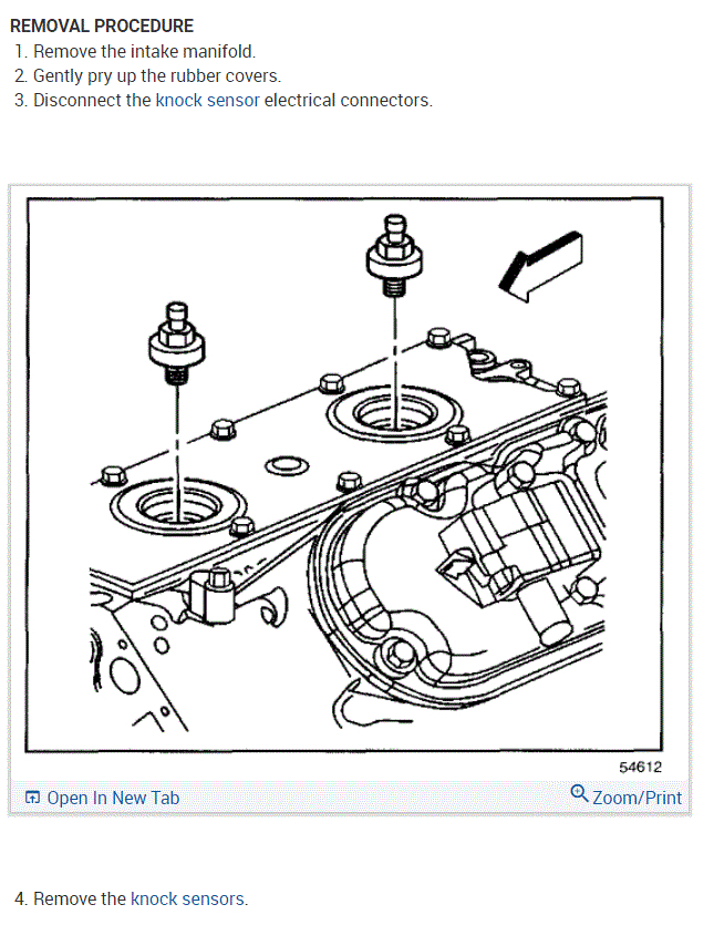

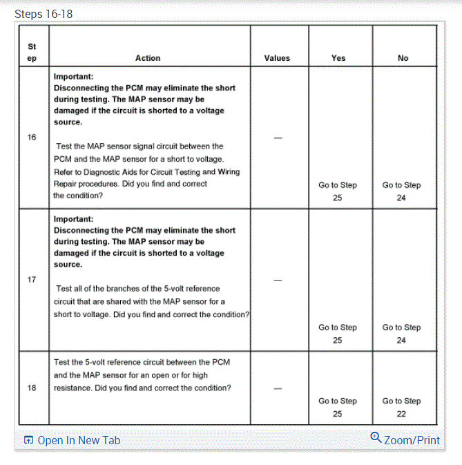

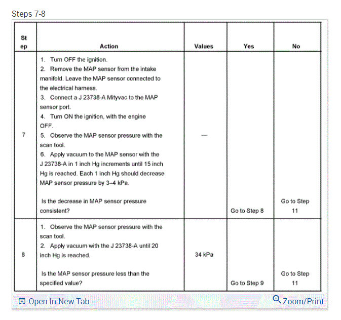

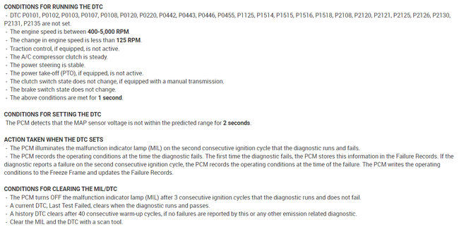

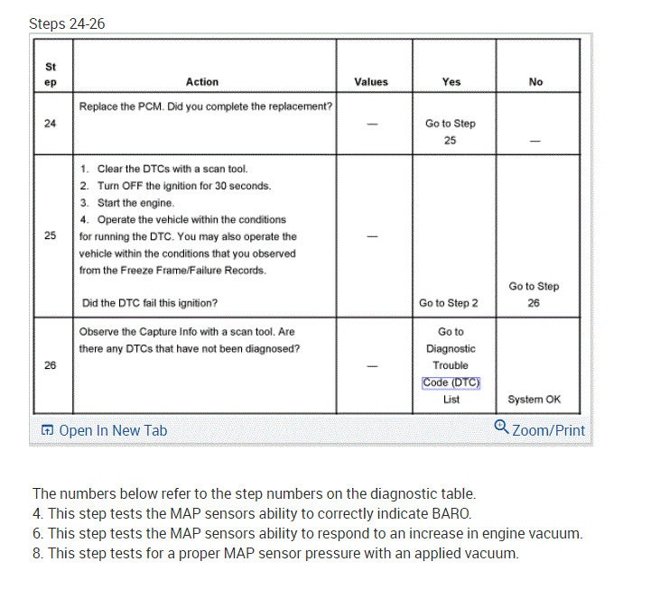

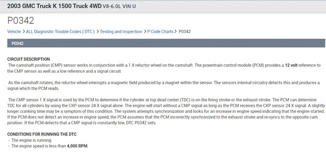

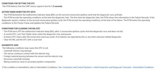

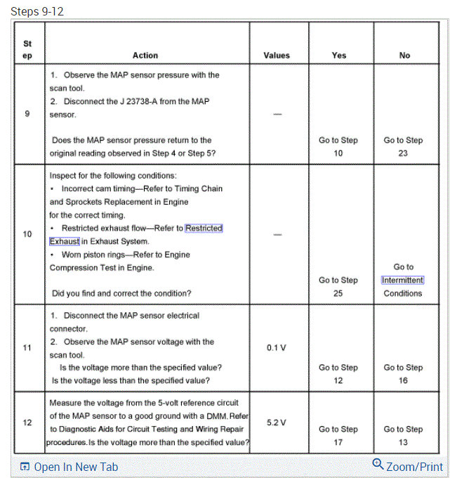

I have all the diagnostics which I'm adding below. I don't know if you will have the tooling to complete them. However, take a look through them and let me know.
If you look at the attachments below, I included the directions and pics related to both codes. The first six pics are for the P0342. The remaining pics are for the P0106.
Let me know if this helps.
See attachments below.

Well, I put in some serious hours under the hood this weekend, and came to a few different conclusions.
1st the new cam sensor that I swapped out when I changed the cup was bottoming out against the reluctor. So I put the old one back in and all was good for the moment.
Then I had to do the MAP sensor along with the pigtail to it and all was good for about 5 minutes into the teat drive. Then after awhile I noticed that I had wited the pigtail wrong and had 2 wires crossed so while fixing this I went over the whole harness with the wiggle test and found out that the wiring at the pigtail for the main feed wires to the passenger side coils was bad. Now that I redid the pigtail the truck is running great again.
Oh, and just so if anyone else is having this type of issues with their truck. Make sure you go over the whole harness from begin to end and that's where the most of the issues are coming from. Plus I had to do a anti theft system reset which is easy once I found it online.
