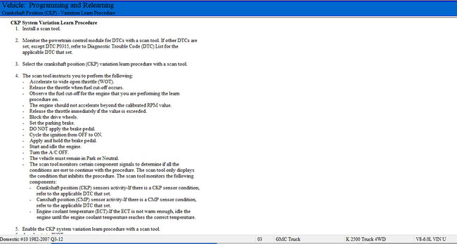

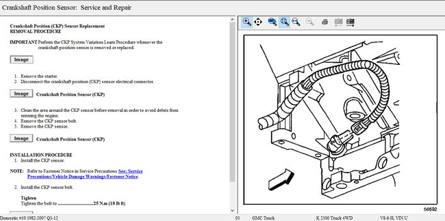

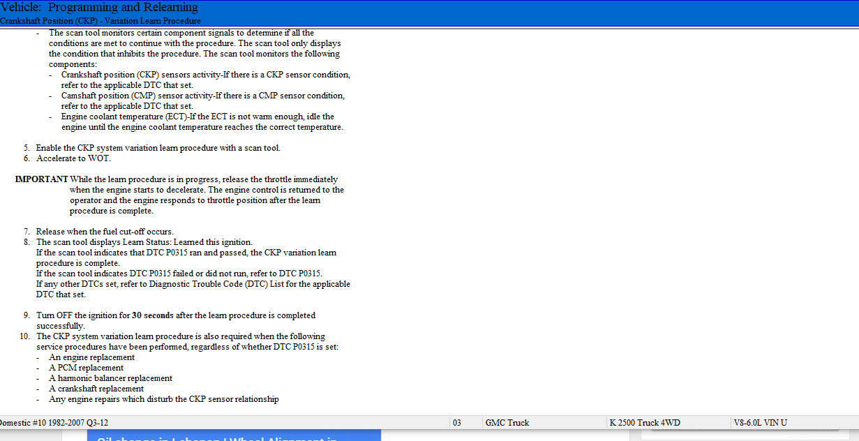

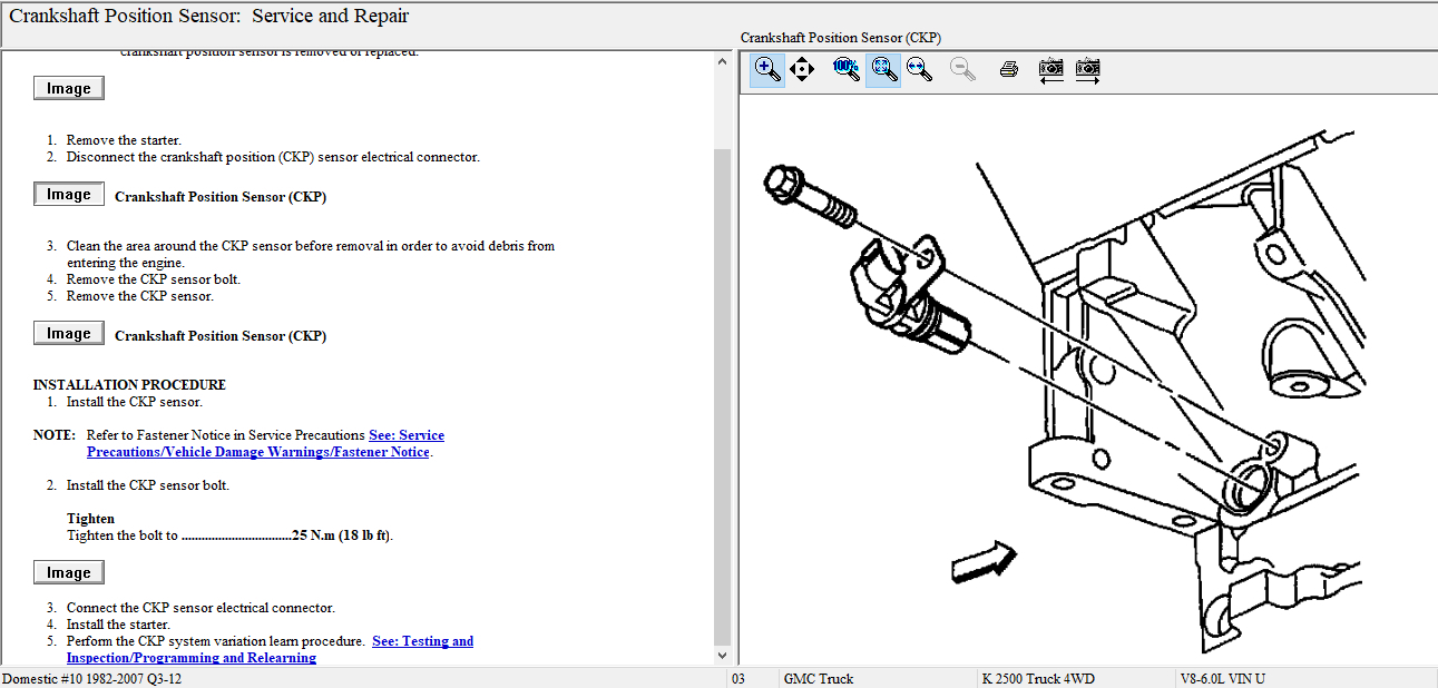

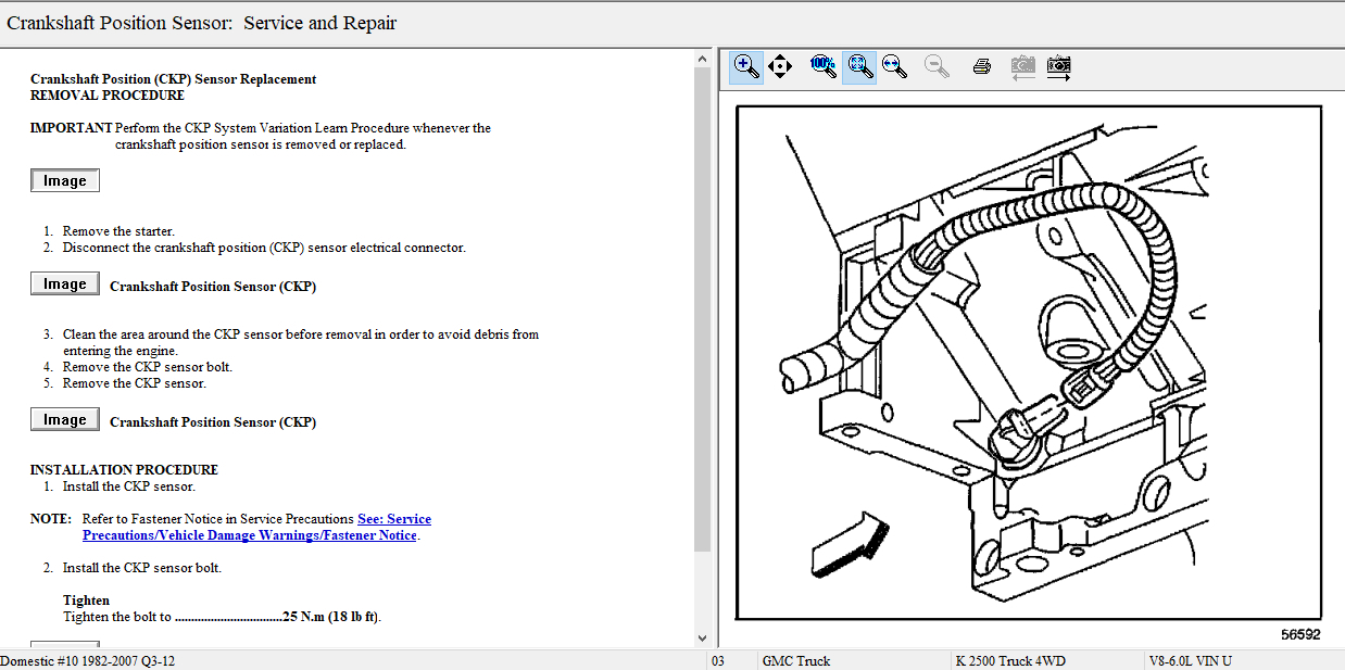

Crankshaft sensor replacement can be replaced by just removing the starter to have access, no need to turn the engine on TDC.
yes you need scan tool to perform crankshaft sensor learning procedure,
check the procedure below at pictures attached how to replace crankshaft sensor and how to perform learning by using scan tool.
Let us know if you need more help.

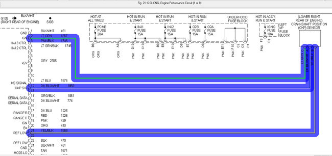

Okay, maybe I should have done this from the beginning. So let me fill you in on how I got to where I am with my truck.
So a few weeks ago my instrument cluster had stopped working. I was able to make it start working again by smacking the dashboard. About a week after that it had stopped again but this time I had to take the dash apart and as soon as I started to unplug the connection it started working again. Then it happened a third and final time. During this disassembly I checked all fuses and power and ground to the cluster but everything was fine with all of that. When this happened the only thing that continues to work in my cluster is the backlighting, turn signals and the check engine light. All gauges the shift indicator and the mileage indicator stop working.
When I took everything apart this time I started the truck turned it around for better access to my tools and proceeded to check everything out. But when I put everything back together and tried to start my truck it would only crank over, I had no spark on all 8 cylinders.
So I went about checking all of my fuses again inside the cab and the engine compartment which again all was good. So I've been at this dilemma for a few weeks now. Going thru everything that I could possibly think of and research on.
I have checked power and ground to almost every connection that there is on almost every sensor that there is on the engine (with only a test light). I have not been able to run a DMM on it not being able to successfully have someone crank the motor at times that I've needed so that I could check for pulse or anything. I have looked inside the dash panel to see if maybe there was a wire that may have been pinched or something and all of that looks ok. Now when I have checked the power and grounds at the sensors I also checked it and where it connects to it's ground point's. Since all was good I never checked in between connections and ground point's because since it was good at at the ends I figured that there would no bad spot in between.
During all of the diagnosis I hooked up a code reader and had a p0300 random misfire which I had been fighting for a couple months now. Even after I had done a wire and plug tune up I had the code again. But I also had a new code jump up this time which was a p0332 knock sensor 2. Since then I cleared the codes because I removed the battery to charge it. When I put the battery back in and tried to start it again I now keep getting a p0335 crankshaft positioning sensor. Which I had replaced because with the knowledge that I do have and the research that I've done that was what was leading to the no spark issue. But no good luck on my side.
The motor is still cranking over good but still has no spark. I have good fuel but do not know exact pressure reading without a pressure gauge. The motor is the 6.0l vortec and it's sitting inside the 2003 GMC Sierra 2500hd 4x4 extended cab. I'm pretty stumped on it now and really wondering what else to do or where else to look. Can you please help me and lead in a good direction to look so that that I can get my wheels back in the mud.
Again thank you very much in advance for your advice and information. Sorry for the long story about this situation but I thought it would be best to bring you completely up to speed with my truck so that you would have enough details to help.

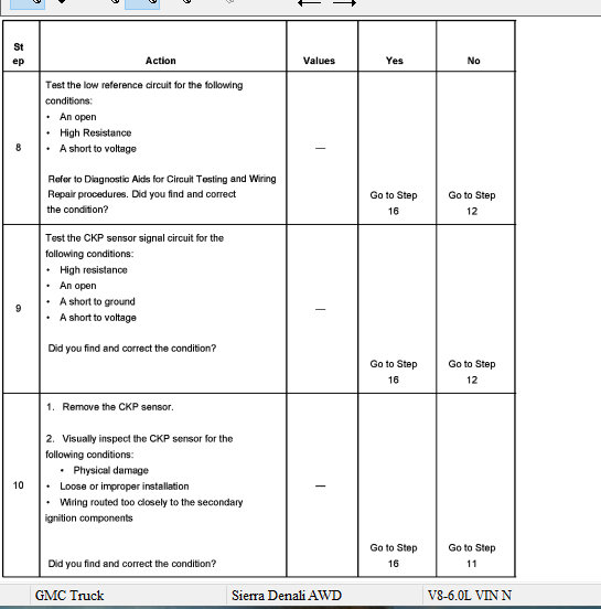

SEVAG P
  • 405 POSTS

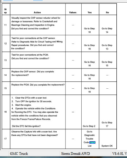

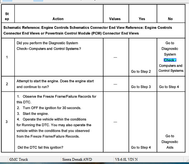

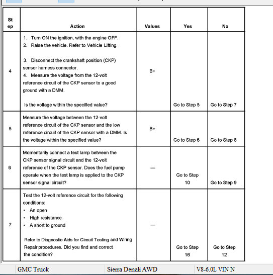

hello,
Refer to fault code p0335 you have problem on the crank sensor harness to engine control unit, check sensor connector if clean and tight, check engine control unit connectors if no water traces and tight. remove crank sensor check for any dirt and be sure not touching the sensor to reluctor wheel. if they are okay, check the procedure below step by step to fix p0335.
fault code.
check our links below for crank sensor symptoms and how it works.
https://www.2carpros.com/articles/how-a-crank-shaft-angle-sensor-works
Let us know what happens with you.
thank you.
Jan 28, 2021 at 9:11 PM

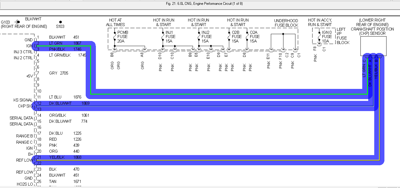

SEVAG P
  • 405 POSTS
hello,
Check the wiring diagram below, from crank sensor to PCM. waiting your results.
hope it's wiring issue not PCM.
thank you.

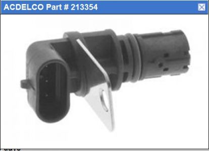

I'm having a hard time locating crankshaft positioning sensor it's not behind the starter
Feb 5, 2021 at 3:13 AM (Merged)
HMAC300
  • 48,601 POSTS
This video will help
https://youtu.be/sKo7xRWVNqY
Check out the diagrams (Below). Please let us know what you find.
WRENCHTECH
  • 20,761 POSTS
That's because it's not located behind the starter. It's on the back of the engine where the bellhousing meets the block on the driver's side, near the top. https://www.2carpros.com/images/external/98875427.gif
FALANDO
Thank you that was very helpful

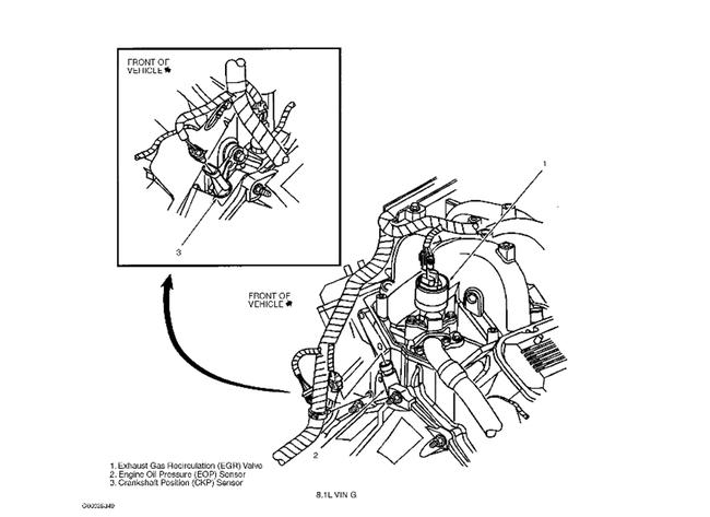

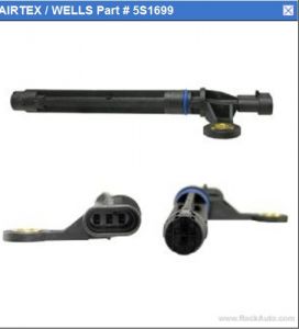

DOMAINCO
exactly where is it located i puchased a new one from pep boys i removed the sensor above the crank pully and looks nothing like the one i purchased help!!!!!!!!!!!!!!!
Feb 5, 2021 at 3:14 AM (Merged)
JDL
  • 16,098 POSTS
What is the litre size of engine? My info showed the crank sensor is located above the starter. See picture.
https://images.2carpros.com/forum/automotive_pictures/170934_crankshaft_position_sensor_3.jpg

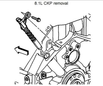

DOMAINCO
i have the 8.1 liter removed the starter and did not locate sensor any other thoughts and thanks so much for your help!!!!!!!
JDL
  • 16,098 POSTS
Sorry to lead you in the wrong direction. The 8.1 shows to be on the rear of engine block, bell-housing flange. I've never changed one of these. I just looked at the component locator for 8.1.
https://images.2carpros.com/forum/automotive_pictures/170934_81_crankshaft_sensor_1.jpg
https://images.2carpros.com/forum/automotive_pictures/170934_crankshaft_position_sensor_2_1.jpg
DOMAINCO
I've located it already and have successfully changed it however it is in a extremly hard to reach location , figure at least 3-4 hours of work
Thank you guys so much for your help

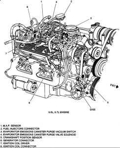

Where is ckp sensor located on this truck? I can find info up to a 97 or 99 up,but I can't find anything on a 98.
WRENCHTECH
  • 20,761 POSTS
It's behind the harmonic balancer on the front of the engine https://www.2carpros.com/images/external/86415972.jpg.gif

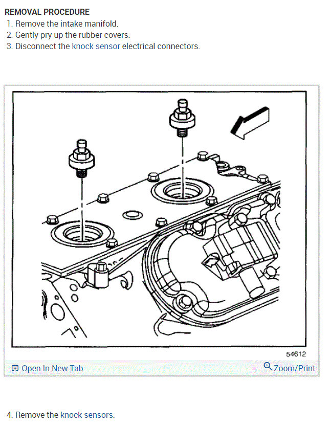

Hello Joe. My truck is powered by the 6.0l vortec gas distributorless motor. There is a lot of insight in this forum concerning the vehicle itself snd what has gotten me to where I am now. Starting from the very 1st issue up to present.
Thank you for your interest and advice that may come.
Apr 4, 2021 at 5:22 PM
  • 110,240 POSTS
Do me a favor. On the front of the engine (driver's side) almost about as low as the oil pan is a ground for the coils. They are known to fail. Check the condition of it. Make sure the connector is good and make sure there isn't a corrosion issue.
The interesting thing is that ground is for all of the coils. If it is weak, it can cause all kinds of different problems.

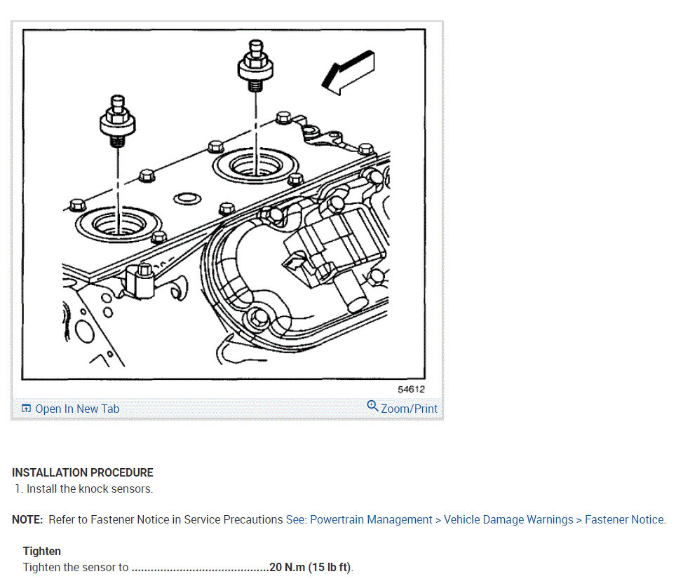

When I look up the codes, I'm seeing different definitions. The P0334 is for a knock sensor and the 170 is for a fuel trim issue. Note that a rich fuel mixture can cause a backfiring issue.
Also, the knock sensor fine-tunes ignition timing. I don't think it could get far enough off to cause a backfire, but it certainly can cause valve ping.
Do you have a live data scanner? If you do, let me know what the short-term fuel trims are at idle. Take a look through this link as well.
https://www.2carpros.com/articles/engine-backfires-while-running

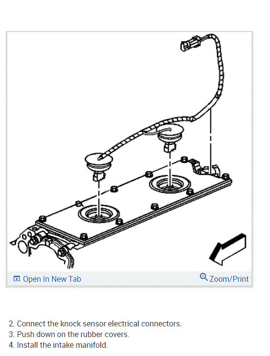

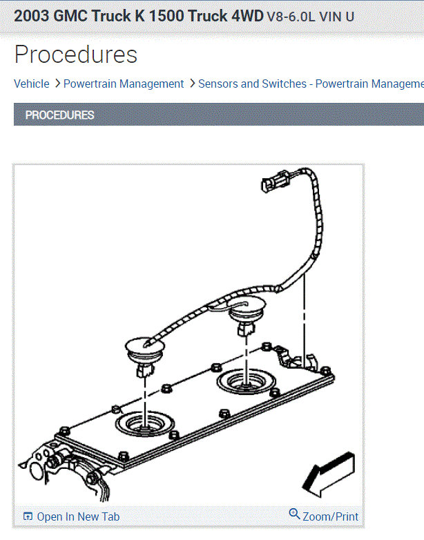

As far as the knock sensors, they are under the intake manifold. If you had dry brittle wires from the PCM, these could have the same problem because of location. The see a lot of heat.
If you look at the attachments below, I included the directions for removal and replacement. At least check the condition of the wires.
I'm really interested in knowing the fuel trims. You could have an intake leak, O2 sensor issue, fuel pressure issue, the canister purge valve could be stuck open, and so on.
