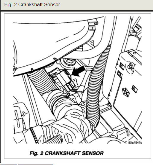

I recently bought a used Chrysler Town & Country and the first night I brought it home, we had an incident. The car turned on and would turn off right way. This happened three times and on the 4th time and every time after that the car would not turn on at all. The next morning the car turned on just fine and it worked perfectly for over a month until the same thing happened again a few days ago. Only this time it took about 10 minutes until the car was operating fine. What could be wrong? It's working fine right now but it is probably going to happen again.

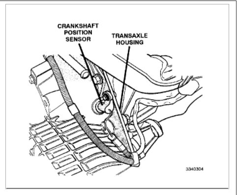

This sounds like you have a crankshaft angle sensor that is out here is a guide to help you see what you are in for when fixing the problem with diagrams below to help you see how it will be on your car.
Check out the diagrams (Below). Please let us know what you find.

Thanks for your reply. No the check engine light is not on and no, when it does not start at all, the engine does not turn over. No sounds, nothing.

When a crankshaft angle sensor goes out it won't trigger a check engine light most of the time.

After doing extensive research, I think I have finally found an answer to my car problem thanks BTW the crankshaft sensor was bad because I saw oil coming out of it. Once I replaced it all fixed! I love this site.
