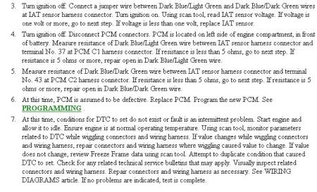

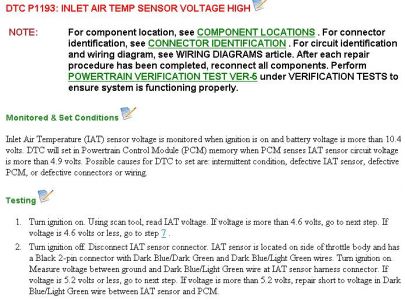

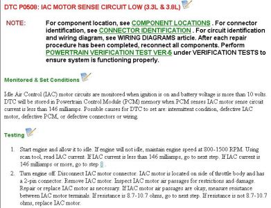

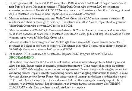

OBD code comes up P0508 & P1193. Car will turn over but wont fire and it is getting fuel and has pressure. The only thing I can find is a high voltage reading but I dont know where to go from there
Wednesday, January 21st, 2009 AT 10:12 AM
ZACKMAN
  • 4,202 POSTS
Hope this helps...
https://www.2carpros.com/forum/automotive_pictures/55316_DTC0508_1_1.jpg
https://www.2carpros.com/forum/automotive_pictures/55316_DTC0508_2_1.jpg
https://www.2carpros.com/forum/automotive_pictures/55316_dtc1193_1_1.jpg
https://www.2carpros.com/forum/automotive_pictures/55316_dtc1193_2_1.jpg
