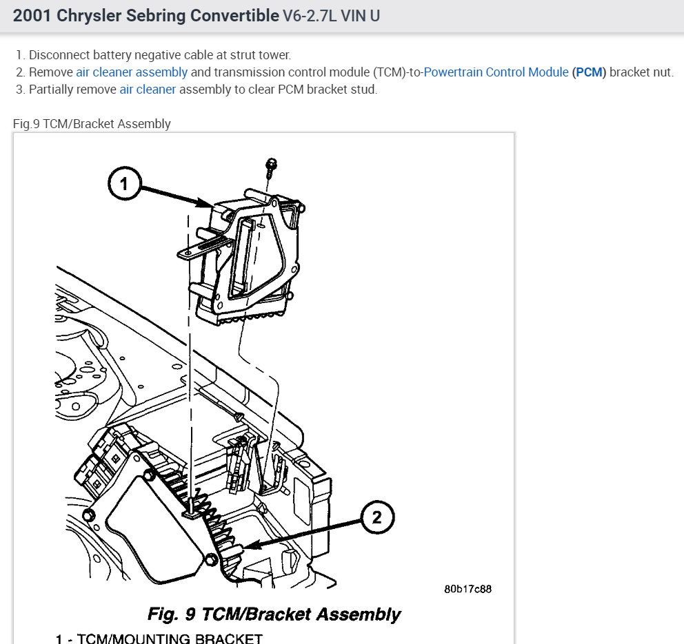

my 2001 sebring with automatic transmission and with 74000 miles is showing a error code of P0700 what is this code and what does it mean? will i need to replace my transmission? i need help please :( :(

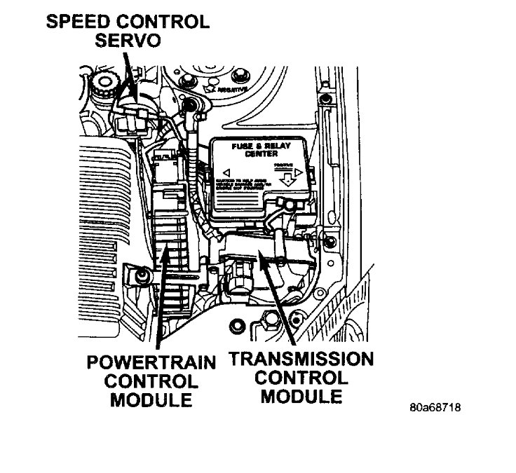

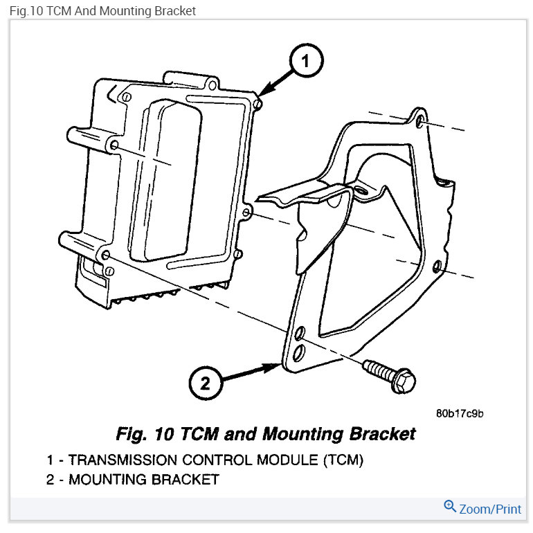

Here is what the error code is:
# P0700 Transmission Control System Malfunction
There is a lot of information about known problems with TCM I would start by checking the electrical connector for corrosion. Here is the location in the diagrams below. Check out the diagrams (Below). Please let us know what happens.
Cheers
Sep 20, 2007 at 3:04 AM
JNOBLES
I had this problem as well I got a used TCM the car shifts great! FYI.
