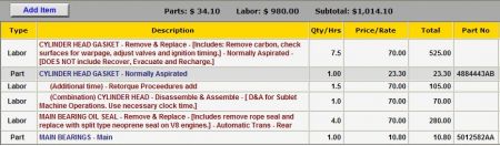

I have a 2004 PT Cruiser that has an bad head gasket and is leaking oil. I wanted to know if $1163 was a good price to repair the head gasket. I was also told the rear seal is bad too and needs to be replaced. I was quoted $563 to replace the rear seal. Just wondering if these on decent price quotes.
Jul 17, 2019 at 6:41 AM (Merged)
BLUELIGHTNIN6
  • 16,542 POSTS
Seems a little overpriced on BOTH quotes to me... Below is an average estimate for having both the head gasket AND the rear seal replaced on your Cruiser..

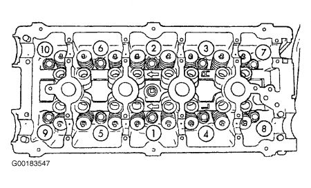

KINKIE321
2003 Chrysler PT Cruiser
blew a head gasket and need to know what the torque is on the bolts.
Jul 17, 2019 at 6:42 AM (Merged)
2CARPRO JACK
  • 11,533 POSTS
2.4 DOHC step1-25 ft lbs step2-50 ft lbs step3-50 ft lbs step4- Tighten an additional 1/4 turn tightening sequence
