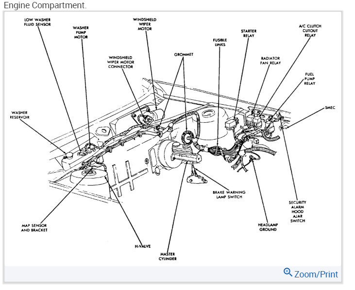

So I changed the fuel pump before I tested it. The old one worked but I cannot return the new one. After testing both fuel pumps I realized that there is no power going to the fuel pump. What can I do? Is this common for this car?

It sounds like the fuel pump relay is not working. Here is a guide to help you test it and the location of the relay below:

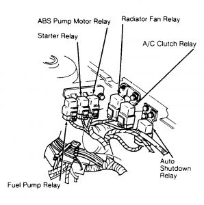

The ASD relay is in the engine bay forward of left strut tower. See picture below. I do not know about the computer yet. Check basics before you go there.
https://images.2carpros.com/forum/automotive_pictures/12900_asd_5.jpg
Jul 19, 2018 at 5:48 AM (Merged)
STEPCHILD
  • 6 POSTS
Although the picture is not representative of my particular model, (1992 convertible) I did find the ASD relay and checked it with multi-meter. Seems to be functioning fine. Any other suggestions? By the way, I really do appreciate the help.
