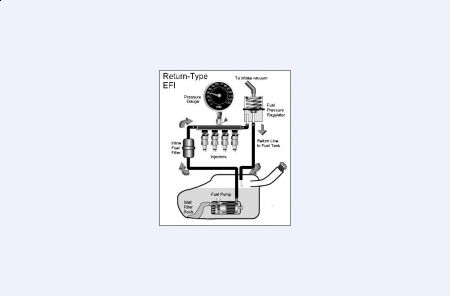

Ok, so I just got my haynes manual in the mail today and it says to connect a pressure test gauge using a tee fitting before the fuel rail and to clamp the hose to isolate first the fuel rail, then the pump to watch for static pressure drop. My question is where do I connect the tee into the existing line? I can't see the line under the hood. Is there somewhere under the car I can connect it?
-1
Monday, March 16th, 2009 AT 6:56 PM
  • 75,992 POSTS
Check the fuel rail for a schrader valve/test port
https://www.2carpros.com/forum/automotive_pictures/12900_fuel_pressure_system_circuit_11.jpg
Monday, March 16th, 2009 AT 7:56 PM

I picked up a pressure gauge and checked the pressure today. With key on and with car running I'm reading about 59psi (Haynes says 53-63), but as soon as the pump shuts off the pressure drops to about 15 psi withing 5 seconds and down to under 5 psi within 20 seconds. I'm also hearing a noise from the tank as the pressure drops. Is there any way this can be leaking injectors, or is it pretty safe to assume it's a leaking pump check valve at this point.
Saturday, March 21st, 2009 AT 4:00 PM
  • 75,992 POSTS
Could be the injector/s, pressure regulator/fuel pump check valve you need to investigate thoroughly. You're losing pressure fast

I think I figured out a way to do further testing that makes more sense than my last question. I connected to the schrader valve on the fuel rail to do the first pressure test. That confirmed that I have a leak somewhere in the system. Now in order to isolate the leak I assume I need to run the pump with the gauge connected and quickly pinch off the line somewhere before the injectors once the pump stops. If the system holds pressure, then I assume the injectors are not leaking and replace the pump. If it doesn't hold pressure than I start with removing the fuel rail to see which injectors are leaking. Does that make sense? I'm just trying to figure out where I can pinch off the line.
