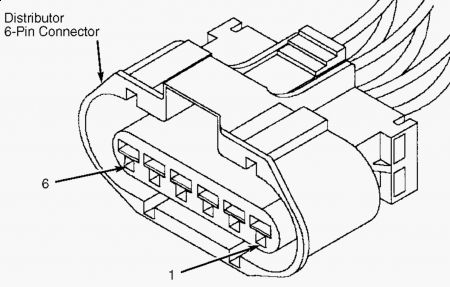

Were is cam sensor located? 1996 chrys. Cirrus 2.5 eng. Also I checked green w/ orange tracer to distibutor, ign. On test llight on 2 sec, crank eng. Test light pulses. Checked injector supply and injector pulse is good. All 6 pin conn. Wires has voltage, 4.9 to 8.0 volts. Checked distributor rotor rotation is good. Checked grd. To ign. Driver circuit get pusating voltage. Is there a way to check ign. Coil and ignition modual.

I do not have a hessitation on acceleration. I have a cranks no start condition. I found the imformation I needed at the auto parts, they let me look at one of there manuals. I checked resistance across 2 pin conn. At distributor got 1.1k ohms should be.6 ohms -.8 ohms. And 2 pin conn. Each of the terminals at once to the coil tower and got 5k ohms. On each, should be 12k ohms - 18k ohms. Checked distributor cap got 6k ohms should be 5k ohms. So im assuming coil is bad.

COIL TEST 1. Turn ignition off. Disconnect distributor 2-pin connector and coil wire. Using a DVOM, measure resistance of primary and secondary coil circuits. Measure primary circuit resistance between distributor 2-pin connector terminals (on distributor). 2. Measure secondary circuit resistance between each terminal of distributor 2-pin connector (on distributor) and coil tower. See IGNITION COIL RESISTANCE table. If resistance is within specification, ignition coil is okay. If resistance is not within specification, replace ignition coil.

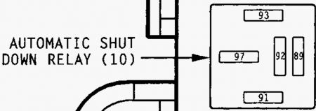

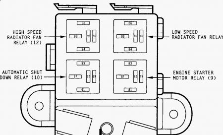

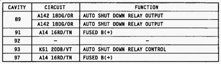

Got no spark out of high tension tower checked voltage at 2 pin conn. Dark green /orange wire w/ voltmeter - pos. Lead to green/ orange wire - neg. Lead to eng. Grd. Got less than 10 volts, 3 milli volts. Next step says to repair open at ASD relay output circuit. What is that, location, schematic. Had my leads cossed, pos. Lead to + pos. Neg. Lead to green/orange wire at 2 pin conn, got more than 10 volts. ASD relay checked good. Next step.

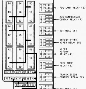

ASD=Auto shutdown relay, it's in the under hood fuse block Located in position 10 Here's the diagrams and cavity #'s for testing.

Checking coil primary, at 2 pin conn. At the distributor across the 2 terminals, on the 200 ohm scale I got 1.1 ohms, should be.06 -.08. Checking coil secondary, on the 20k ohm scale I got 5000 ohms, should be 12,000 - 18,000 ohms. Does this mean my coil is bad.

It seems by these numbers it is, take it with you to the parts store, most can test it before you replace it. How did ASD pin 89 testing go?

ASD relay circuit check out good. Had my leads crossed when checking 2 pin conn. Green/orange wire. Checking it the right way. Checked out good.

I dont know were to find the manufacture date for the distributor. The only numbers I found on the distributor were T5T7172 and 1917VC.
But got a distributor from junk yard for 50.00 bucks.
Checked the coil seconary readings on junk yard distributor and the readings are within specs. Going to install it this morning.
XXXXXXXX replacing the distributor fixed it. XXXXXX
