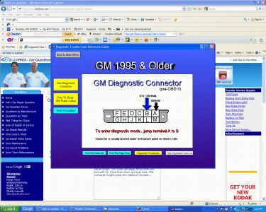

If you can figure out what it came out of, you could get specific info, but a 4.3 is a 4.3...Did you try looking for codes yet? Cross the A and B terminals of the data link connector under the dash, turn the key on, and count the flashes.

PROCEDURES FOR READING GM FLASH CODES
1. Turn the ignition switch ON but do not start the engine.
2. The "CHECK ENGINE" light come on indicating the bulb is working. If the light fails to come on, the bulb may be burned
out or there may be a problem in the Check Engine light circuit.
3. Locate the diagnostic connector for the computer. It is usually located under the instrument panel near the steering
column. Insert a jumper between the "TEST" and "GROUND" terminals.
CAUTION: Refer to a shop manual for the proper terminal locations. Jumping the wrong terminals may cause damage to the
computer system!
4. The Check Engine should now flash. The first code should be a code 12 (Flash, Pause, Flash Flash). Code 12 will repeat
two times.
If any other trouble codes are in the computer's memory, they will be displayed in numerical order starting with the lowest
number, and repeat three times. The codes will continue to repeat as long as the test terminal remains grounded.
NOTE: BE SURE TO WRITE DOWN ANY CODES THAT ARE PRESENT
NOTE: GM may use the same code number for different faults on different models of vehicles. That's why some code
numbers list more than one possible cause.
5. To exit diagnostic mode, turn ignition switch off and remove the jumper.
