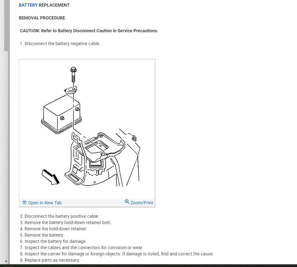

i went out to start the van and the battery did not have any power so i tried jumping it off and the battery post sparked fire. i had the alternator checked and it was bad. so i replace it and it still did the same thing. what could it be?
Jan 24, 2017 at 8:50 AM
If the battery was drained and you found the alternator was not charging and you replaced it, we still have to deal with the battery issue.
Once a battery is completely drained then it is unlikely to recover and be reliable. This means we need to start with getting the battery checked so that we can find out if the battery is ok.
Here is a guide that will help with this:
If the battery is okay and it still drains, then we need to find out if there is a draw on the battery.
https://www.2carpros.com/articles/car-battery-dead-overnight

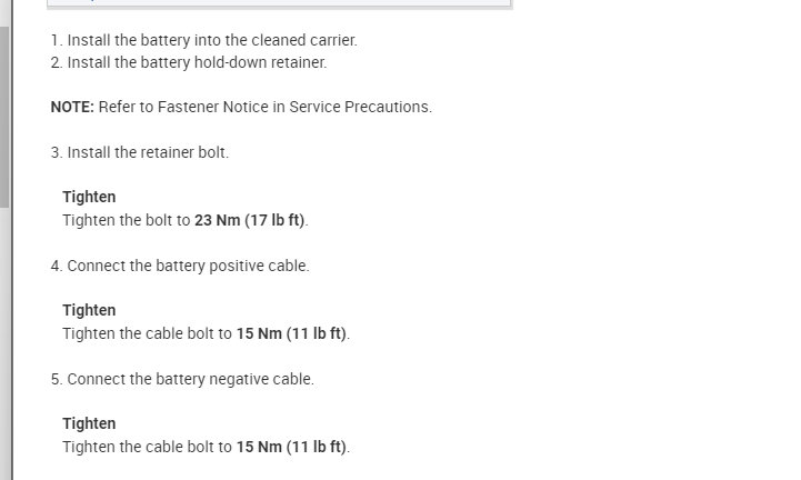

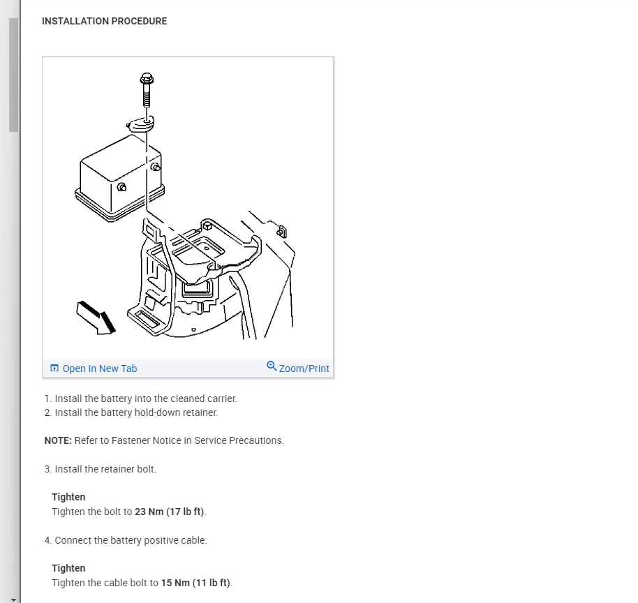

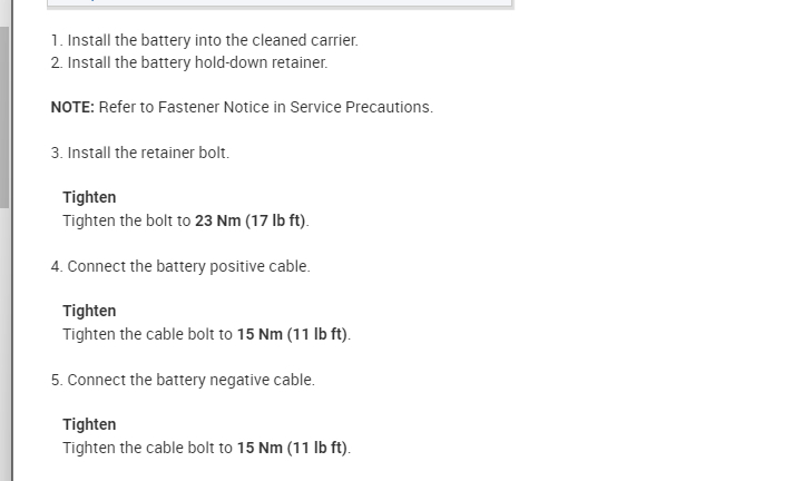

I suspect there will be an issue with the battery, and we will need to replace it so here is the info from the manual that will help with this.
https://www.2carpros.com/articles/how-to-replace-a-car-battery
Please see below for the info from the manual. Let us know what you find, and we can go from there.
