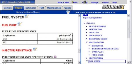

then we pulled the fuel line from the filter to make sure it wasnt clogged and it came out just fine.. It came out fine but is it the correct fuel pressure? If not it will never make it to the injector/s.. You need a fuel pressure gauge to determine the correct pressure. What liter engine do you have, below is for 305 and 350 also the type of injection is it CSI or SFI
https://images.2carpros.com/forum/automotive_pictures/12900_fuel_pressure_1.jpg
