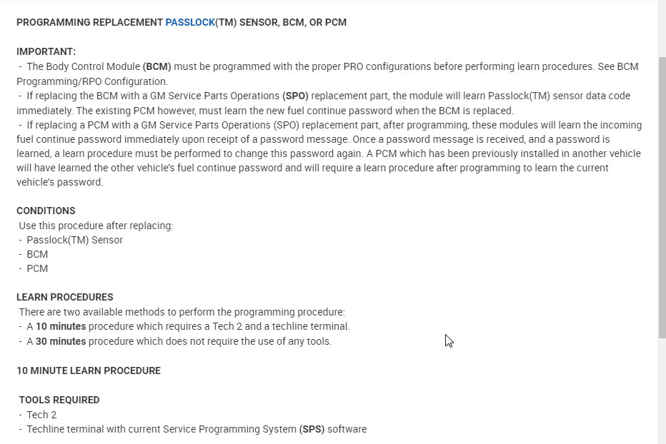

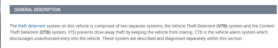

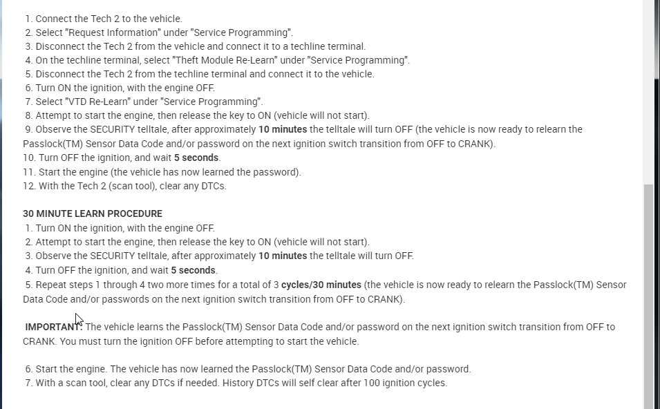

Most likely the theft system needs to be reset as when a module like the BCM is replaced. Unfortunately this can only be done with a proper scan tool capable of doing it.
What happens at times when unhooking the battery, the BCM thinks someone is trying to steal it so it shuts down to prevent this.
I highly expect that this can be resolved quickly by a dealer or shop with the proper scan tool.
See the attachments for more details. Thanks
