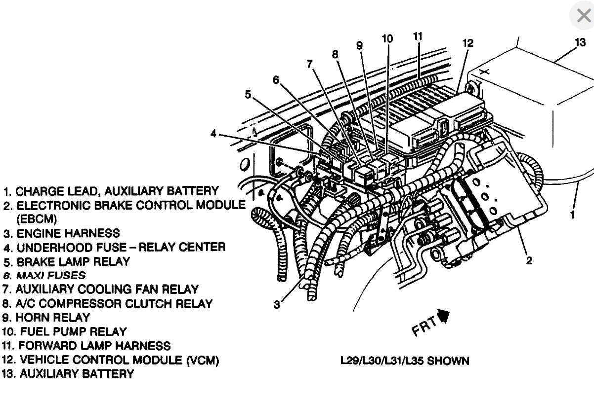

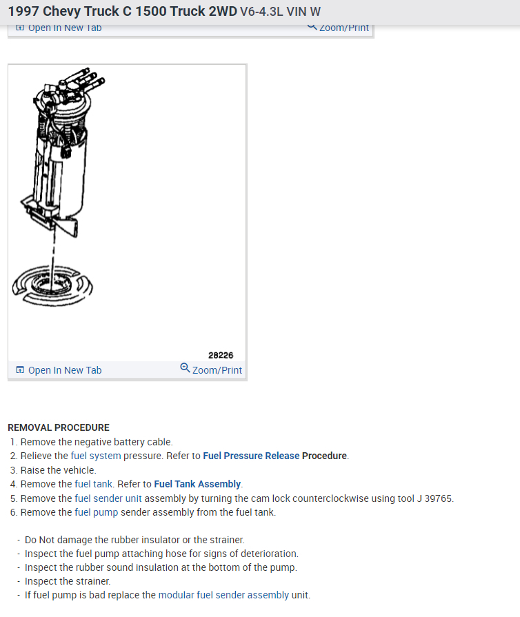

A fuel pump can be inoperative due to a bad relay, wiring harness or the pump itself.

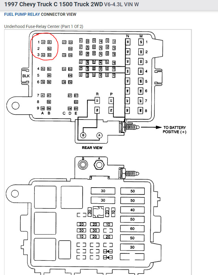

First check the relay.
The fuel pump relay is located in the fuse block under the hood (see diagram).
Check the relay for any corrosion or burnt pins.
You can also test the relay:
If the relay is good. Then check to see if you are getting power to the fuel pump connector. If there is no power with the key on then you have a faulty wiring. Possibly a short in the harness.

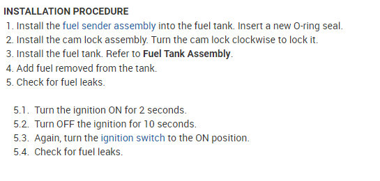

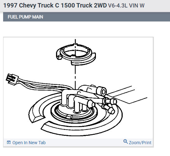

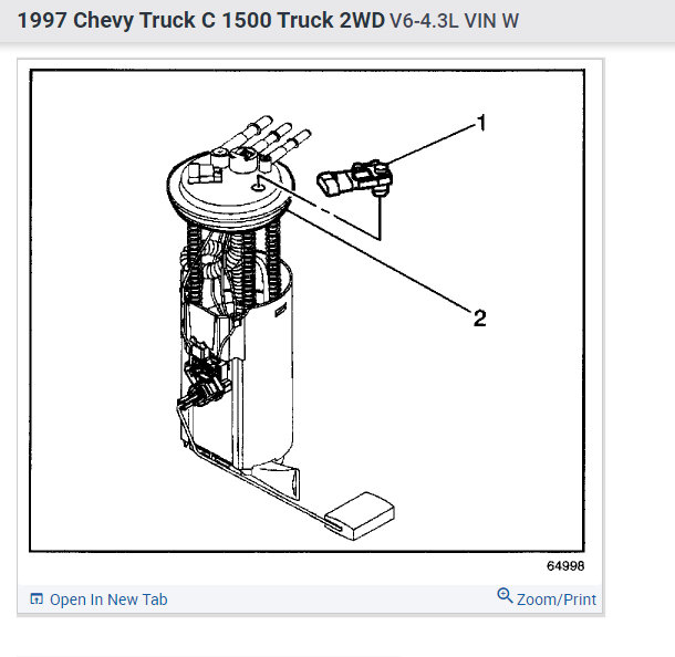

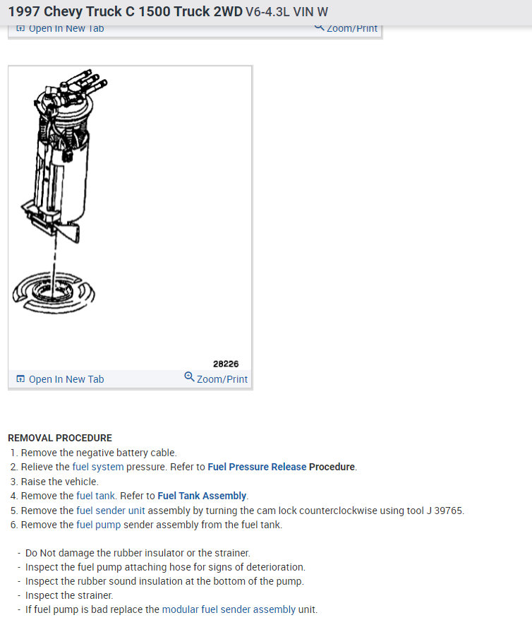

If there is power to that connector, then it is likely a bad fuel pump. In order to replace the pump you will have to drop the fuel tank.
https://www.2carpros.com/articles/how-to-replace-an-electric-fuel-pump
I have attached the diagrams for your reference.
