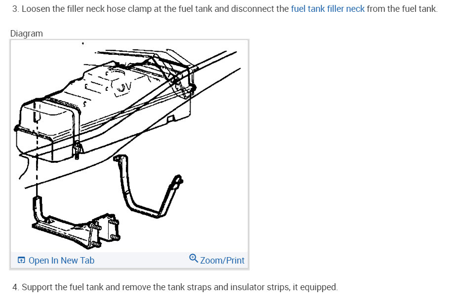

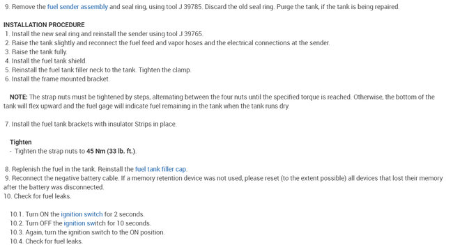

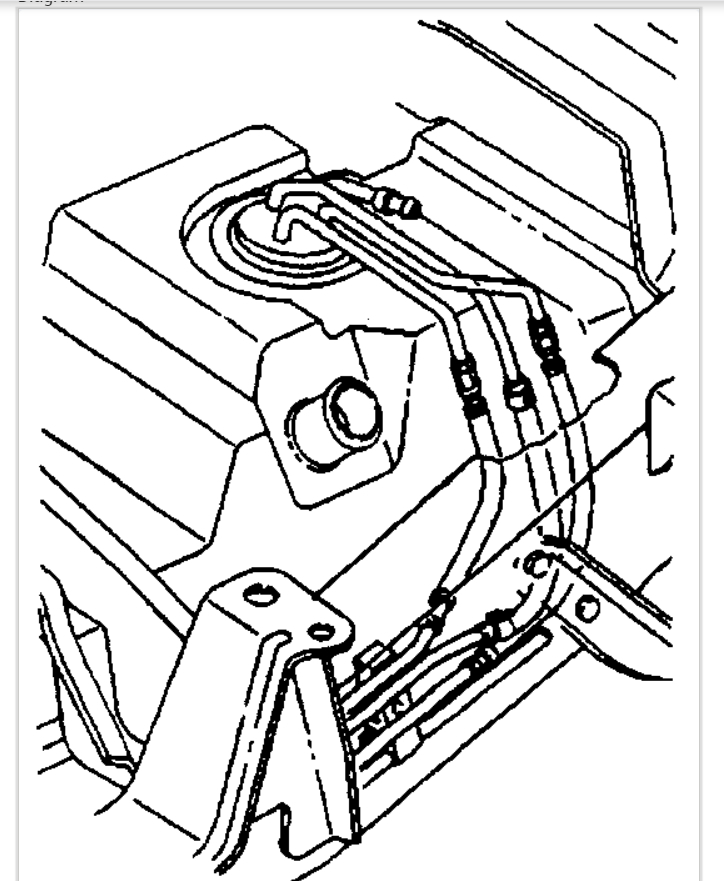

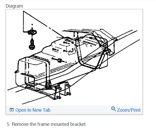

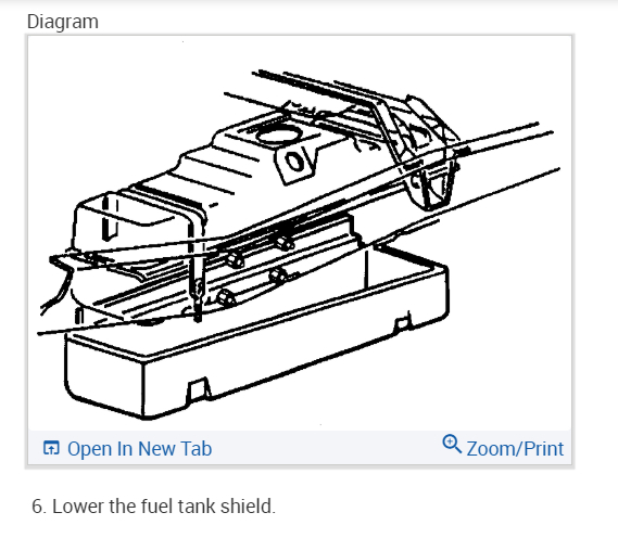

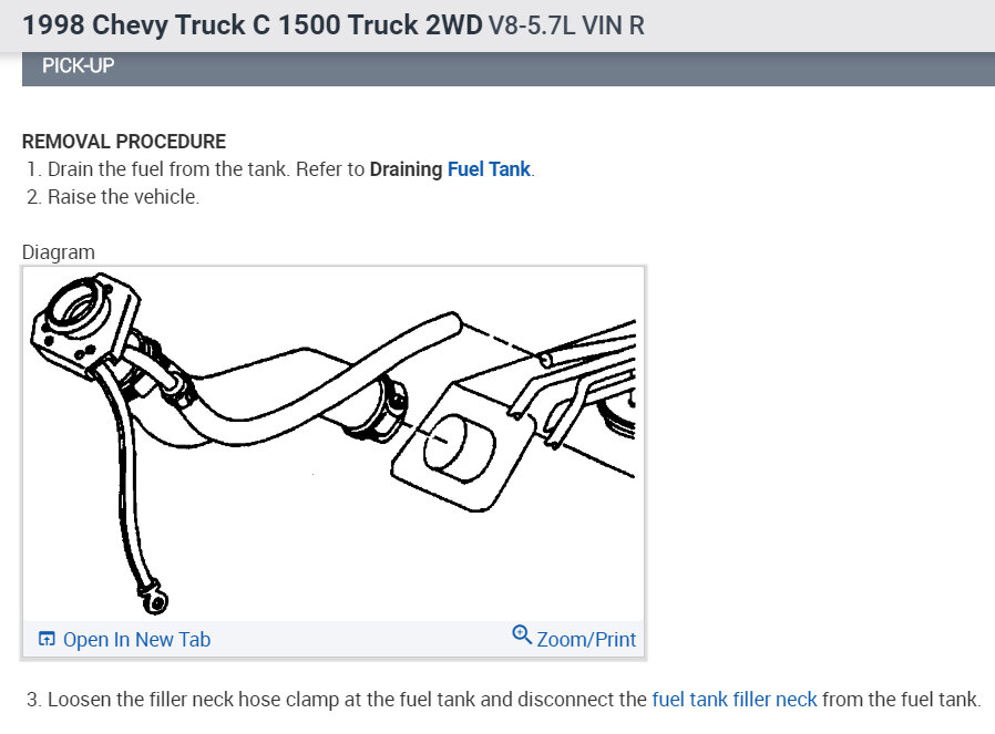

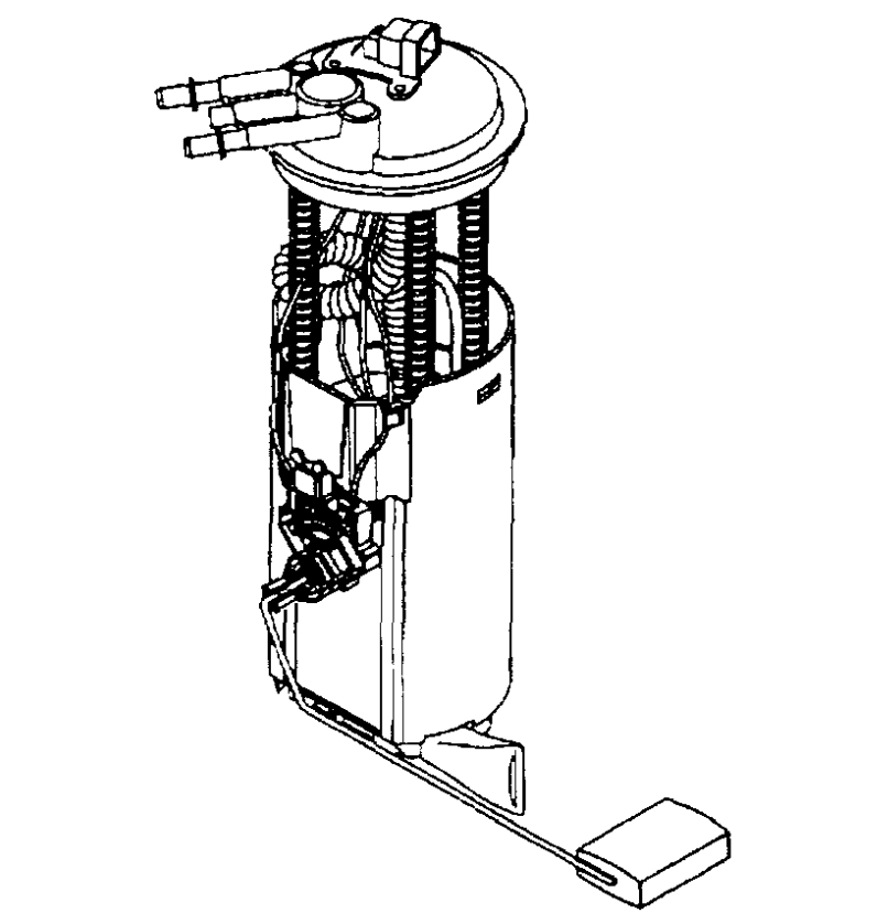

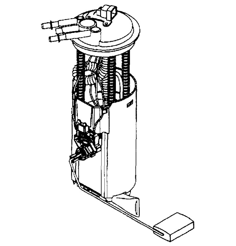

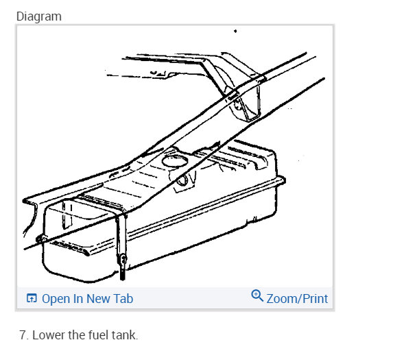

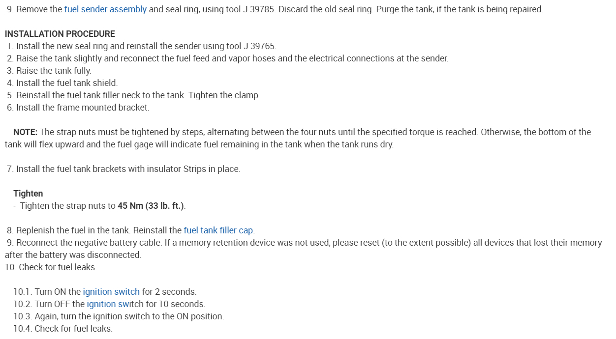

Hi natisdad, Welcome to 2carpros
Check the fuel pressure if its 60-66 psi and also test the fuel pump. 9 times out of ten it will be the fuel pump even though you can hear it running it loses pressure, here are the instructions on how to fix the problem and a guide that can help as well.
Check out the images (below). Let us know how it goes
