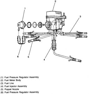

Hook up the fuel pressure tester back and pinch the return line did the pressure increase? If so replace the regulator
What is the liter engine? 5.0 or 5.7 type of injection system

  • 75,992 POSTS
https://www.2carpros.com/forum/automotive_pictures/12900_fpr_31.jpg
