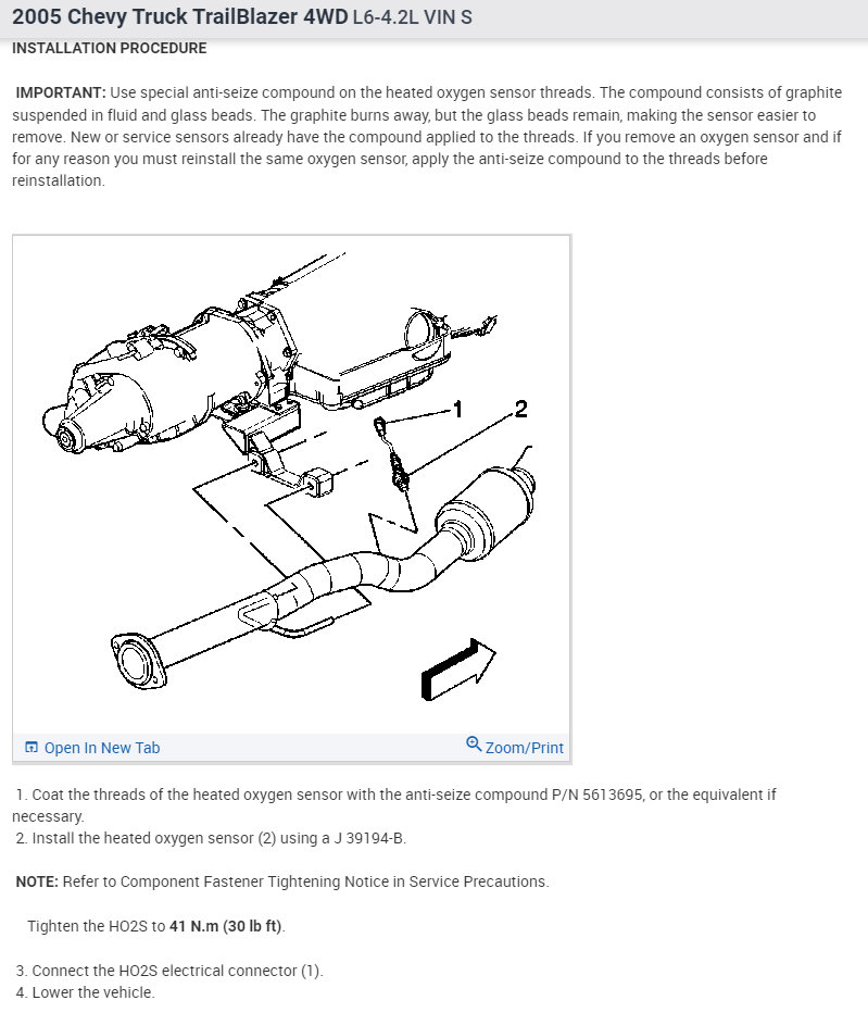

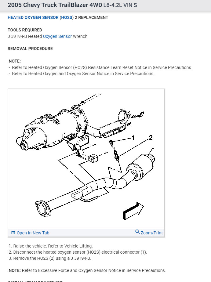

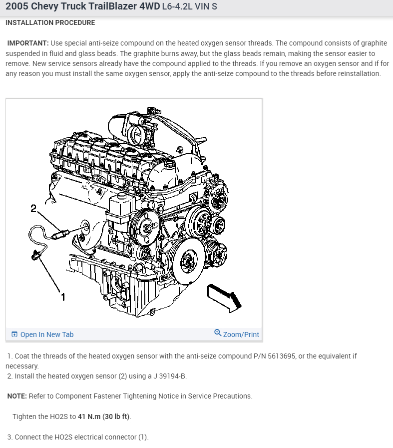

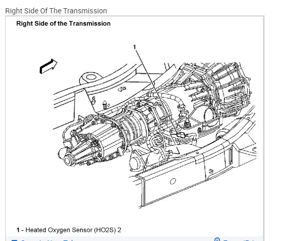

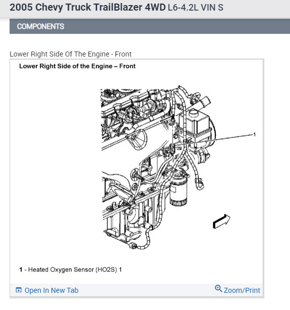

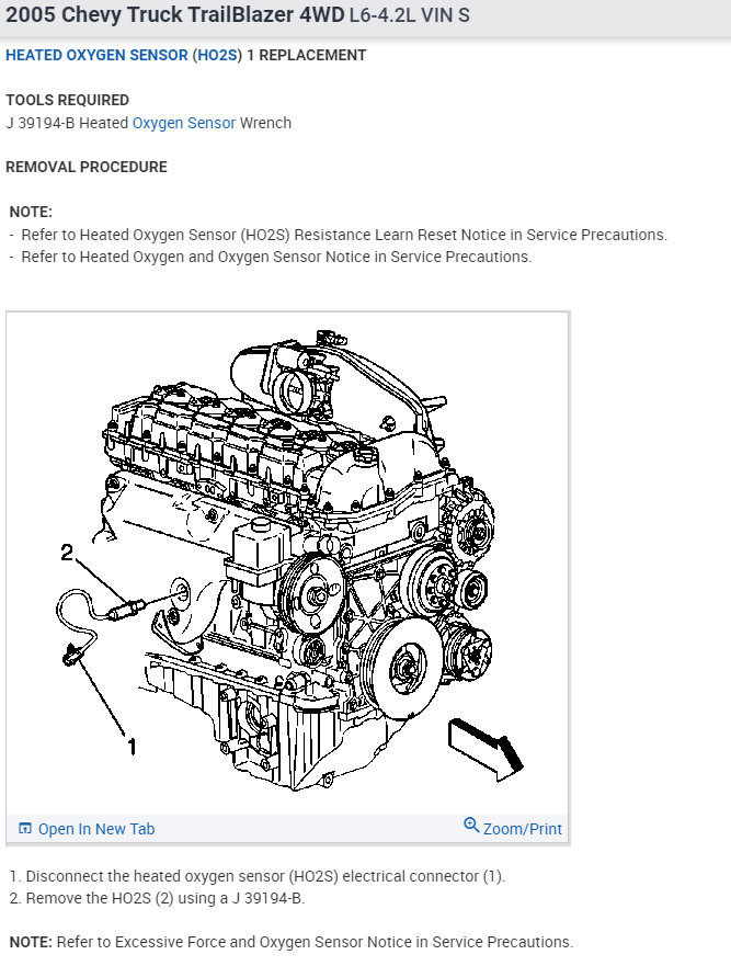

Where are the oxygen sensor located on this vehicle?
2002 CHEVROLET TRAILBLAZER
LEVERT SHELL
where are the oxygen sensor located on this vehicle

This vehicle is equipped with 2 oxygen sensors.
One is located on the exhaust manifold, which is the upstream sensor; the second one is located after the catalytic converter on the exhaust pipe, which is the downstream sensor.
Here is a helpful guide on oxygen sensor replacement:
https://www.2carpros.com/articles/how-to-replace-an-oxygen-sensor
I have attached diagrams showing the locations replacement procedure for both of the sensors.
