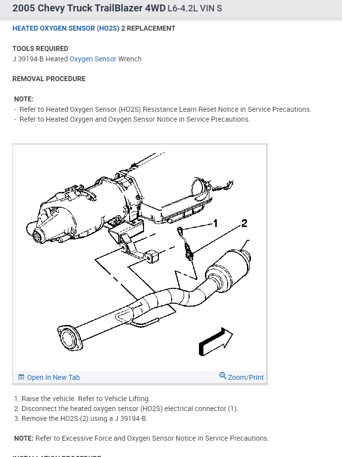

Where is the 02 Oxygen Sensor located and can this be replaced from the ground vs. elevated

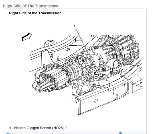

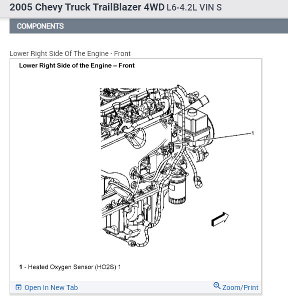

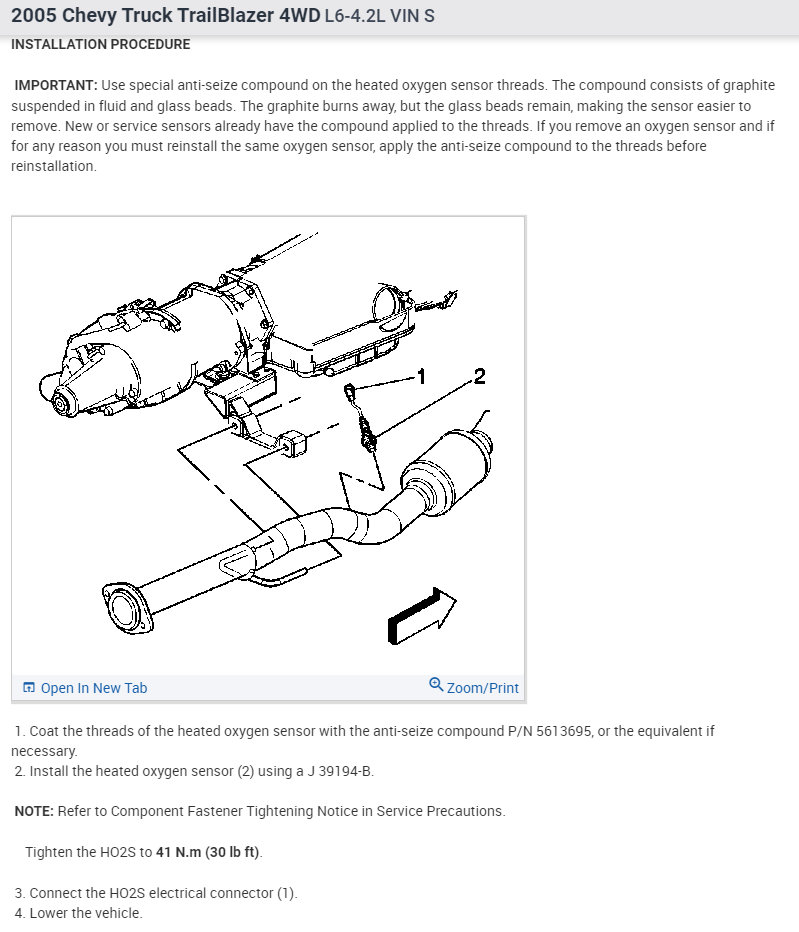

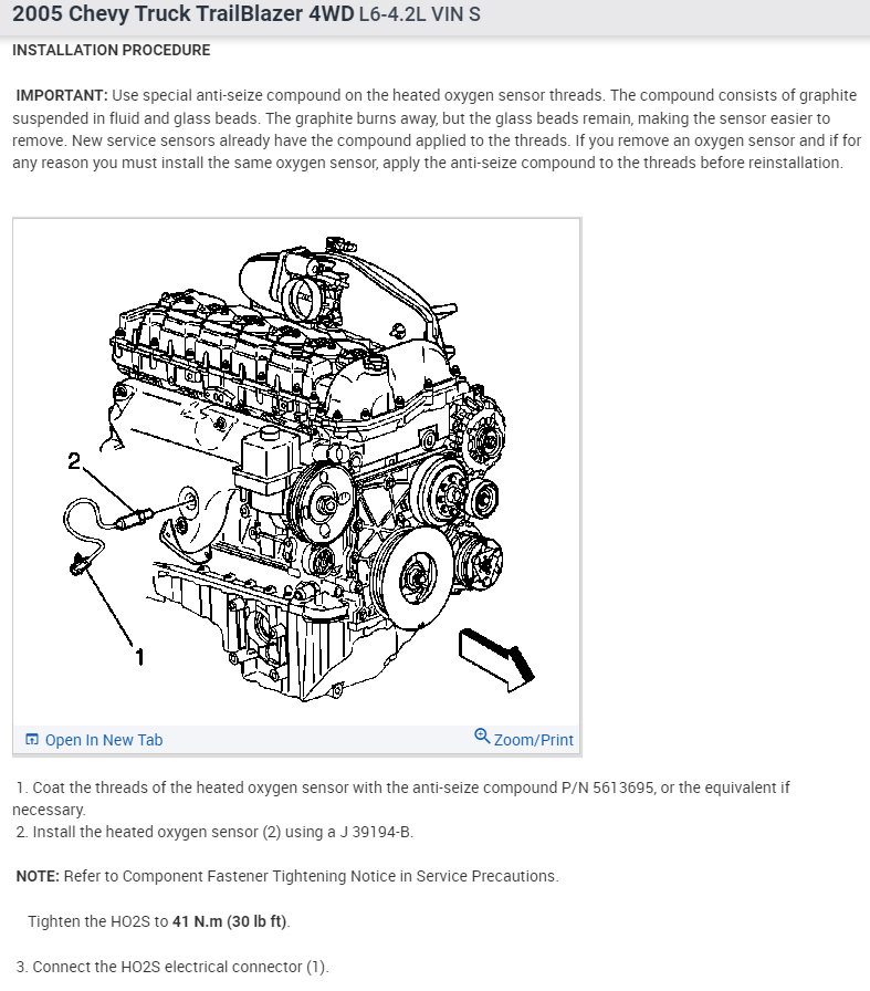

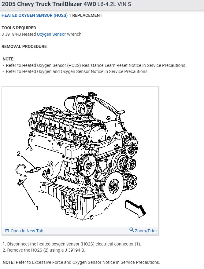

This vehicle is equipped with 2 oxygen sensors.
One is on the exhaust manifold and the second one is after the catalytic converter on the exhaust pipe.
It will be best to replace them from under the vehicle. It will provide easier access. The one after the converter must be replaced from the bottom.
Here is a helpful guide:
https://www.2carpros.com/articles/how-to-replace-an-oxygen-sensor
I have attached diagrams showing both of the oxygen sensors as well as replacement instructions below.
