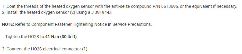

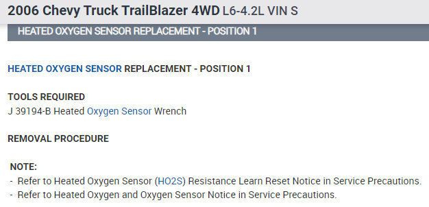

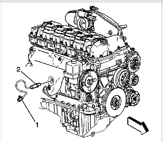

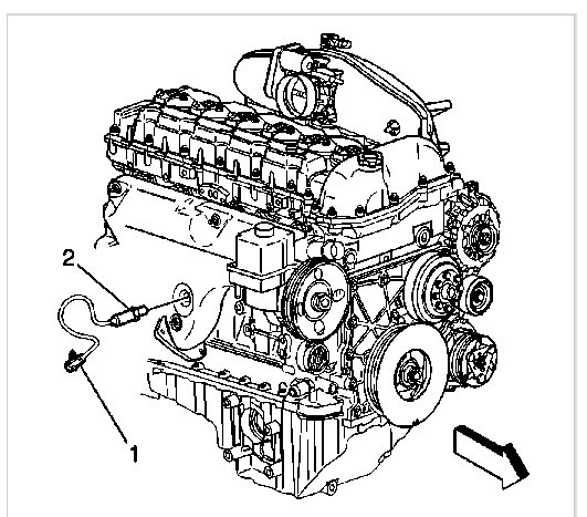

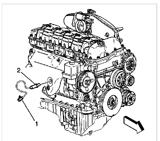

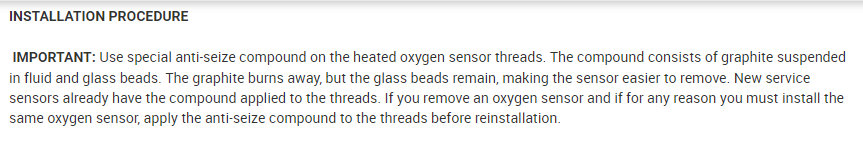

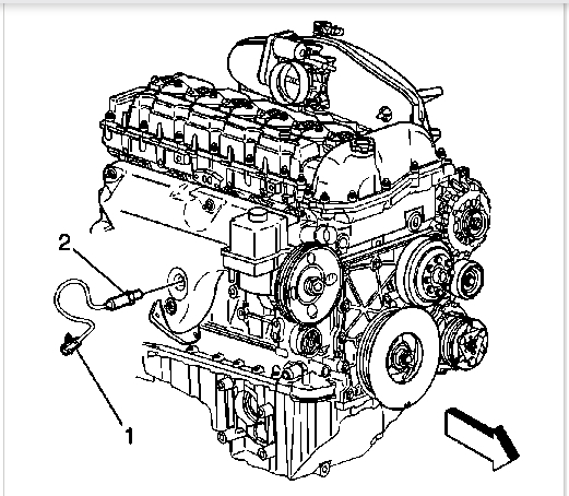

The bank 1 sensor 1 oxygen sensor is bad and my wipers are not turning off?
Jul 4, 2016 at 4:15 AM
DANNY L
  • 5,648 POSTS
Hello, I'm Danny.

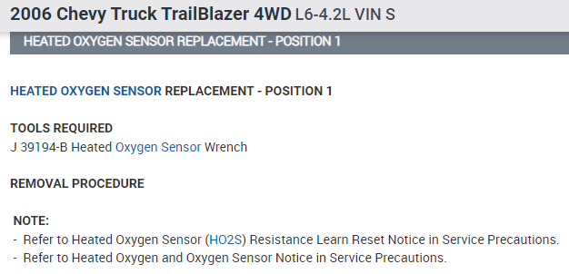

Here is the information you requested. Here is a tutorial for you to view showing how to change an oxygen sensor:
https://www.2carpros.com/articles/how-to-replace-an-oxygen-sensor
I've attached picture steps below on how to change the bank 1 sensor 1 oxygen sensor on your vehicle. Hope this helps and thanks for using 2CarPros.
