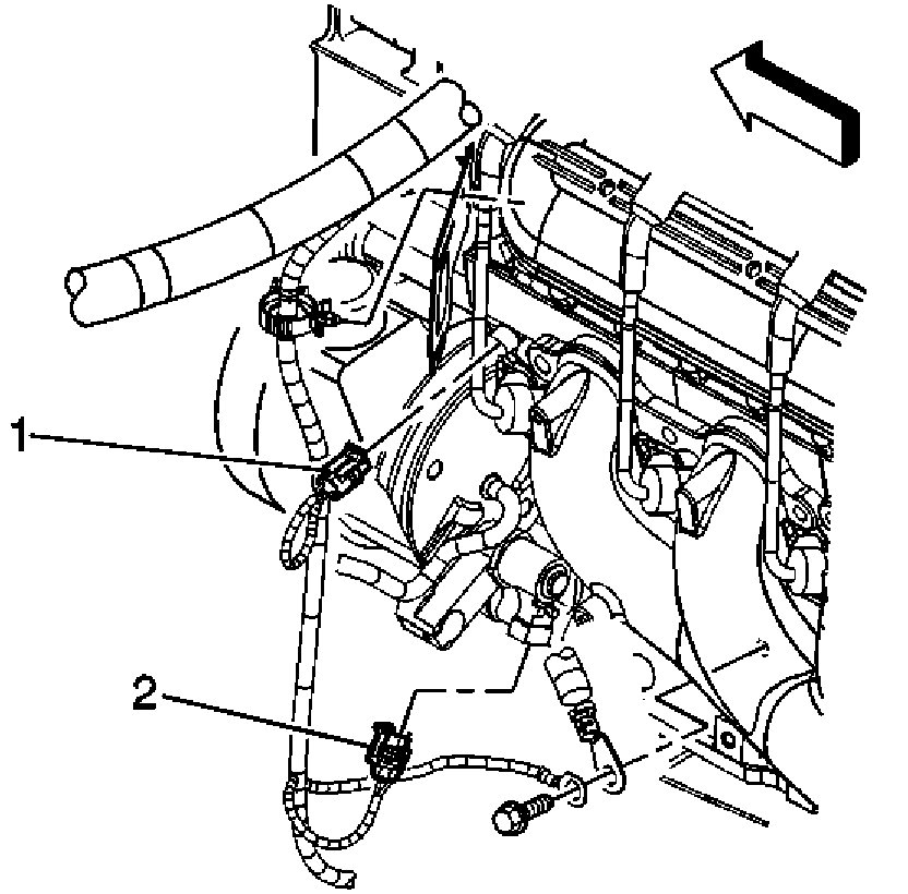

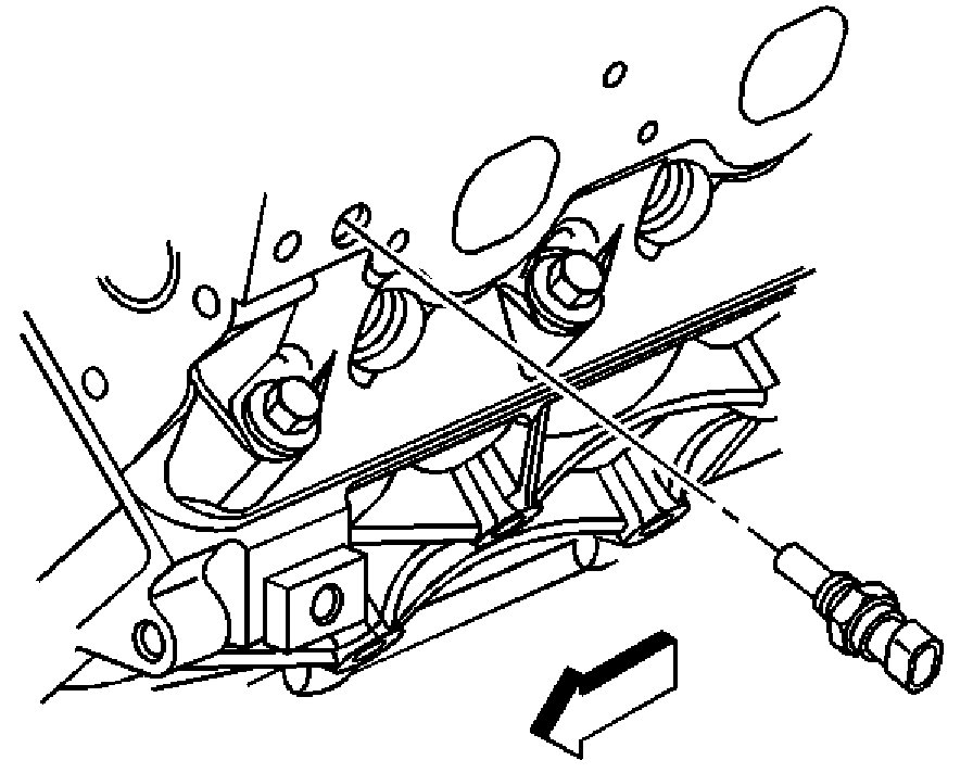

Here is some info you may find helpful. The attached pictures correlate with the directions. The link is a general description.
https://www.2carpros.com/articles/coolant-temperature-sensor-cts-replacement
ENGINE COOLANT TEMPERATURE (ECT) SENSOR REPLACEMENT
REMOVAL PROCEDURE
NOTE: Use care when handling the coolant sensor. Damage to the coolant sensor will affect the operation of the fuel control system.
picture 1
1. Drain the cooling system to a level below the engine cooling temperature (ECT) sensor. Refer to Draining and Filling Cooling System in Cooling System.
2. Disconnect the ECT sensor electrical connector (1).
picture 2
3. Remove the ECT sensor.

DTHOMP
  • 15 POSTS
Hey Joe,
I had the ECT Sensor replaced a week ago and the engine temp now gets up to 210, or close enough to it, but sometimes it takes a good 20 minutes of driving to reach it. I'm ok with that, it's an old car (16 yrs) with 300,000+ miles. When it reaches the 210 point, it does seem to run a little more efficiently, the fuel consumption appears to be a little better most of the time at 210. But the digital display (miles until empty) still likes to jump around quite a bit. If this was the "fix" I've been looking for, it took me spending upwards of $1000 in parts and labor, and then a $25 sensor made the most noticeable improvement. So it goes, right? If anything else noteworthy comes up, I will update you. Thank you again for all your help and attention.2CarPros. Com was an easy and valuable resource for me.
