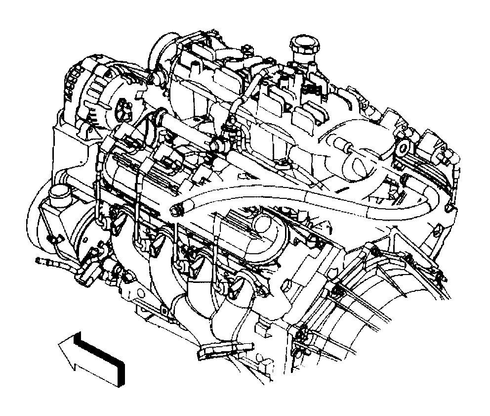

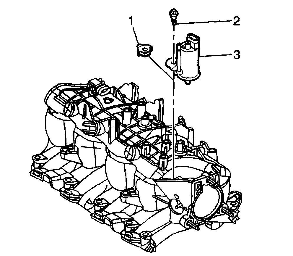

My first concern that needs attention is the intake vacuum leak. If the engine is getting unmetered air into the combustion chamber, it is going to cause a lean mixture at the O2 sensors. As a result, the computer is going to try to make the air fuel mixture richer. And yes, this will cause excessive fuel consumption.
To confirm there is a leak, here is a link that shows how to do it:
As far as the decrease in MPG when you stop, that is normal. The engine is running and consuming fuel, but the vehicle isn't moving. Therefore, the MPG will drop.

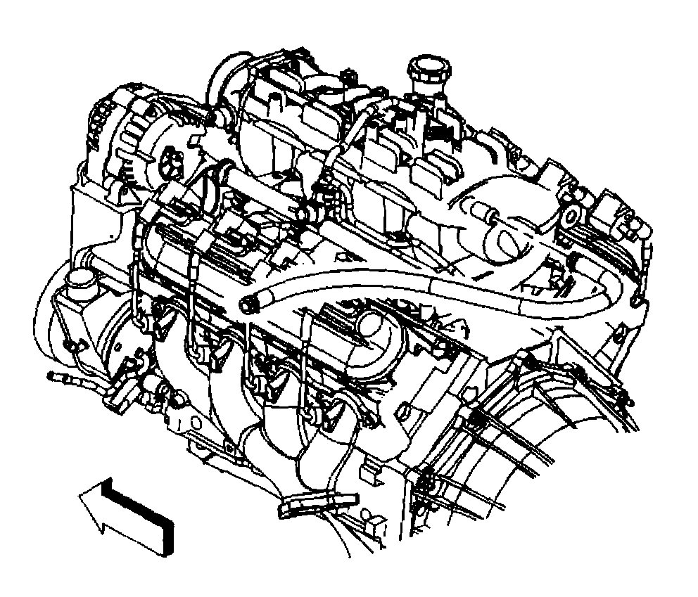

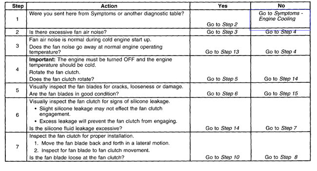

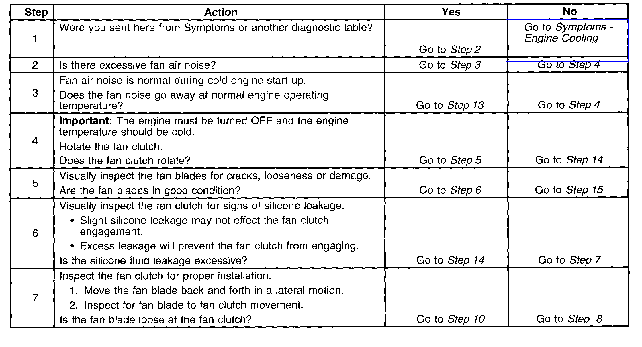

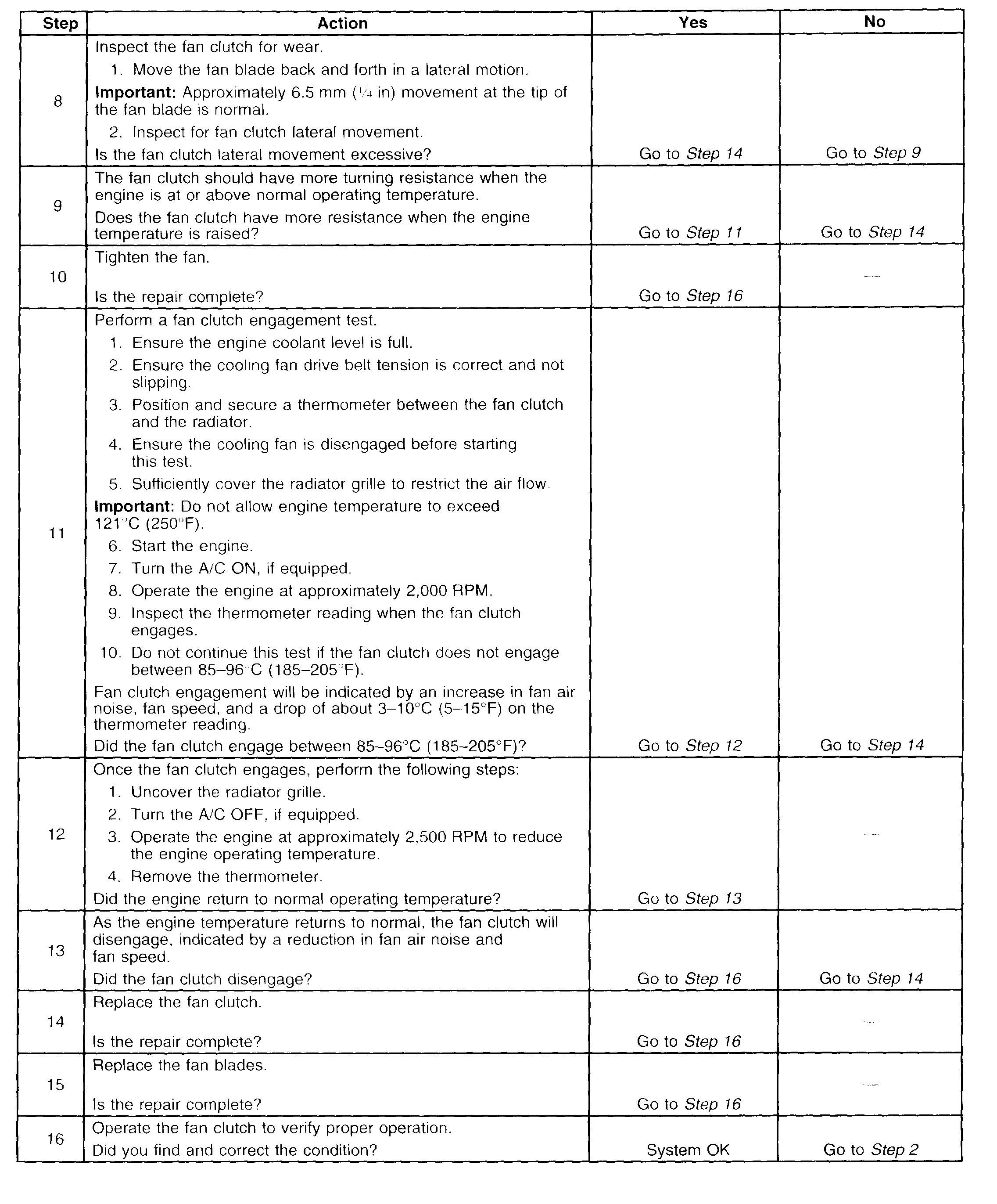

The other concern is the coolant temp. Follow the diagnostic flow chart in pictures 1 and 2 to determine if the fan clutch is bad. If may be fully engaged all the time which can cause the engine not to warm up properly.
One more thought. If you have access to a live data scanner, I need you to check the engine coolant temperature sensor reading when the engine is cold and at normal operating temp.
See if it seems accurate.

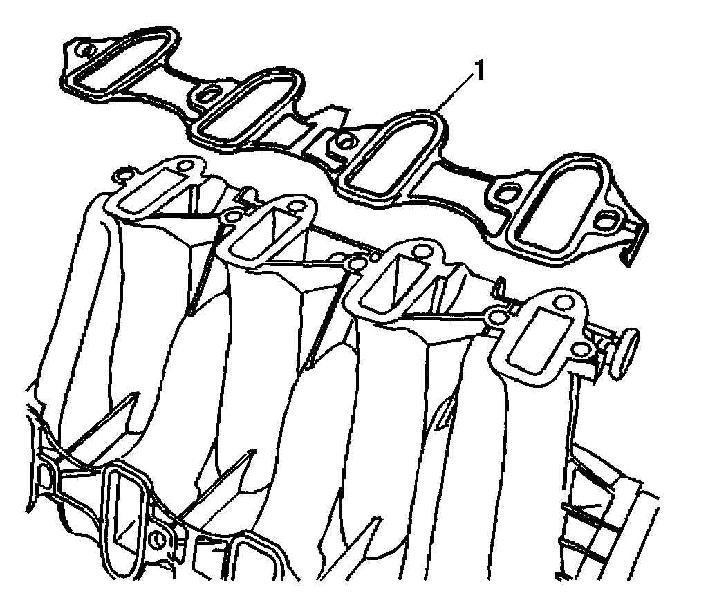

Of you confirm the intake is leaking, here are the directions for replacement of the gasket. The remaining pictures correlate with these directions (starting with number 3).
INTAKE MANIFOLD REPLACEMENT
Intake Manifold Replacement
Removal Procedure

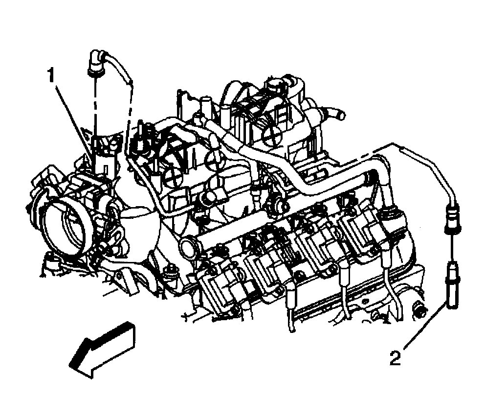

Important:The intake manifold, throttle body, fuel rail, and injectors may be removed as a complete assembly. If not servicing the individual components, remove the manifold as a complete assembly.
1. Remove the throttle body.
2. Remove the fuel injectors.
Picture 3

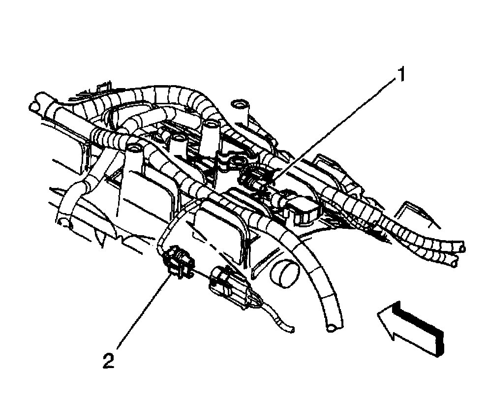

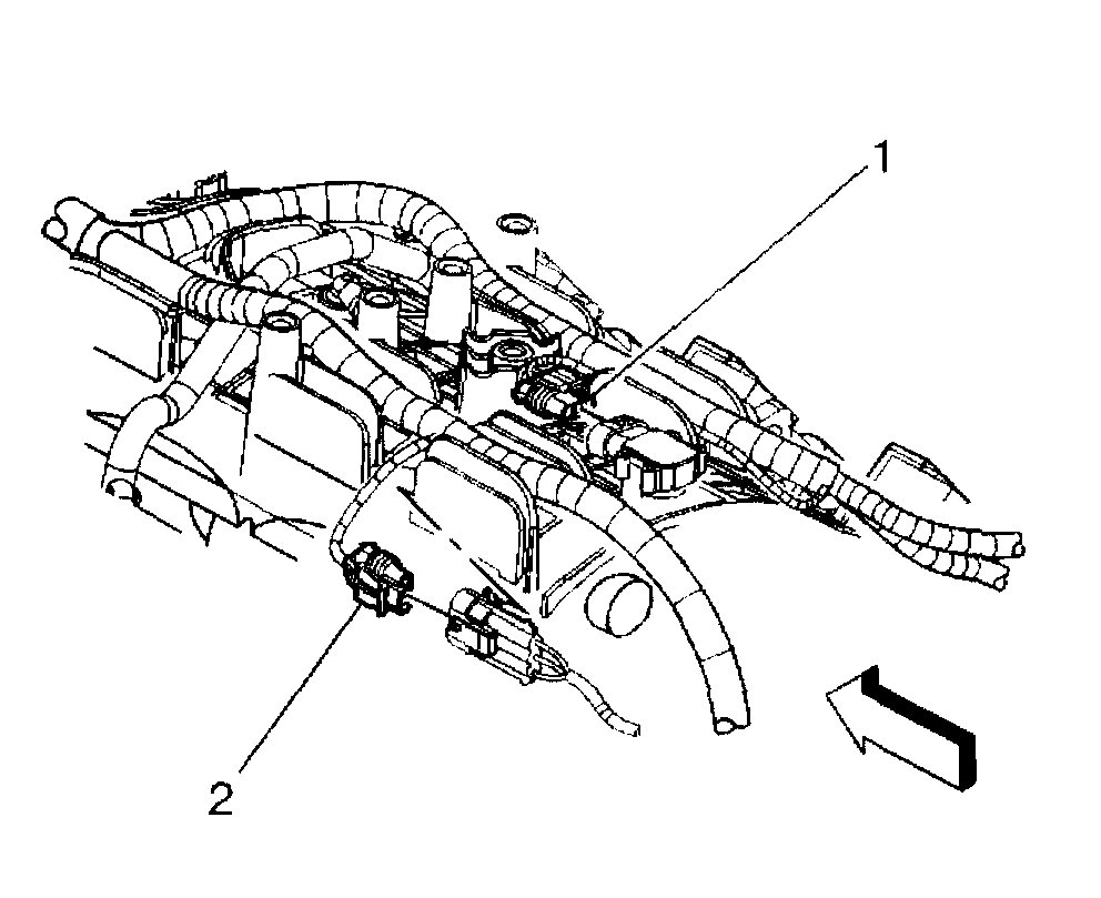

3. Disconnect the following electrical connectors:
- The Manifold absolute pressure (MAP) sensor (1)
- The knock sensor (2)
4. Remove the knock sensor harness electrical connector from the intake manifold.
5. Set the electrical harness aside.

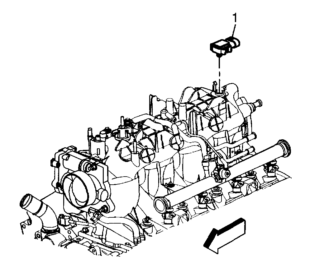

6. If equipped with vacuum assisted brakes, remove the vacuum brake booster hose from the rear of the intake manifold.
Picture 5

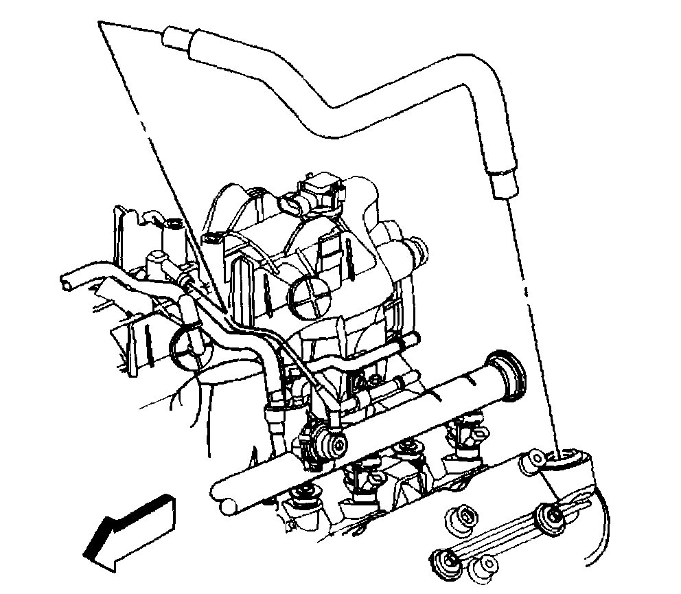

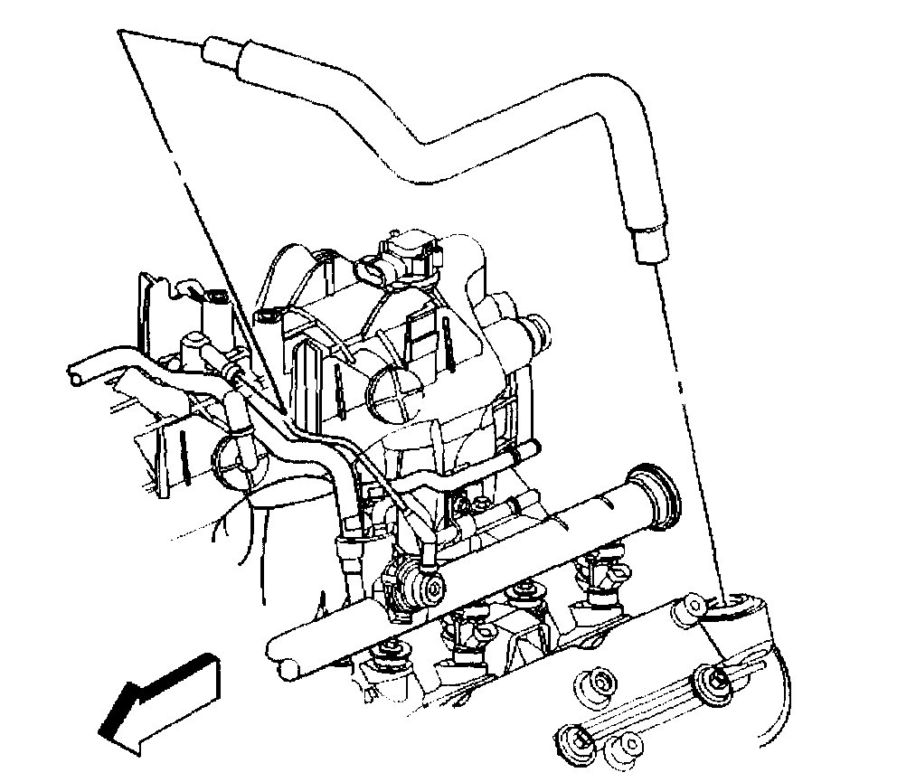

7. Remove the Positive Crankcase Ventilation (PCV) hose with valve.
Picture 6

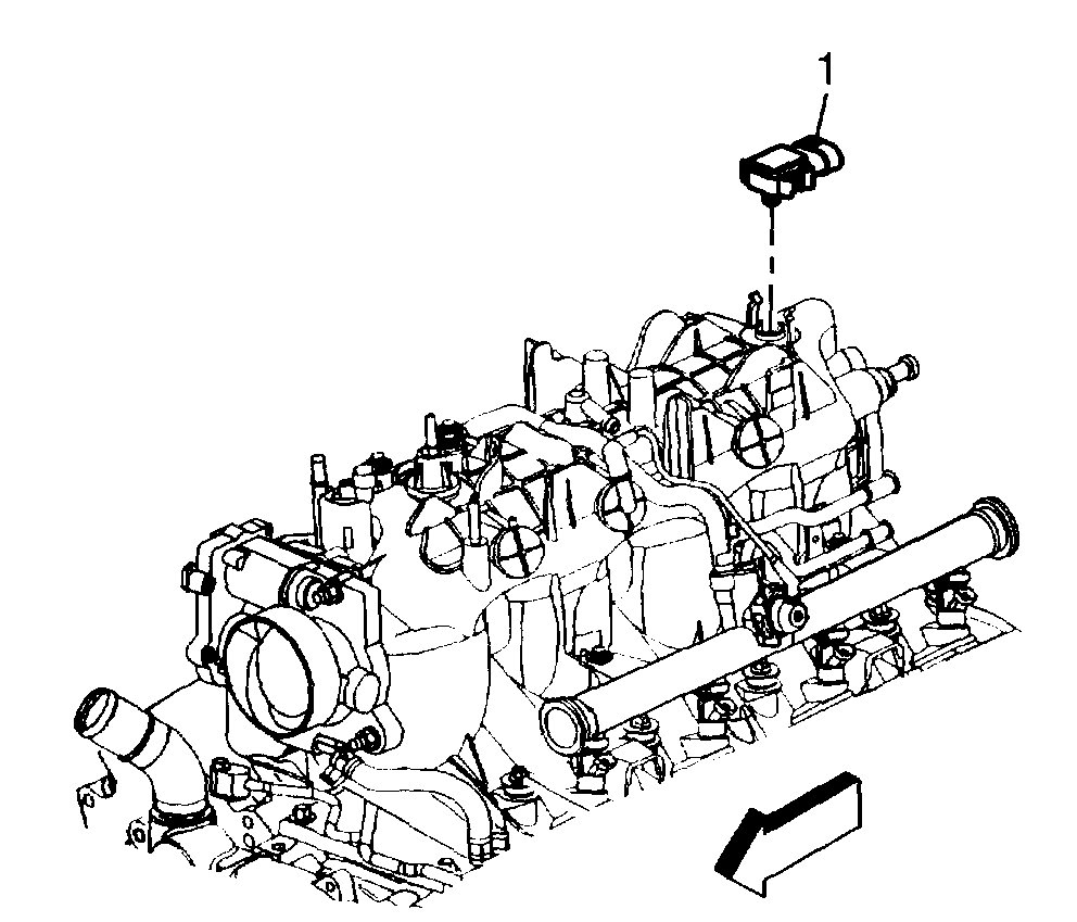

8. Remove the MAP sensor (1) from the intake manifold.
Picture 7
9. Remove the Evaporative Emission (EVAP) purge solenoid vent tube by performing the following:
9.1. Remove the EVAP tube end from the solenoid (1).
9.2. Remove the EVAP tube end from the vapor pipe (2).
Picture 8

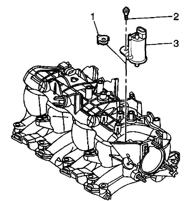

10. Remove the EVAP purge solenoid bolt (2), solenoid (3), and isolator (1) from the intake manifold.
Picture 9

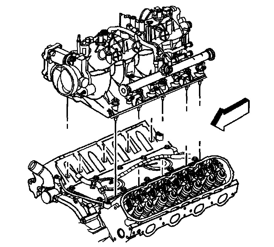

11. Loosen the intake manifold bolts.
12. Remove the intake manifold.
Picture 10

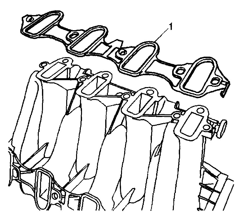

13. Remove the intake manifold gaskets (1) from the intake manifold.
14. Discard the old intake manifold gaskets.
15. If required, clean and inspect the intake manifold.

1. Install NEW intake manifold gaskets (1) to the intake manifold.
Picture 12
2. Install the intake manifold.
3. Apply a 5 mm (0.20 inch) band of threadlock GM P/N 12345382 (Canadian P/N 10953489), or equivalent to the threads of the intake manifold bolts.

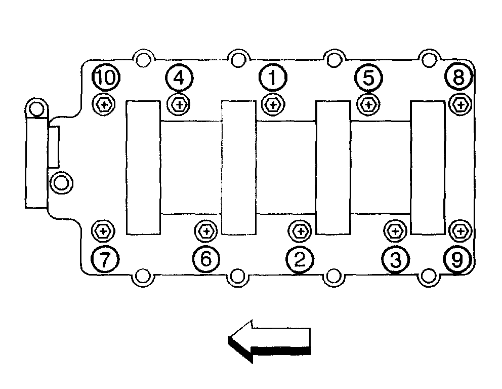

Intake Manifold Bolt Torque Sequence
pic 13
4. Tighten the intake manifold bolts.
4.1. Tighten the bolts a first pass in sequence to 5 Nm (44 inch lbs.).
4.2. Tighten the bolts a final pass in sequence to 10 Nm (89 inch lbs.).

7. Install the MAP sensor (1) to the intake manifold.

Picture 19
11. Connect the knock sensor harness electrical connector to the intake manifold.
12. Connect the following electrical connectors.
- The MAP sensor (1)

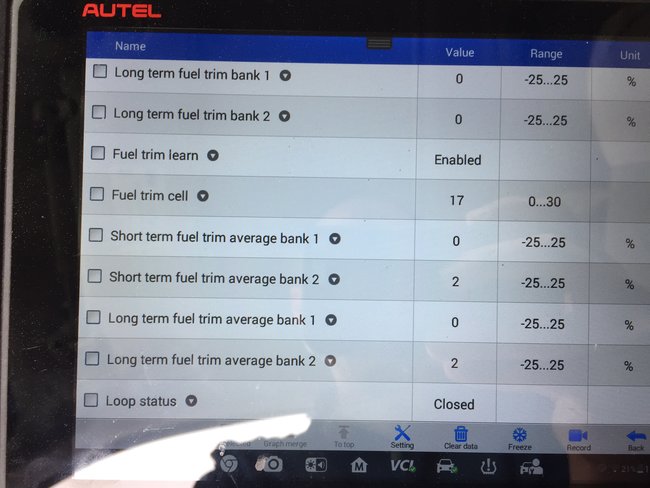

DTHOMP
  • 15 POSTS

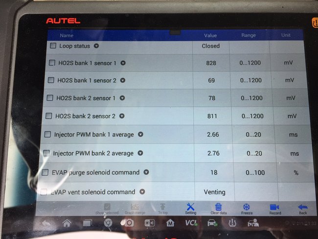

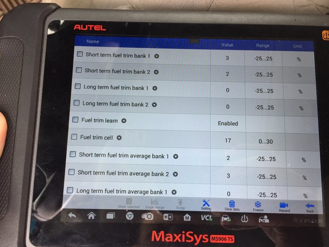

Joe, hopefully you can expand these and get the numbers you asked for. Let me know what catches your attention and if anything looks abnormal.
Thanks,
Doug
Feb 25, 2021 at 3:35 PM (Merged)
  • 110,194 POSTS
Hi Doug:
The fuel trims indicate the engine is running too rich, as you expected. The negative 25 means the computer is trying to limit the amount of time the injectors are open to lean the fuel getting to the engine. With that, I can't remember if you checked fuel pressure and the regulator or have done anything specific to the injectors. The trims should be close to 0.

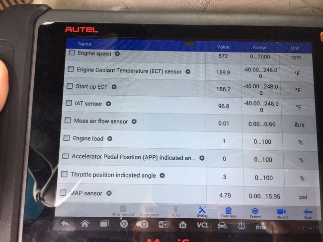

DTHOMP
  • 15 POSTS
I have not checked fuel pressure or regulator. the only thing done with the injectors was replace the o-rings when I replaced the gaskets last week.
Did you notice the ECT (engine coolant temperature) was 159.8? It rarely gets above 187-190. it used to stay at 210 (the 12 o’clock position) within minutes after starting. So I believe something is preventing the temp to get to the right level. this is the second replacement thermostat. I doubt two thermostats could get stuck open causing it to run lean just by chance. Can you think of what might be causing that?

Wow. Those are both good parts. Could the fan clutch be locked and running full all the time?
DTHOMP
  • 15 POSTS
I manually checked the fan.. it does not spin freely, nor does it run constantly. It moves if I move it, which I believe is normal. I'm in a holding pattern at the moment, my next step will be testing and/or replacing the engine coolant temperature sensor. The temperature still rests at about 187 when it should be at 210. Very rarely reaches 210. Thanks again for your ongoing help. I will submit an update once I get a chance to spend more time (and money) with this.

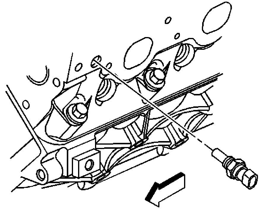

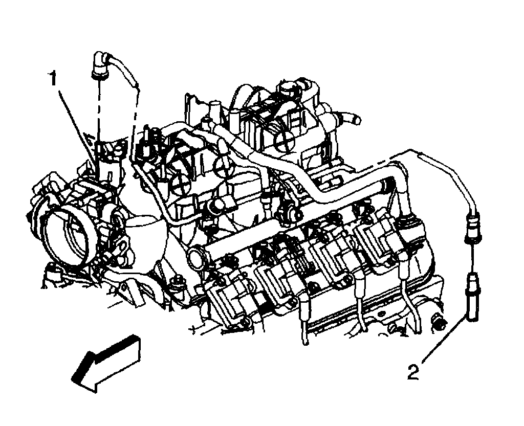

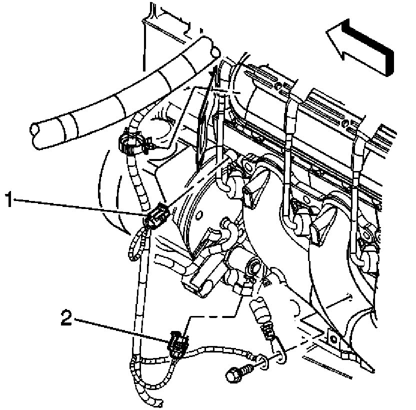

  • 110,194 POSTS
Welcome back:
I have been stuck in Cleveland for the past week, and interestingly, I thought of your post last night. LOL I was wondering what you found. As far as engine temp, it should be between 195°F to 210°F. You are not too far off, but who knows. It may be enough to make a difference.
Here is some info you may find helpful. The attached pictures correlate with the directions. The link is a general description.
https://www.2carpros.com/articles/coolant-temperature-sensor-cts-replacement
ENGINE COOLANT TEMPERATURE (ECT) SENSOR REPLACEMENT
REMOVAL PROCEDURE
NOTE: Use care when handling the coolant sensor. Damage to the coolant sensor will affect the operation of the fuel control system.
picture 1
1. Drain the cooling system to a level below the engine cooling temperature (ECT) sensor. Refer to Draining and Filling Cooling System in Cooling System.
2. Disconnect the ECT sensor electrical connector (1).
picture 2
3. Remove the ECT sensor.
NOTE: Replacement components must be the correct part number for the application. Components requiring the use of the thread locking compound, lubricants, corrosion inhibitors, or sealants are identified in the service procedure. Some replacement components may come with these coatings already applied. Do not use these coatings on components unless specified. These coatings can affect the final torque, which may affect the operation of the component. Use the correct torque specification when installing components in order to avoid damage.
picture 3
1. If installing the old sensor, coat the threads with sealant GM P/N 12346004 (Canadian P/N 10953480) or equivalent.
NOTE: Refer to Fastener Notice in Service Precautions See: Powertrain Management > Vehicle Damage Warnings > Fastener Notice.
2. Install the ECT sensor.
Tighten
Tighten the sensor to .........................................20 N.m (15 lb ft).
picture 4
3. Connect the ECT sensor electrical connector (1).
4. Refill the cooling. Refer to Draining and Filling Cooling System in Cooling System.
Let me know what you find out.
