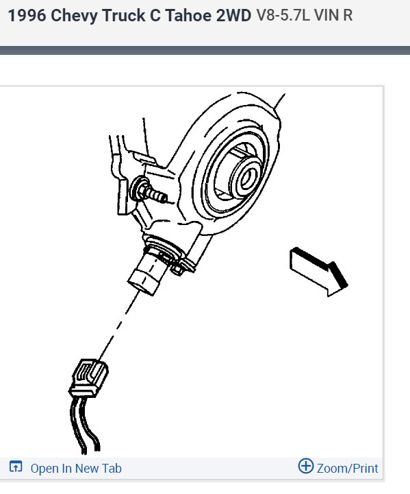

96 tahoe, after a freeze outside, will not start, after cranking it, the battery gives out(fairly new). Try to jump it, and it takes a charge, but in the process of cranking, lets loose a loud pop, and will not start. I do not know where to start, any help would be appreciated.

Check to see if it has spark, and gas, I havent seen it in a while, but frozen gas lines used to be a problem...How cold is it out were you are?

I have seen the crankshaft angle sensor cause this problem here is the location of the sensor so you can swap it out. Check out the images (below). Let us know how it goes
